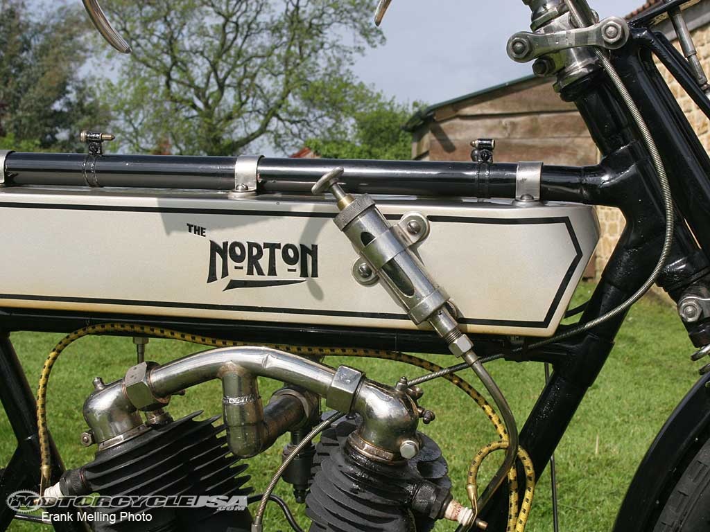

    Perhaps Mr Spalding thinks you should take the rocker covers of and oil the cams before start up , or have a manual prime pump
    ( see latest ducati corse accessory attached)
