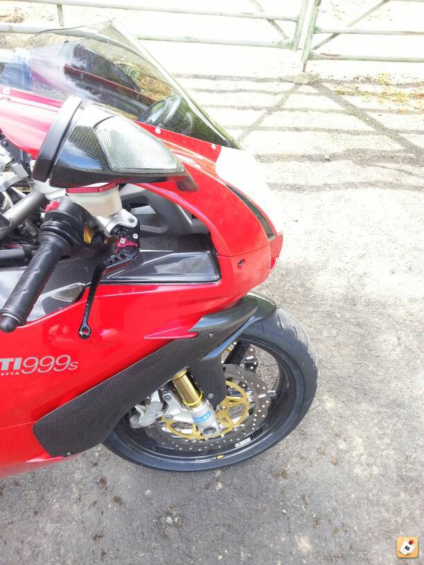

  8. Yep the problem could be same for all carbon wheels.However Dymag assure me this is the first one they have seen so could be a one off.The fact they have issued a safety alert to me means they are not 100% sure so er on side of caution and get em all checked before anyone gets hurt.They have not had a problem with hub area in any of there other carbon wheels in there range.Only the single sided one.
    Any of you BST owners know about hub construction of your wheels.Dymag state they use magnesium hubs where as BST use ally.
    For me the reason I like the Dymags is I think the design looks the dogs danglies on 916 or 999 bikesand are UK based company if any problems occur.Might take a drive down there and check there set up out .
    Also interested in chatting to them about there modification of how it irradicates this hub failure problem.
