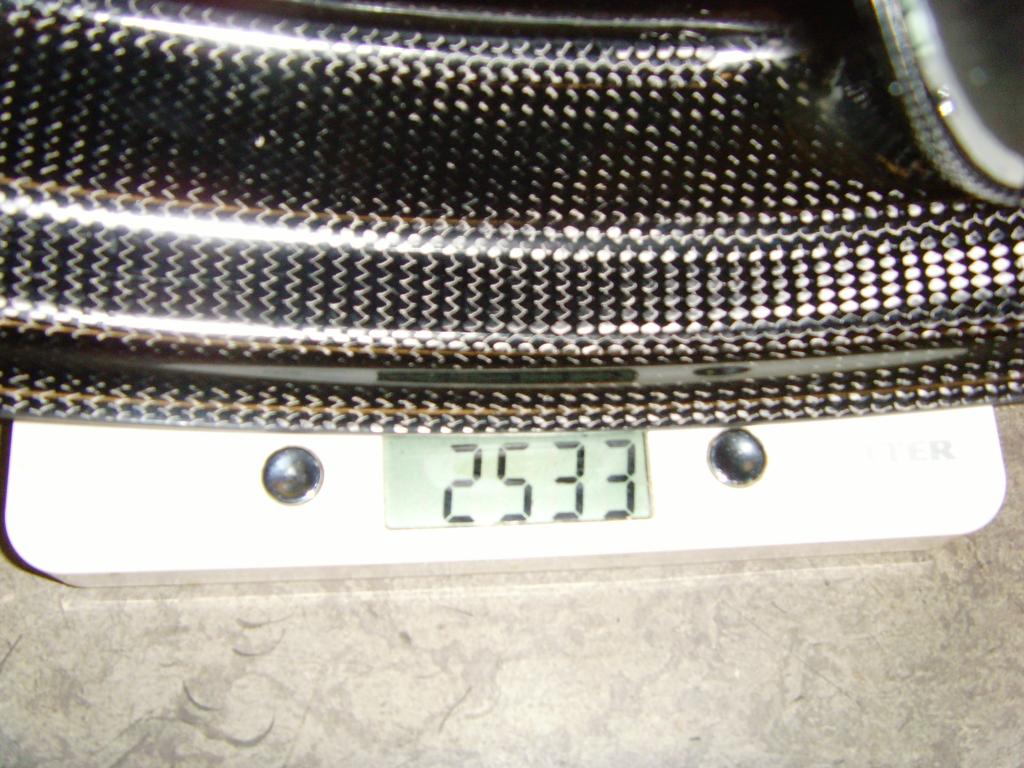

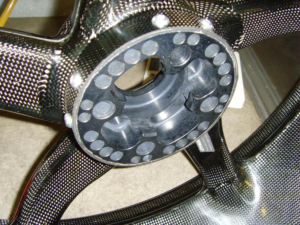

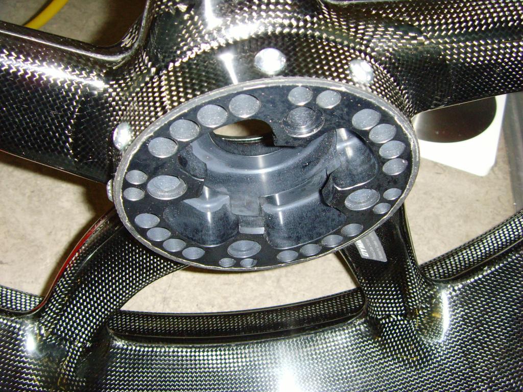

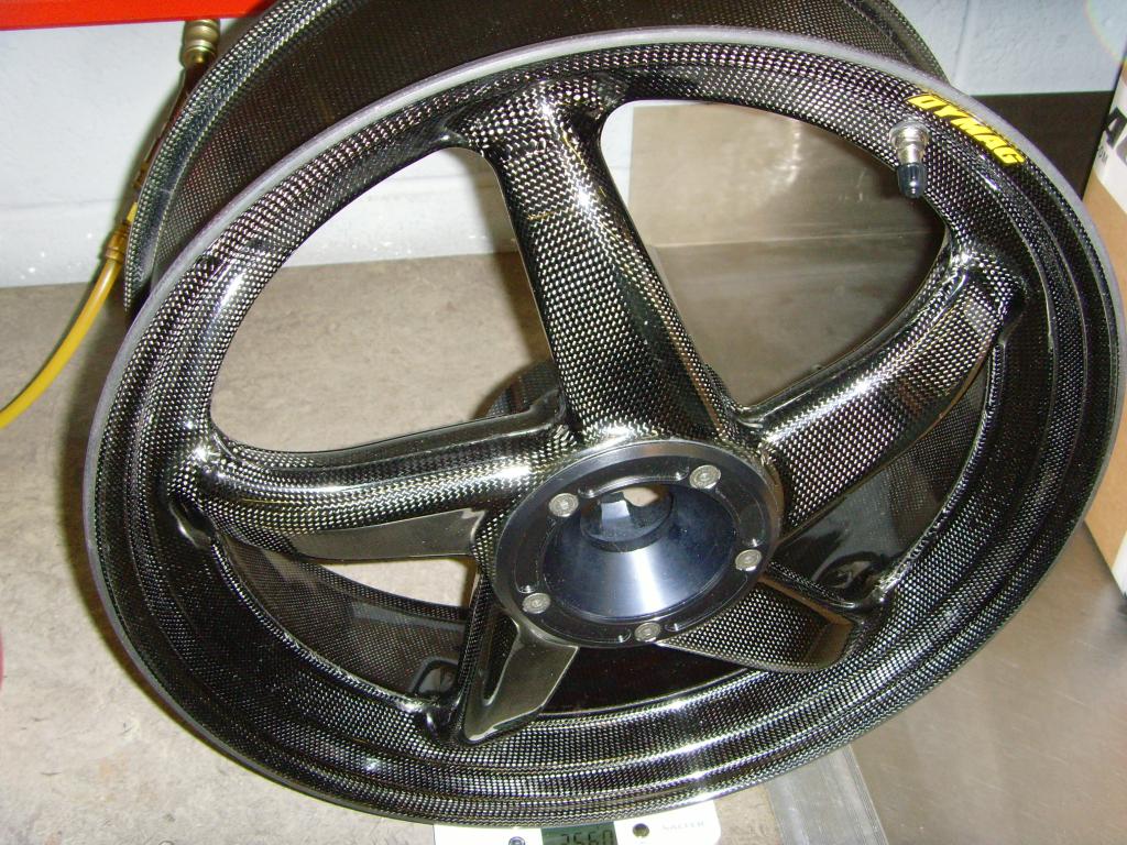

    Very happy with Dymag CSA service I have received following problem with previous rear wheel.Took a little longer than I first expected but then they have been running several long term tests on these new design CA5 carbon single sided rear wheels.
    Rear wheel now has new design alloy hub.
    New bonding supplier
    Addition of bolts into hub
    Judging by the scales they seem even lighter weight than old type
    Please see pics and cant wait to get them fitted along with my carbon fuel tank at JHP so my bike will be back to its old very raw razor sharp handling self again.

  9. I hope the torque is not being transferred by the eight radial M6(?) cap head screws alone from the chunky alloy hub into the very thin CFRP wheel flange...(2nd and 3rd pictures)
  10. Not sure on that one RickyX but noticed Rotobox and BST use similar bolts into hub area for there carbon bike wheels also.Lets see how they hold up but I was thinking the bolts were just a fail safe or something so problem I had with older wheel would not occur again.

  12. Ricky im hoping the bonding does what its supposed to do this time.If you spot anything you don't like the look of then by all means post it up as im no expert.Its this new bolt application Dymag has stated stops the problem I had.
    By the way had a read through the care,serial number and warranty card that came with new Dymag wheels and spotted this.Im sure warranty used to be two yrs and now only 12 months.
