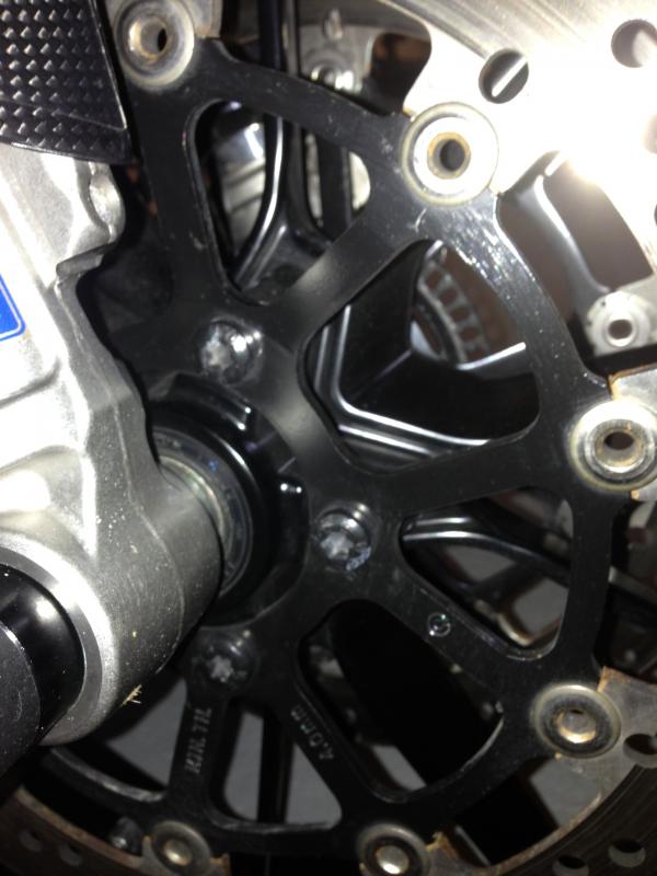

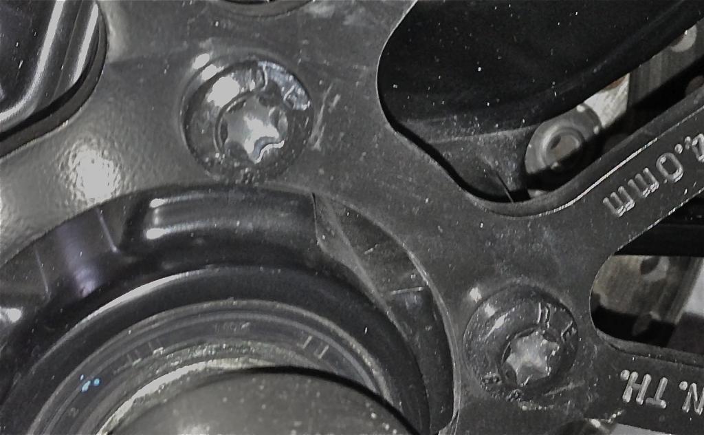

  2. My mate managed to get out my bolts today but when we looked at his bolts on his pikes peak they have used a different bolt,
    they were definitely bigger and took a T45 bit which seemed much better
  3. A 2013 PP David?
    See my previous comments ;-)
  4. No Andy, his is on a 61 plate, got it Jan 2012....
  5. Interesting......as far as I knew most/all 'modern' Ducatis use the same disc bolts and it seems unlikely that the PP alone would be different so if there has been a change at some point I'd expect that to be across the full MTS12 range at least. Maybe you and your mate can have a closer look some time......and anyone else with a post 61 plate MTS12 ;-)
  6. Its my bike he is talking about ive tried to take some shots of the bolts but havent got the old ones from nightriders to compare them to but they are defo different size and torx head .
    as you can see they are not a dome head bolt and they have a deeper torx insert they seem much better bolt ,i have not had these changed these are standard with the bike IMG_1275.jpg IMG_1274.jpg

  7. I've just had a quick look in the garage while I was having a pre-work smoke and mine are exactly the same as the photo. That's on a 2012 ABS model.
    The only tip I can give for removing them is to use a gas soldering iron with the fine 'burner' type nozzle on it to put heat directly into the centre of the bolt and get it hot enough to kill the Loctite then let it cool down again and it should come out. You'll know when the Loctite is cooked because you'll see a small amount of smoke coming from the edge of the bolt.
    Heating the wheel isn't really a good idea because the alloy will expand in the direction it finds easiest which will mean that the holes will become smaller until the whole wheel is hot and everything has expanded.
