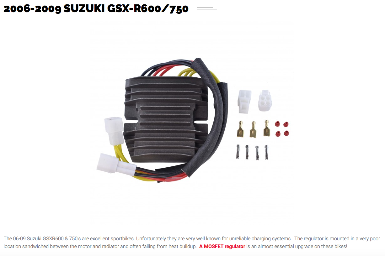

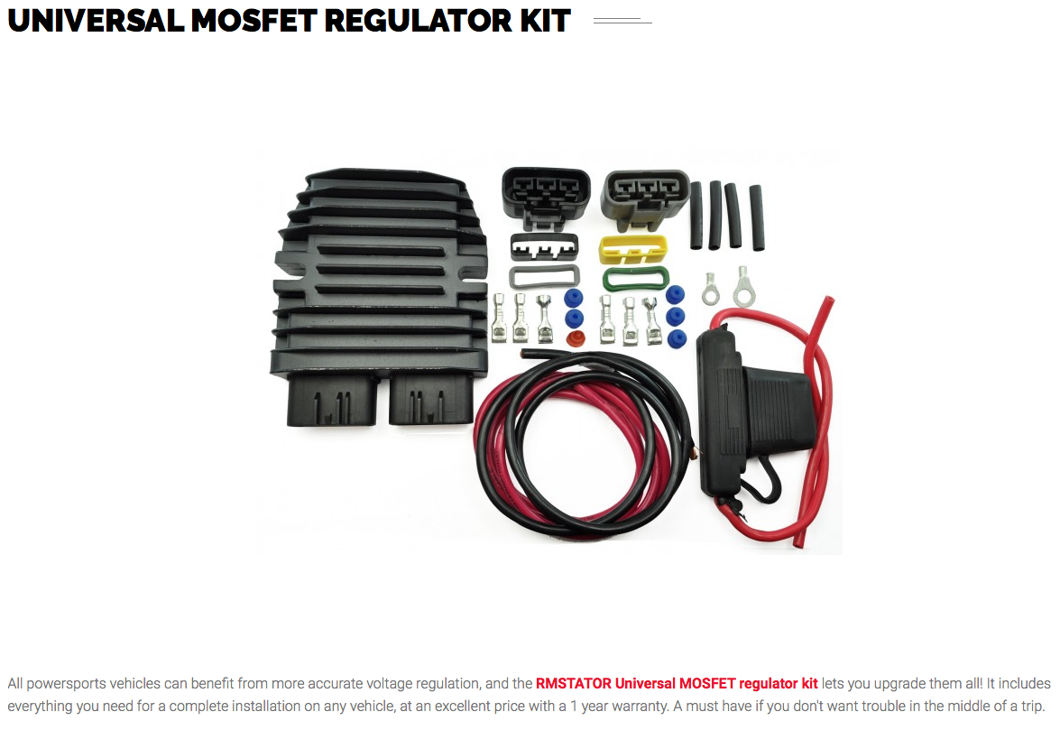

  9. 1) Universal Mosfet for AHY vehicle
    2) Mosfet upgrade listed for a GSXR particularly to sort out their "unreliable charge systems"
    Screen Shot 2019-02-05 at 17.43.32.png Screen Shot 2019-02-05 at 17.44.20.png
