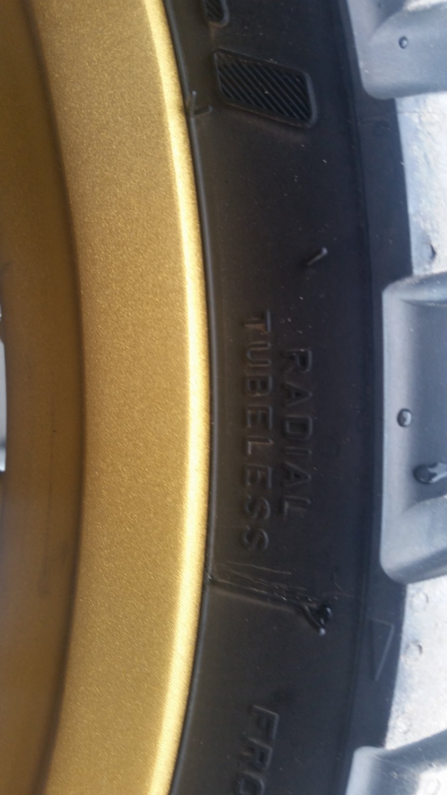

  1. I think El Tel's point is that even though his scrambler is fitted with tubeless tyres, they still install a tube. Seems mental to me
  2. Yes they do sometimes fit tubes to bikes with spoked wheels and tubeless tyres , to be honest with a spoked wheels I'd rather have a tube for this exact reason , it's not a new problem
  3. What's your point @Peter turner ? When a tyre manufacturer writes the word "tubeless" on the wall of a tyre, that means the tyre is capable of being run without a tube. It does not stop anybody fitting a tube inside it.
  4. So have you found out yet - the thread below re a Desert Sled says tubes are fitted - if your evidence is the writing on the Tyres then this was mentioned earlier as being irrelevant - would be interesting to know :)

      Irrelevant if they are fitted to rims that require tubes. They are made tubless so Pirelli can sell them to a wider range of ADV bike owners than the relatively small number who have tube tyres these days.
