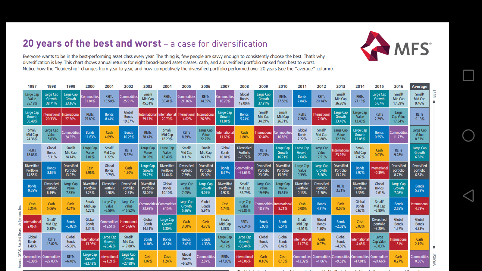

    and even higher here: Screenshot_20171013-225558.png

  15. I have no need to ask of anything, I'm merely making an observation: There are in fact many funds with the potential to occasionally achieve returns in excess of 25%, but not annualised over the lifespan of the fund. Inherent with the potential for high return is of course downside risk thus in order for one to invest with a target return in of 25% (net? annualised?), assuming no leverage, one would have to accept a risk/reward ratio of 1:4 on every single trade over the lifespan of the fund. Therefore 12.5% of the funds assets would need to be 'risked' at each trade and the fund manager would have to be absolutely right 25% of the time or if wrong, on the next trade have to double the stake (leverage)in order to recoup etc. The fund would have the potential within four unleveraged trades to lose its entire equity which is just not feasible and no fund outlining such high stakes in its prospectus would attract any investment, public, private offering or otherwise, blah blah blah etc etc!
    The tradeoff when posting on a public forum is of course that you are inviting observers to read the posts in order for them to ascertain whether they are worthy of the time/trust!
