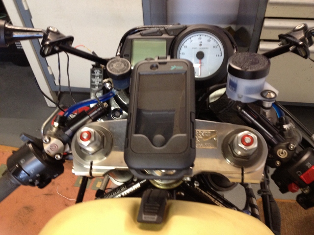

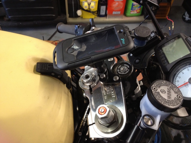

    Well hopefully sorted me cam timing out and dialled them in at 114 degree centre line, bike seems as strong as before and ticks over :upyeah: Only been for a short blast as me blasted knee was playing up. Will know on thursday as upto Chris at CJS for a re-map.
    Well got meself up to speed with a new I phone thingy and purchased a ultimate add-ons case and bracket (Modified a little to fit) so will also test that on the way to Chris's and see if the GPS is any good?

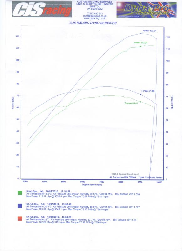

    Just got back from CJS, had the old girl re-mapped properly. Oh my! Previously the bike made 115Bhp 77lb of torque..............now she is kicking out 123Bhp!!!!!! 78lb of torque. Impressive figures for an old Superlight but that's not half the story, bike is far more tractable and smoother. Top job by Chris Steadman, well recommended! Will stick up the dyno once Chris can E-mail it on.
    CJS RACING Ducati Cylinder Heads Tuning Gas Flow Dyno ECU Custom Mapping Bristol Bath
  18. Howdo!
    Just the scanned chart for now.
