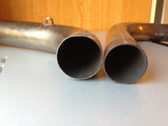

    Didn't stick a pic of Mark Hill's handy work on the exhaust (Top bloke who did a superb job) but here's a pic just to show the difference in exhaust bore compared to the standard SS.

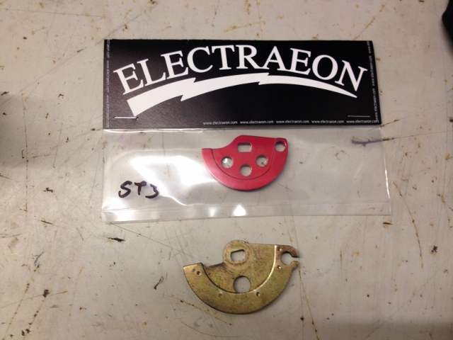

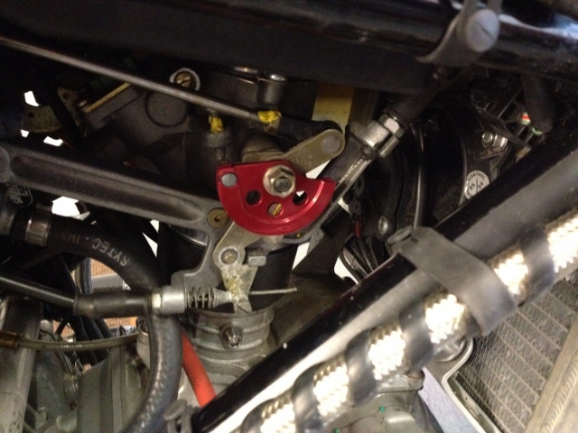

    Also got this through the post today - alloy throttle cam wheel (Acts similar to a QA throttle, took about 10mm out the throttle rotation. Just need to see what difference it's made on the road.
