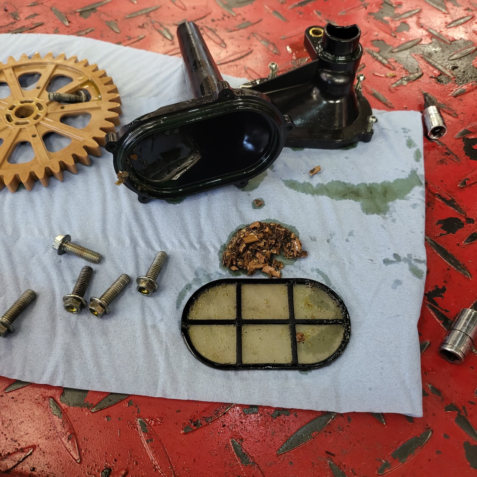

  10. I took the pipe off as you can't really get the cover on and off with it fitted. Seen to remember taking off the RH side footrest etc, obviously the fairing and the wiring location at the top of the fairing. It is pretty logical what you need off, especially if you are taking your time.
    I posted this before but this is what I found in the second engine which was running quite happily. Engines get noisy with the steel gears..
    • WTF WTF x 1
  11. Thanks! That's some mashed plastic there!

  12. Looking at images of the various gears, the R versions *may* be metal. But more expensive. And probably on a long order from Italy.
  13. Methinks I shall wait until I disassemble things, then check the gears (if they’re metal) for wear before blowing hundreds on replacements.
