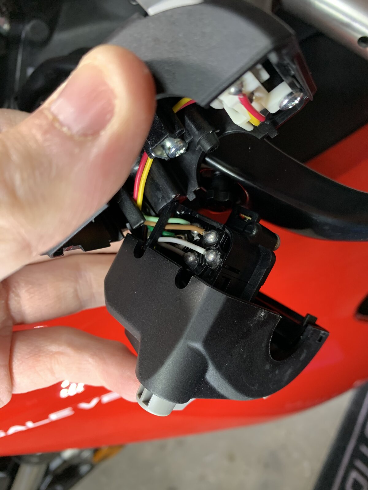

  2. Do u know if the switchgear remains live in any capacity when the ignition is off? Just wondering how water could affect it when switched off. I won’t get into the can bus, I don’t want to mess that much but wondered about the switches
  3. If you remove the battery, then no it won't be live or at least you can be assured it won't be. If water has seeped into the housing, regardless of whether the ignition is on or off, it will eventually lead to corrosion and/or connectivity issues. If power remains applied to it with the ignition off, then there is the risk of a short/arcing, but that scenario ought to be mitigated by your fuse box. How problems manifest themselves depends largely on the severity and location of any damage. As I mentioned, buy some dialectric grease and coat all the terminals and any connectors inside with it. Since the front indicators are fed from the instrument panel's integral ECU, and as Nelly pointed out, any issues emanating from there are likely to reside on the circuit board inside or at the point of connection with the loom. You could check the latter for any moisture/water ingress but if the instrument panel is internally compromised, there is not much practically you can do, other than replace it under warranty, assuming a dealer can confirm that is where the problem lies after diagnostic checks.
  4. yeah, my fear is that it’s a dash replacement as that perhaps would tie in with the date and time deciding to go missing perhaps, it may well be a problem that gets worse and worse. I’ll get some grease and check the left switchgear, I’ve been spraying a bit of contact cleaner in there.

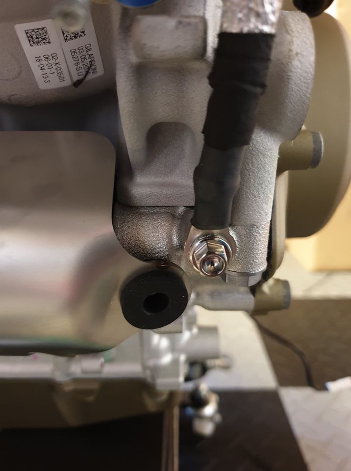

  6. The battery condition is often overlooked when self-diagnosing electronic issues, where components require nominal voltages to work. I don't profess to know what those are (Nelly is far better equipped to answer that question than me) but have you tried hooking the bike up to a similarly rated battery, to rule out that option? Just make sure the battery you test with if you can borrow one, is suitable for your bike in terms of voltage/amperage supplied (ie V4S requires a LiPo4 battery rated at 12.8V - 4Ah. It also needs to be charged at a specific rate with a dedicated charger). It is interesting to note you lost date and time, at some point, as that might suggest a loss or an interruption of power to the ECU in the dash for an extended period (unless you disconnected the battery yourself). There is also an earthing point on the loom that you might want to check. It's located on the front of the engine casing behind the radiator, inboard of the frame.

  8. Agreed, let's keep the detail about how it should be wired in off here, but just to say that I have 3 sets of wires coming off the battery, I have the charger fly lead, I then have two braid covered positives and earth leads. The bike track is installed by the dealer/Ducati as it was bought new with it, and I know where the earth strap is for the 959/V2 engine but it's behind the battery so would need to disconnect it which I haven't done yet.

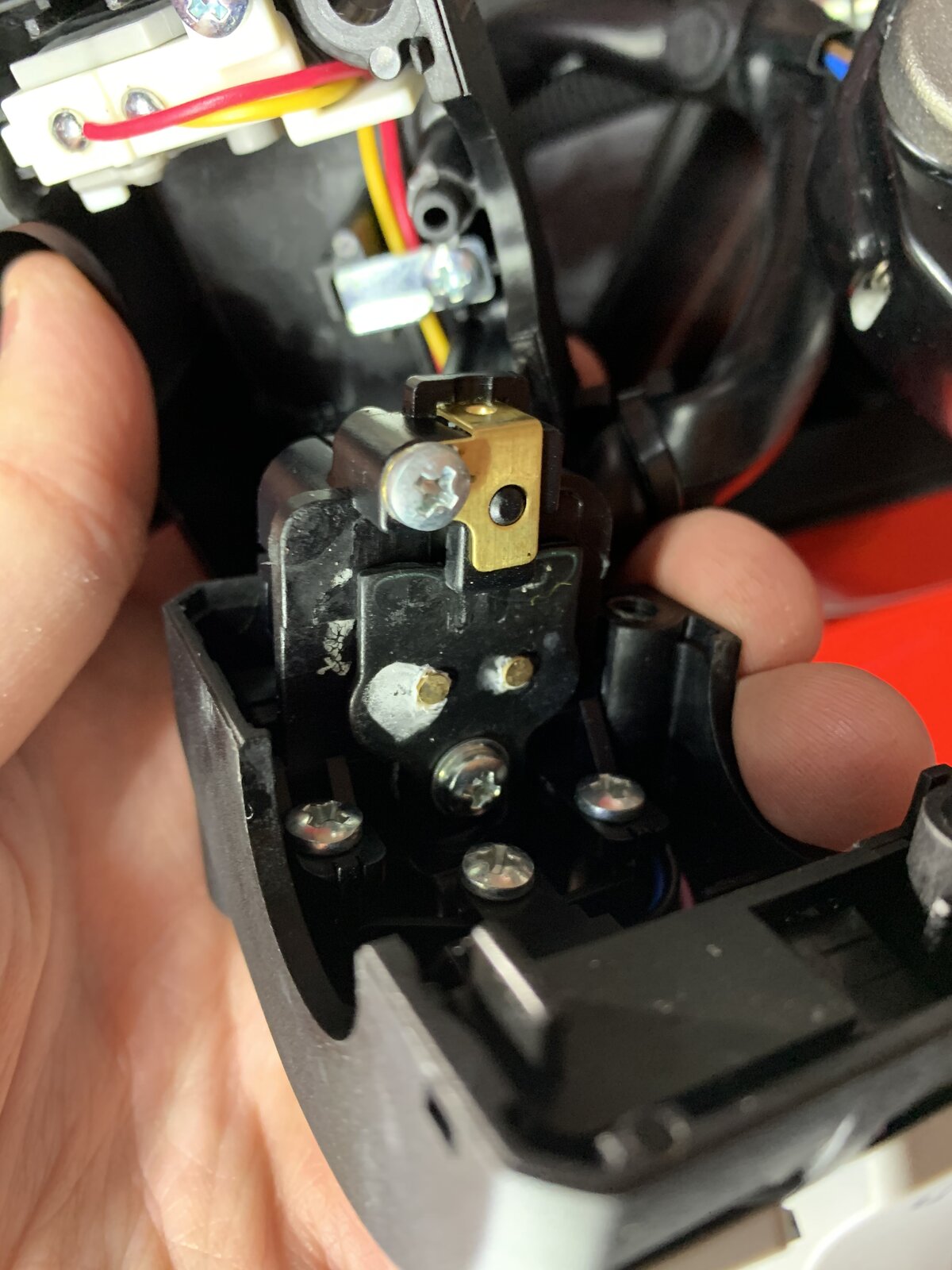

  10. agreed, I did the last obvious thing today, took the left hand switch gear apart and it looks fine to my untrained eye, actually I’m impressed how solid it all is..

  13. Switchgear looks OK, nothing obvious as you say. The plot thickens.
