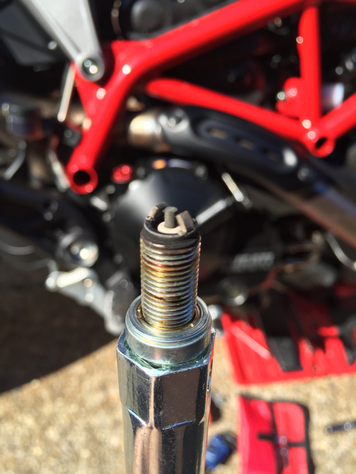

  3. Horizontal plug out
  4. i don't see that is going to help to determine anything. it's not playing up on tickover and i'm not going to attempt to ride it on one cylinder
