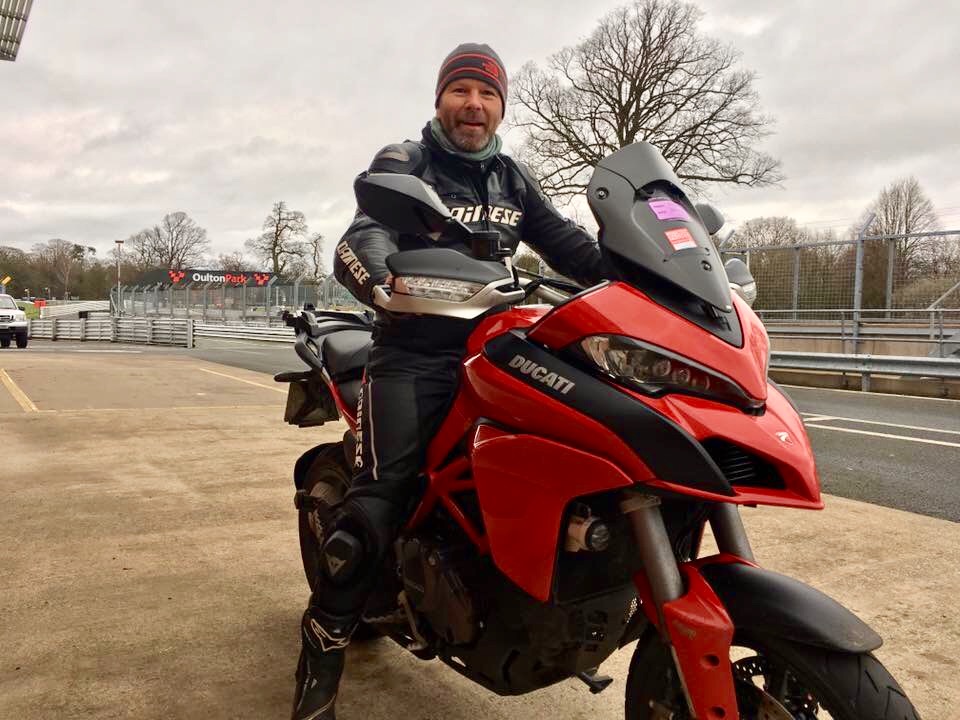

  4. Conquest carbon sports screen, its small but perfectly formed, it seems to smooth the air flow better than the original, I'm 5ft 10"

  9. That's looks nice bit like the pp . How's it for noise / touring
  10. Hi Ant, only done a couple of days so far, did a 400 mile round trip a couple of weeks ago and I find it fine, it channels the air over my bonce but when it's cold I feel it on my shoulders. I wear earplugs when solo and a Shuberth C3 Pro with the missus so noise has never been an issue to be honest. I prefer the look of it to others so am prepared to put up with the little failings a "proper" touring screen would offer and then I've always got the car!!

  12. Nigel have you got a part number for that screen -can't see it on their website
    Thx
  13. I couldn't find it either, contact conquest via this forum, you'll get some discount and ask em directly what the part no is?
  14. Hi Nigel,
    Is that carbon screen a direct fitment or did you need additional screws/spacers?
    Stoob
  15. It looks exactly the same as the original Ducati Pikes Peak one I have?
    If it is a Pikes Peak it comes with different sized screws in the box
  16. Hi stoob, direct fitment, however, it didn't come with fixing screws. I got my own Allen head bolts and used the original rubber bungs from the touring screen as "buffers" behind the screen
  17. Thanks Nigel!
    Stoob
  18. That one looks really with the duc original...
    I'm looking for one because the original at the summer cut the wind and is very hot in my leather jacket!!
    "Nigel Machin"
    What did you mean with "it channels the air over my bonce"? What is bonce?
    I'm 5'9" - 1,74m
  19. Sorry AV colloquialism for head, I generally keep the screen adjustment on the lower settings and the wind is deflected over my helmet, just catch some on my shoulders, I'm 5ft 10"
