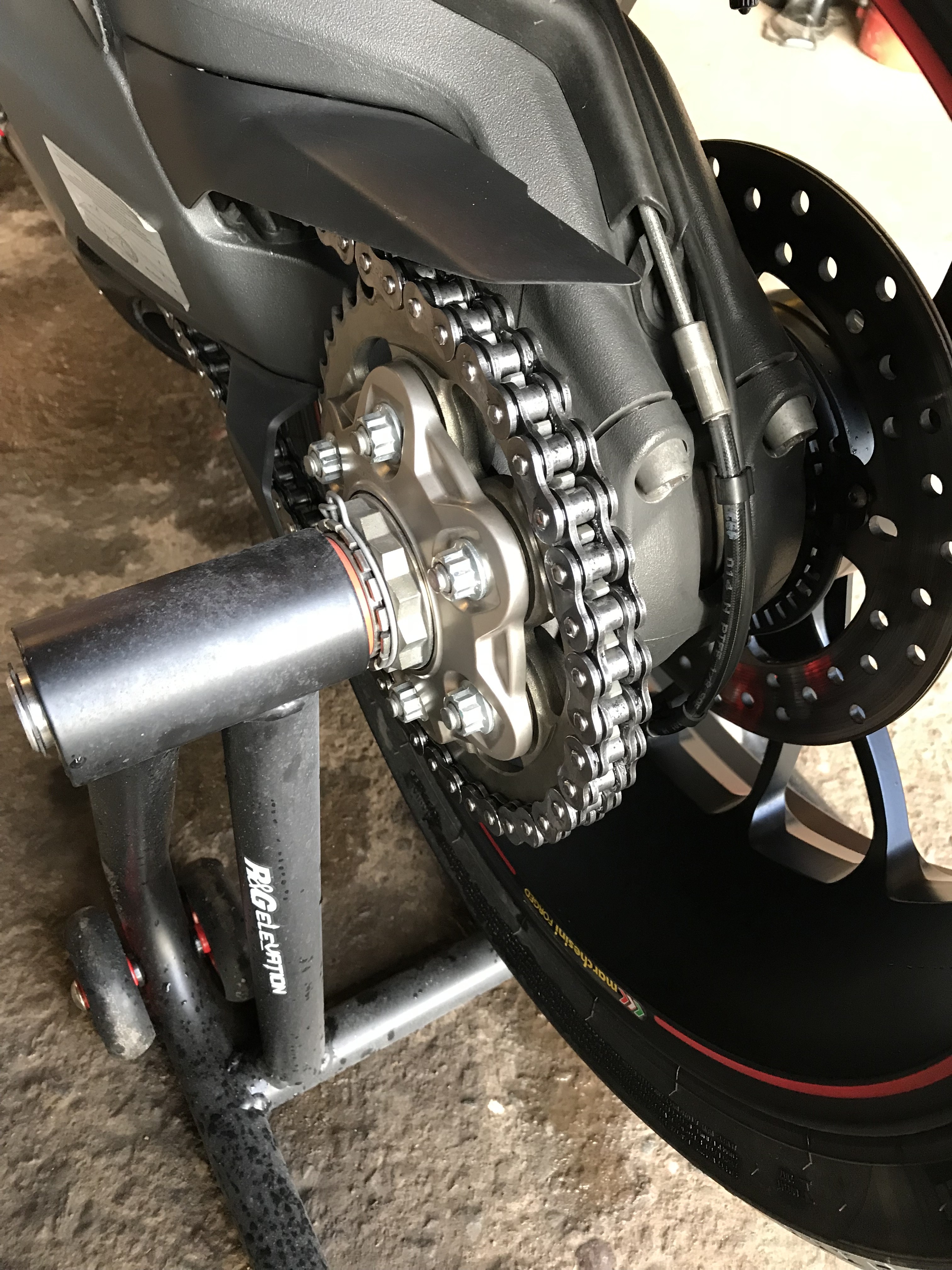

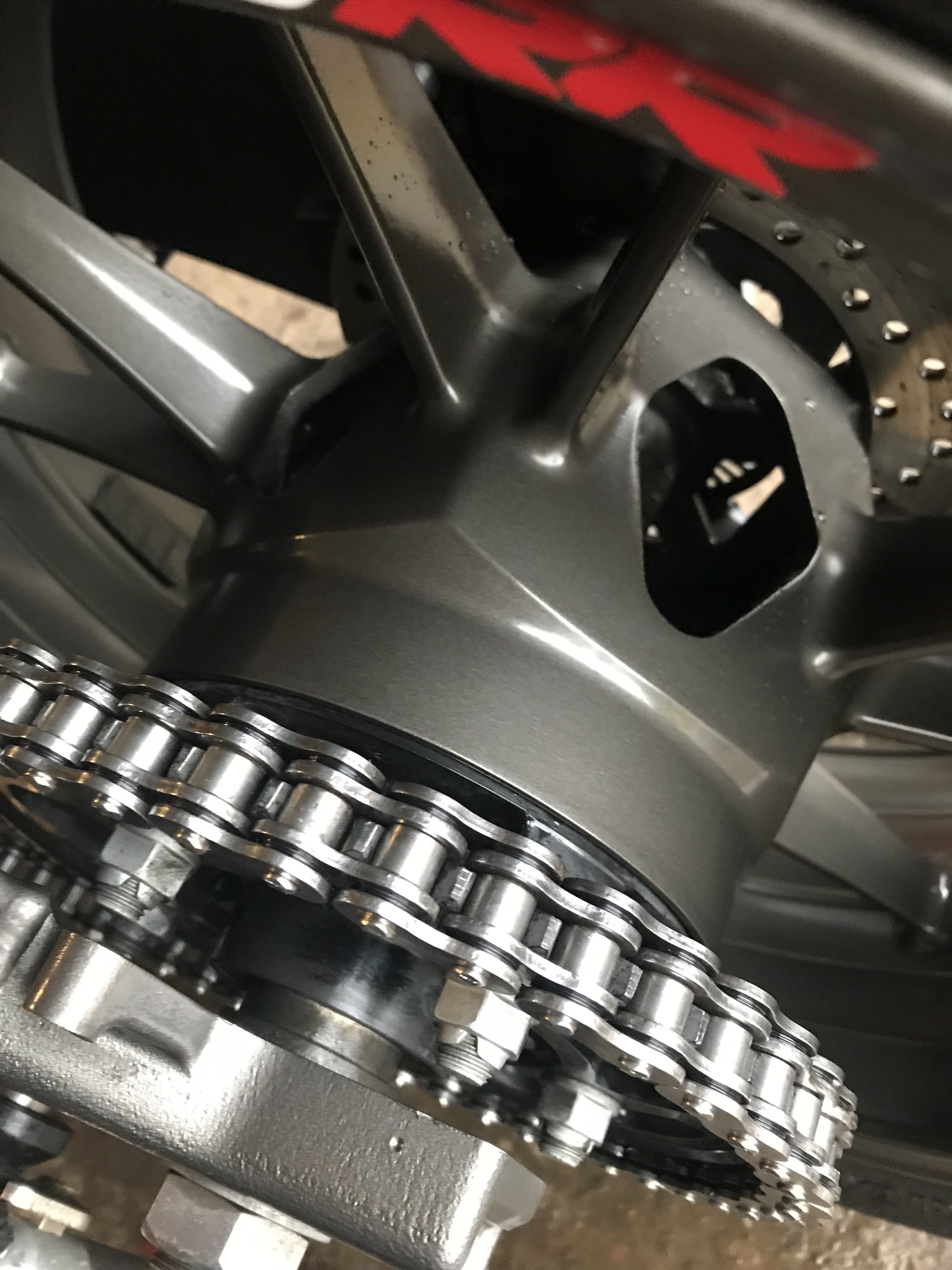

  3. I use Motul C1&2 (iirc) for degreasing the chain and lubricating it. I have other degreasers there as back up if I’m caught short but usually I keep the Motul stocked.
    A few pics of my s1000rr which got the same treatment
