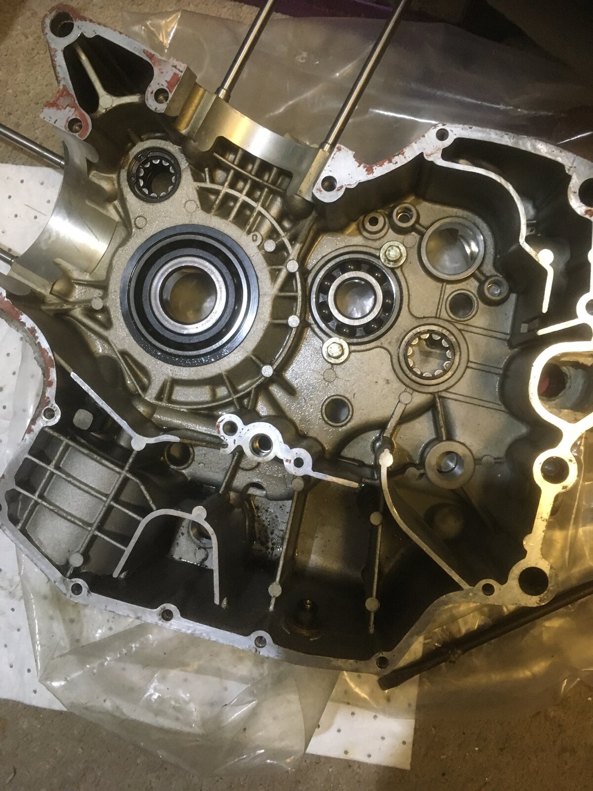

  4. Hi
    Mine was a 900 and removal of the primary gear was done so I could strip everything out and clean up the cases properly prior to paint. You could probably get away with leaving everything in the right case but I don’t know for sure, for what it is I’d take it all out, don’t forget about oil pressure relief valve, gear selector detent and neutral switch prior to splitting
    Here’s a couple of photos of the main bearings the darker centre part is the ballrace holder
    Keep us posted
  5. Right on, the darker race ball holder is what I had at first mistakenly observed as the inner bearing.

  7. Just a thought if you decide to change the mains for some reason, get them from ducati as the internal angle is different from commercially available bearings

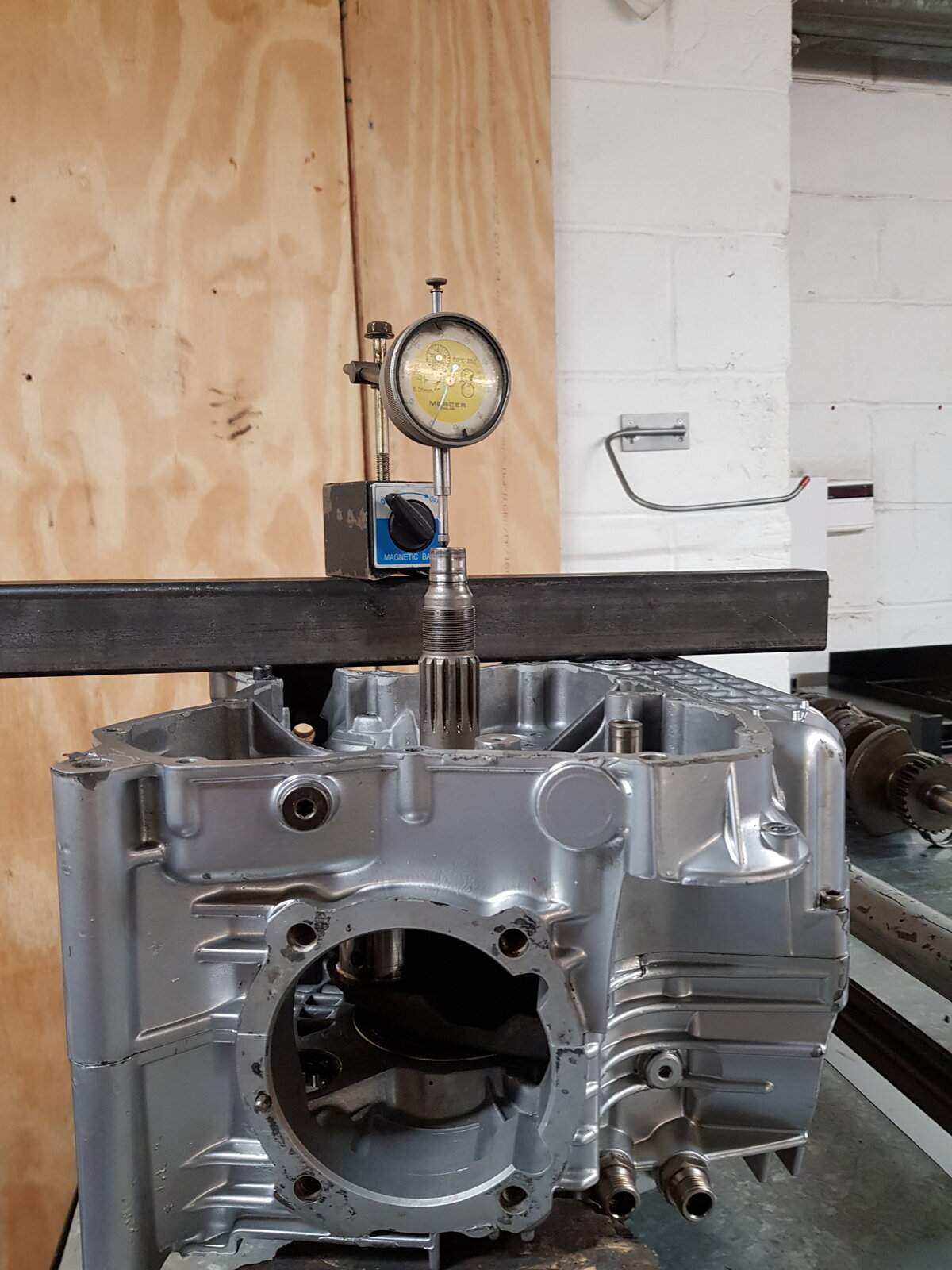

    Preload checking on a 996

  11. In my experience, the mains are the only bearing that are not easily obtained from anywhere, OTHER than Ducati. All the others are easily obtained SKF. If you do decide to replace all the case bearings budget on about 200 quid

    Some Thoughts based upon present observations:
    - Bearings seem good. So do the gear teeth profiles.
    - I notice that idler starter gear has been removed and re-assembled, and so I ask myself why then, if not to split cases?
    - The alternator nut has been off (to fit a 600ss flyheel for sure).
    - Flywheel where reduced in depth, retains a burr; never the practice of one properly taught.
    - At this time, the gallery plug backing out is the main concern.
    [ Note: JE High compression pistons, standard size, lightly honed to suit, and improved black barrel studs are fitted].
    I'm puzzled by the owner fitting such performance mods and not noticing the gallery plug coming out, lets say 10,00 or maybe less miles earlier; odd that it should be backing out now, with as yet minimal wear to it, when I come to it fresh.
    POssibly its use at high comp hastened gallery plug backout, due to increased heat.
    Possibly a new aluminium gallery plug had been fitted, and wasn't locktited in.
    Bearings may have been replaced in its estimated 30,000 miles.
    To DO
    - I may do well to open the big end bearings as a matter of course, to examine them, with new bolts at hand. That is, although they seem nicely fitting and smooth, in order to get a good visual of state of use/wear overall.
    - Examine oil pump for wear.
    - Check crank end float and configure thrust washers for all important pre-load.
    - Refit with new, gallery plug; loctite and peen for fastness.
    - Measure for Squish upon assembly, so configure base gasket thickness to adjust squish.
    - if possible, take burrette reading to gain accurate idea of actual compression.
    - Remove flywheel burr
    - Marvel at the engineering.
