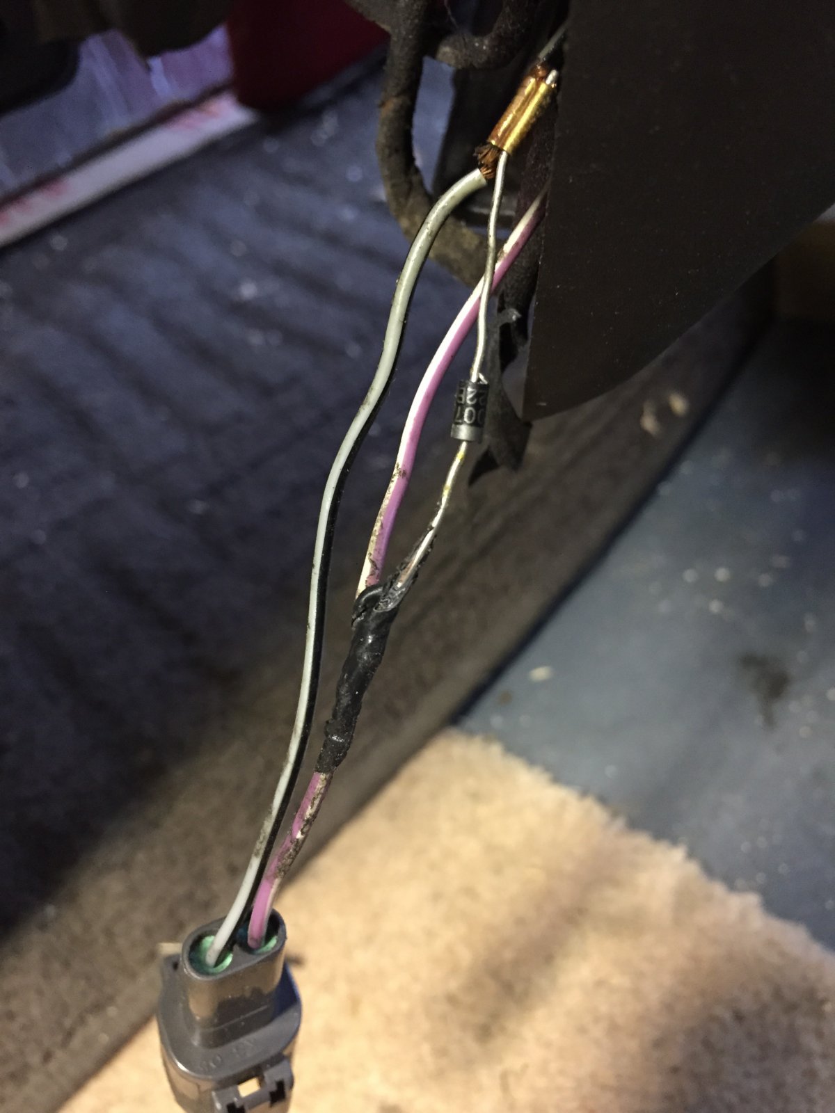

  18. Have made some good progress in sourcing a used ecu. Before I plug it in and try to start the bike should I be worried about damaging the new ecu if say another electrical component was damaged by the reversed polarity?
    Also, I'm trying to locate a diode on the starter solenoid. Can anyone tell me where I should be looking?
    Thanks.
    AL
  19. Found the diode it's on the solenoid cable, bike side. Not easy to find if you don't know where to look. Will soldier new one in at weekend and give the thing a try.. pray for me!! DukeDiode.jpg
