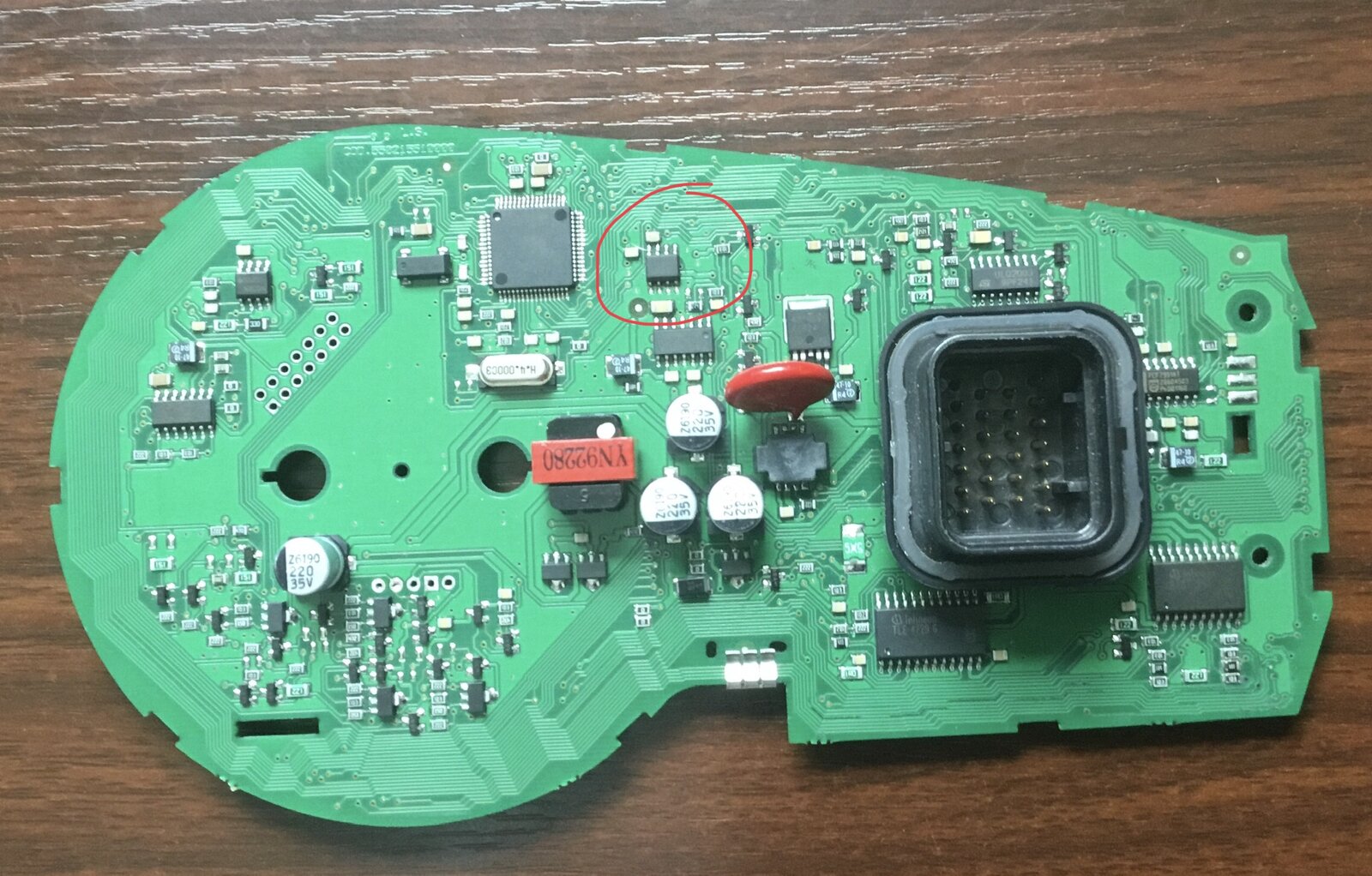

  11. The first photo shows the immo chip on a MS dash circuit board (note the tacho needle motor is removed on the circuit board I have)

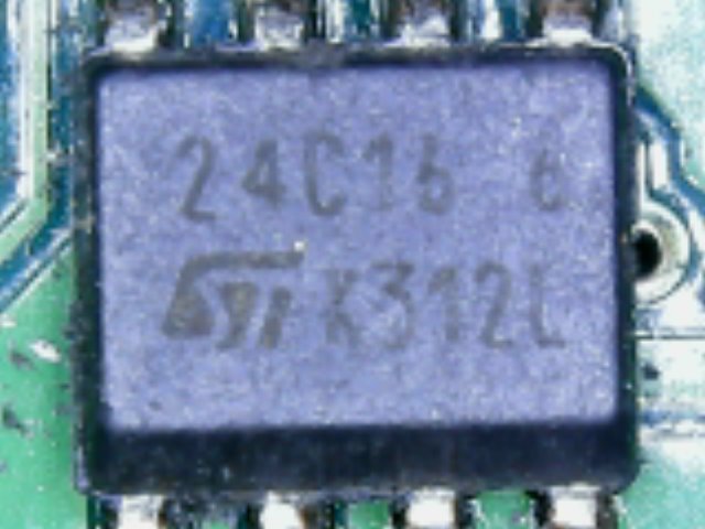

    The next is a close up of the immo chip

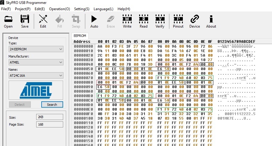

    The last is the data from the immo chip. The red key is the first, followed by the black keys. 81AC2CC1-A962-4C4F-B4CF-F023CA04FFA8.jpeg 5543B5D5-0E8B-4ADA-8206-8EE7CA8D147C.jpeg F74988B3-6573-4615-B1EF-8C432A7E4F15.jpeg
    The red key is the detail - 00 00 01 0E F2 A4
    The black keys are 00 00 01 0E EE 5B and 00 00 0E E6 58
    The bypass code for this particular red key is calculated from the last 5 digits of the above
    E=5
    F=6
    2=2
    A=1
    4=4
    You need to read some of my other posts on how to convert this data for use in transponder programming and how to calculate the bypass code.

  13. I had a dash from a MS1000DS and my post above shows where to connect to the immo chip. I have highlighted the 3 key codes with the first being the red key. The bypass code is calculated from the last five digits of the red key code.
    You use the following to calculate
    1 to 9 are those values
    0=7
    A to F = 1 to 6 (A=1 B=2 etc)
    To calculate the code from an actual red key, you need to read the transponder in it using a Zedbull Mini.
    This will give the hex code for the key. This hex code needs converting to binary. You only need to convert the last six digits. In the above convert 0E F2 A4. Be aware that online calculators ignore a preceding 0. But zero will always be 0000, so you can manually add it. You then reverse the binary (eg if it was 00001011 it becomes 1101000). Then convert the reversed binary to hex and this will give the Tiris conversion. Take the last 5 digits from this to calculate the bypass code.
    Or, send me the reading from the Zedbull and I will do it.
