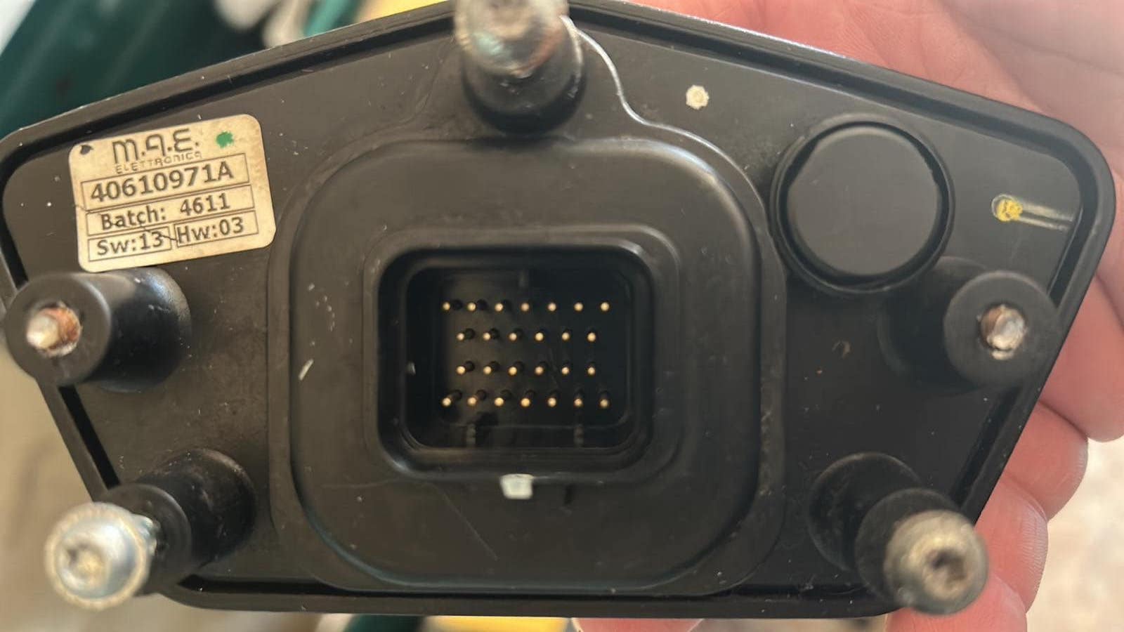

    New here on the forum. I have a Ducati Streetfighter 848 2011 that has a broken dash and found a kit (dashboard, one back key no card, ignition hub etc). I have the original two black keys and the card from my bike and I was thinking of using the key from the new set to reprogram my original two keys in order to keep my original keys, ignition hub, tank hub and passenger seat hub. I know I would need to use my key to open my ignition but wrap it in tin foil and keep the other key from the kit next to it so the antena reads it. But in order to reprogram my two original keys I need to figure out the code from the card. I have friend with a Flipper Zero. Can I use it to access the information from the key and decode the code? Or what other method can I use to read and decode the code in the key from the kit?
    I am thinking of this method so I don't need to buy a new blank back key and find a locksmith to copy it and then to use the sequence in order to program it (although I would still need to read the code from the key because it doesn't come with the card and the code).
    I would highly appreciate some help/insights.
    Thank you very much in advance!
  11. #51 chrisw, Apr 7, 2025

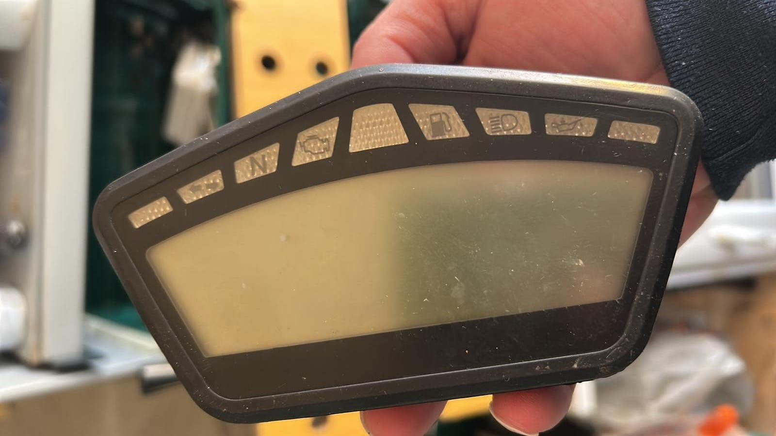

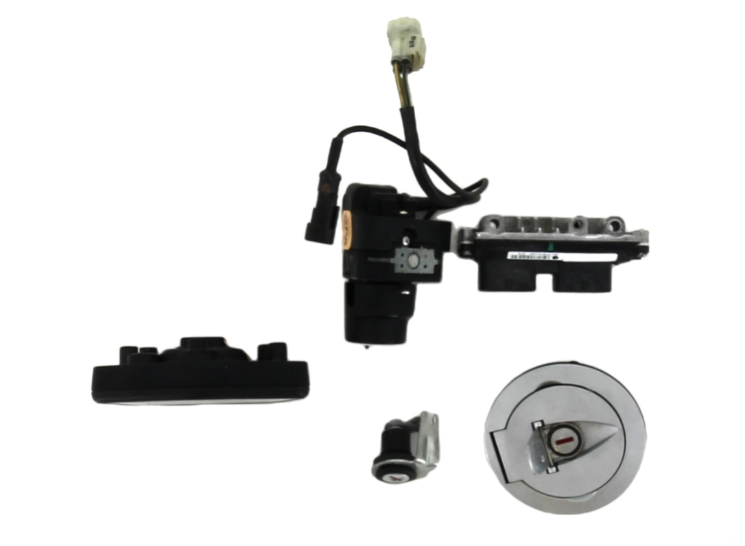

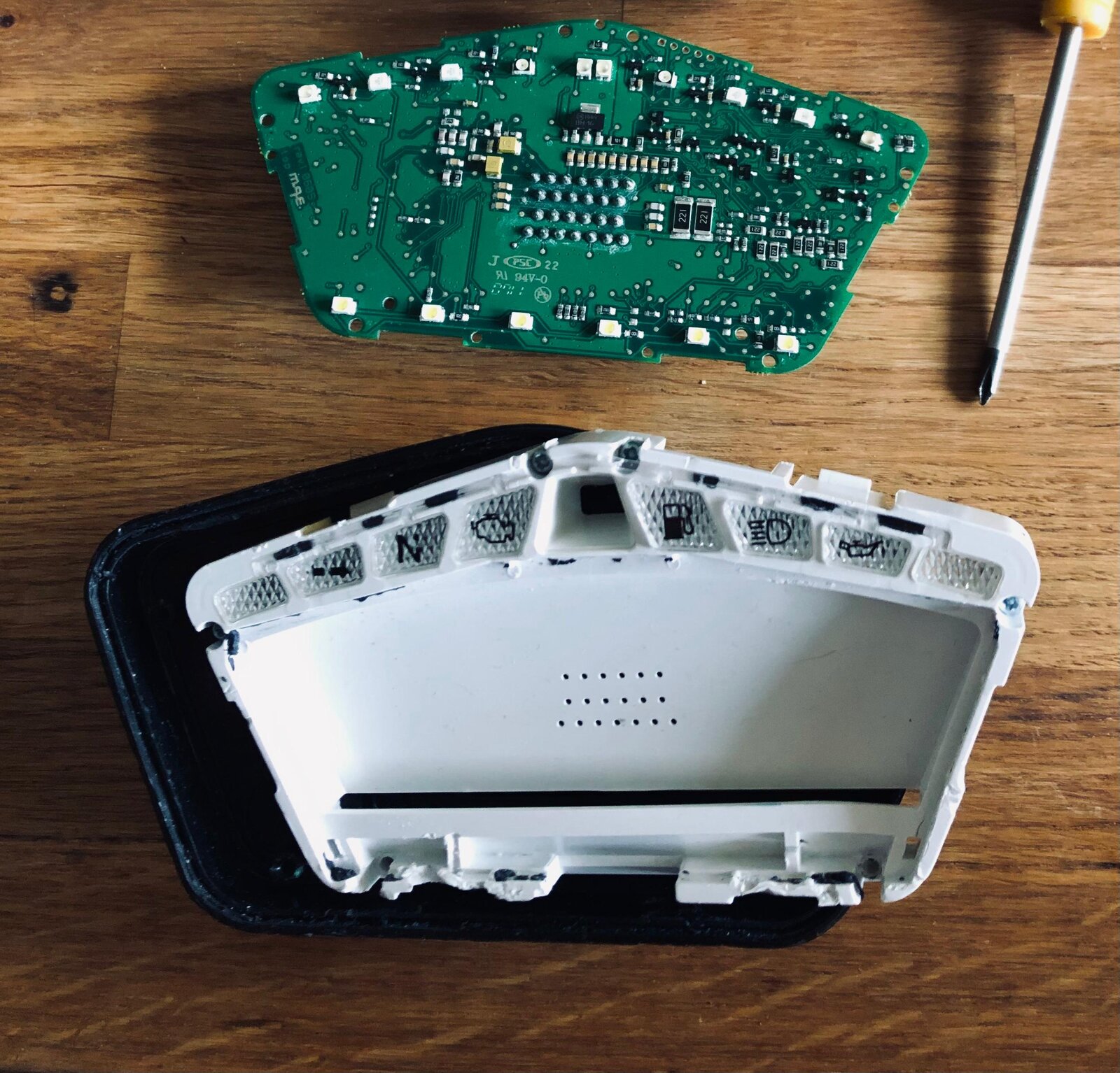

  12. It is the sealed type of dash. Pic 1&2 from a dash I found to buy, Pic 3 is my dash without the display, and Pic 4 is the complete set I found to buy with only one black key and no card (they type with only two black keys).
    Already checked that thread.
    I came to you because it seems you cracked the I2K with two black keys.
    The only thing I want to do is read the code that was on the card but directly from the only key I will have (from the kit that comes with only one key) in order to program my other two original keys, so I don't have to buy a blank key, carve it and then reprogram it (still needing to have the code from the non-existent card). Can you leave me a PM?

  13. Look at post #16 on the Ducati MS site. You need to find someone with a TMPro and then cut the dash as in the image to reveal the programming pins. No point asking me to help because I cannot.
