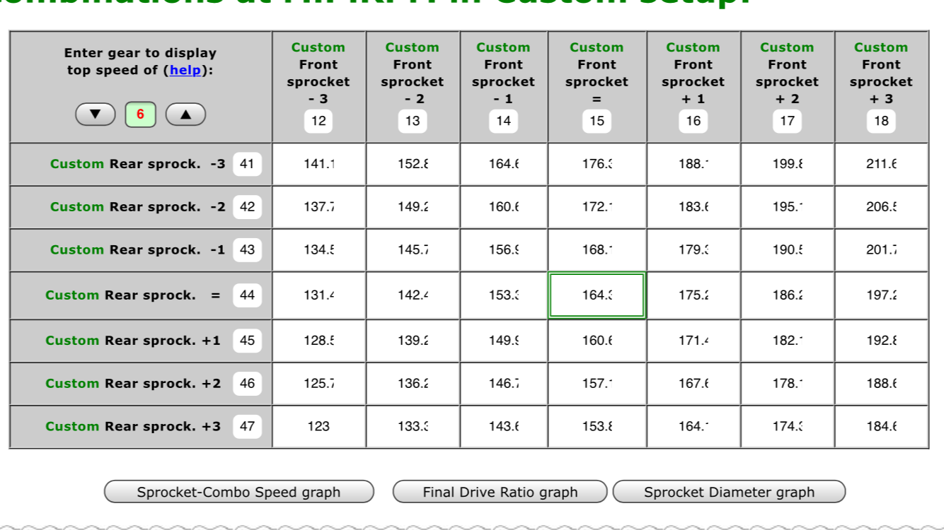

    With regard to gearing, any input on a good rear size for the 899?
  10. You would have to have a play. This chart gives an idea of the theoretical top speed for a number of different combinations:
    As Bradders said, if you went -1 on the front it would lower your top speed to 153ish, which at brands would probably be enough for an 899 on the start/finish straight. I wouldn't want to take it much further than that.
  11. -1 would still enable me to use the same chain as well which would be a result. I do feel it could do with a bit more shove off of corners
  12. I went -1 on the front of my 848 and it gave it a massive boost without losing a massive amount at the top end (who really needs to be going over 160 anyway!). However, I did use a lot more fuel!
    I went +1 on the rear of my 959 which gave it a small boost and barely changed the top end or fuel consumption.
  13. Might go 1 up on the rear for now.
