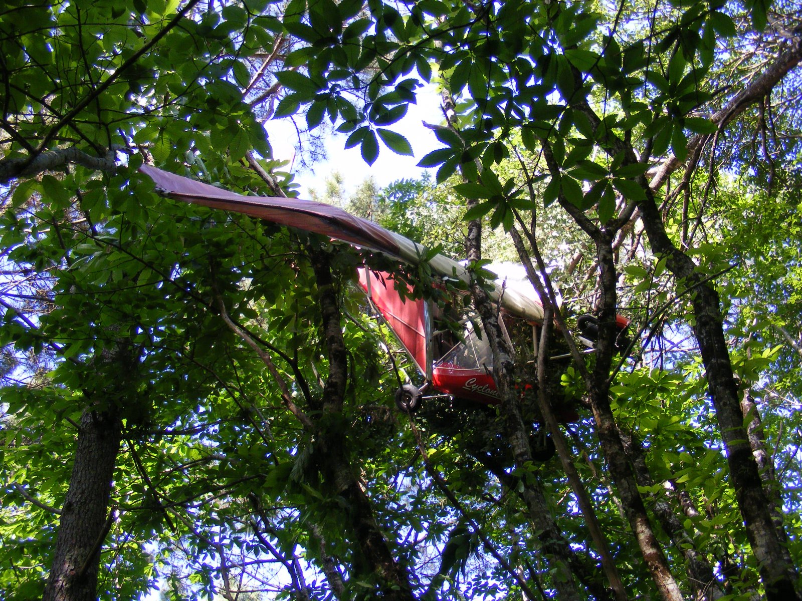

  7. This experienced pilot took off from my airfield. He had taken off hundreds of times and knew all of the checks that he should do. There should never be a problem, except on this particular day he forgot to check his weight limits (and that could be the same as tightening a sump plug). The trees were very unforgiving.
