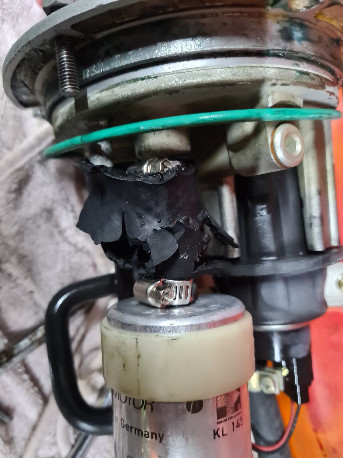

  5. think we found the fault with the low down fuelling
    amazed it ran at all! never mind it put my normal 996 to shame
    just replaced the filter and all of the lines.
    no leaks from the tank gasket (getting quite good at it. that's 3 tanks I've done in the last couple of months)
    hopefully take it for a spin tomorrow
    • Like Like x 9
  6. had a good test run. fuelling is better but still not perfect. looking at the fuel line I thought I'd be picking up a stack of power across the rev range but no, it's made only a small difference. fuelling is smoother but that's all.
