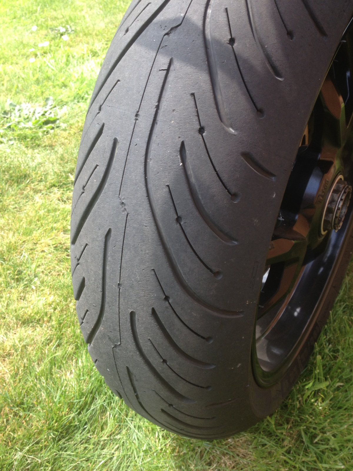

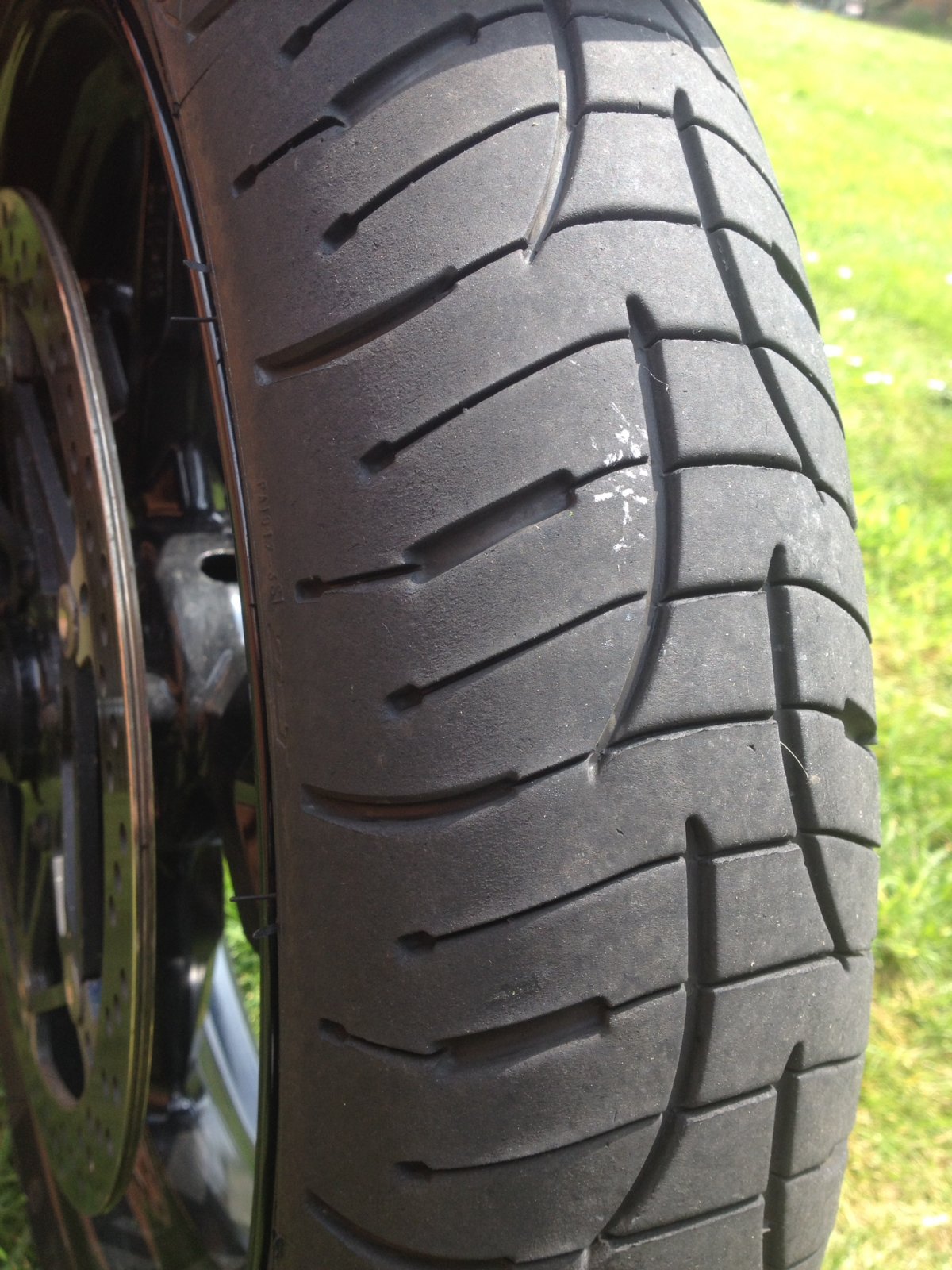

  1. Mainly middle rear, as you'd expect road riding. The front looks ok for the mileage apart from the edge of the tread on the right only. Can't seem to capture it as well but you can just see them starting to flick up/ stand proud, never seen this before.
    I used to do 2 rear's to 1 front, but not any more as found the front is way past its best before the 2nd rear is finished.
    I used to run PR4's on my single spark and get 3500 out of those, so can't understand why not now. These tyres have done 1940 miles and bike ridden no different.
  2. Look at your front again.......
    The centre line of the tyre shows the leading edge of the sipe feathered and the trailing side cupped, do you agree? Follow that sipe and you will see the sipe reverses this trend as it meets the sidewall, it turns to leading cupped and trailing part of the wipe is feathered???
    This is normally a rebound issue if i remember correctly, also it looks about 4mm tread depth? Fucked??? suspension setup then run in again then fill your boots,
    Rear, flatted out centre but using nearly full lean in the turns??? Your a point and squirt if you say your not a toured or luggage up?? 3mm tread?, tyres far from fucked but yes you would feel inferior feedback compared to new tyres, get your suspension looked at, match it to you, if you have already done the suspension relative to your current weight then move away from highly sipped tyres, that being the case avoid Z01's as they mould same as PR4's so next big boy would be Pirelli Angel GT's, they should deliver wet grip with a higher silica content which allows the need for less thin sipes, those tyres have easily got another K on them, you need to appreciate that tyres loose there ability as wear patterns set in, the patterns yes are part of the tyres make up, AR influenced by YOUR suspension set-up, but if they do not suit you then move to something that suits YOU and your BIKE together with YOUR riding style
  3. You sound like you know your sheet!
    You're correct re suspension set up, I've been struggling with the front end for a while now. Couldn't sort it so had dealer look at it, they've diagnosed a fooked left fork internal. (no compression) Probably going to replace the complete leg, apparently they're not allowed to pull the internal on the left leg apart.
    so the plan is finish off rear, replace rubber and have suspension setup as off to the B500 in July

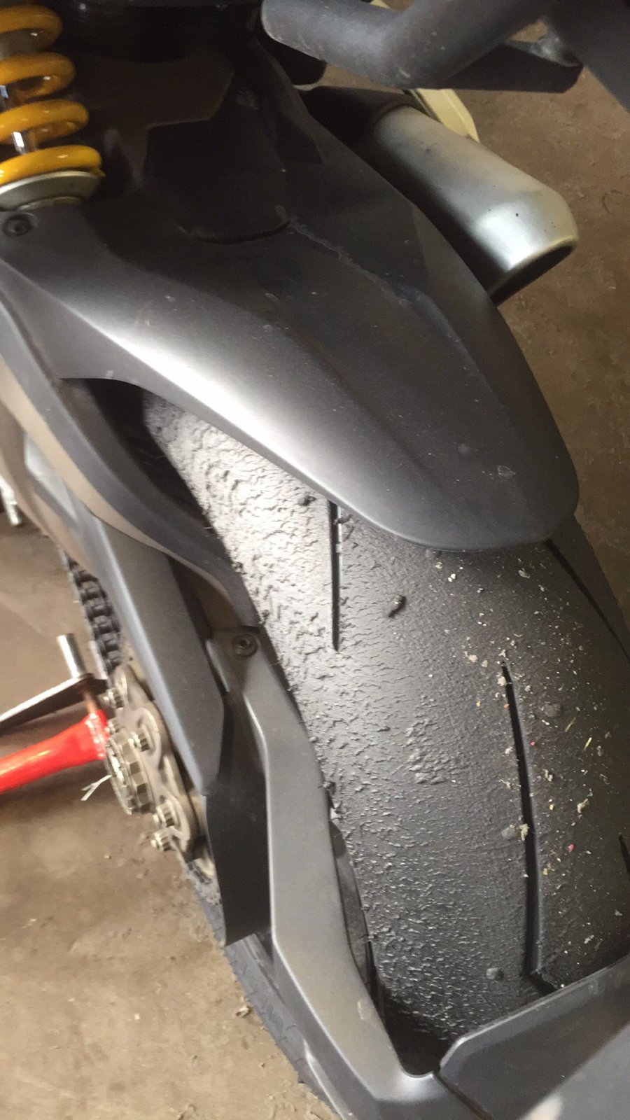

    Wtf are you doing to them?! I got 4K+ from rear and 9k front on my pr4s. And the scorpions are very average tyres.
    Try supercorsas ;)
