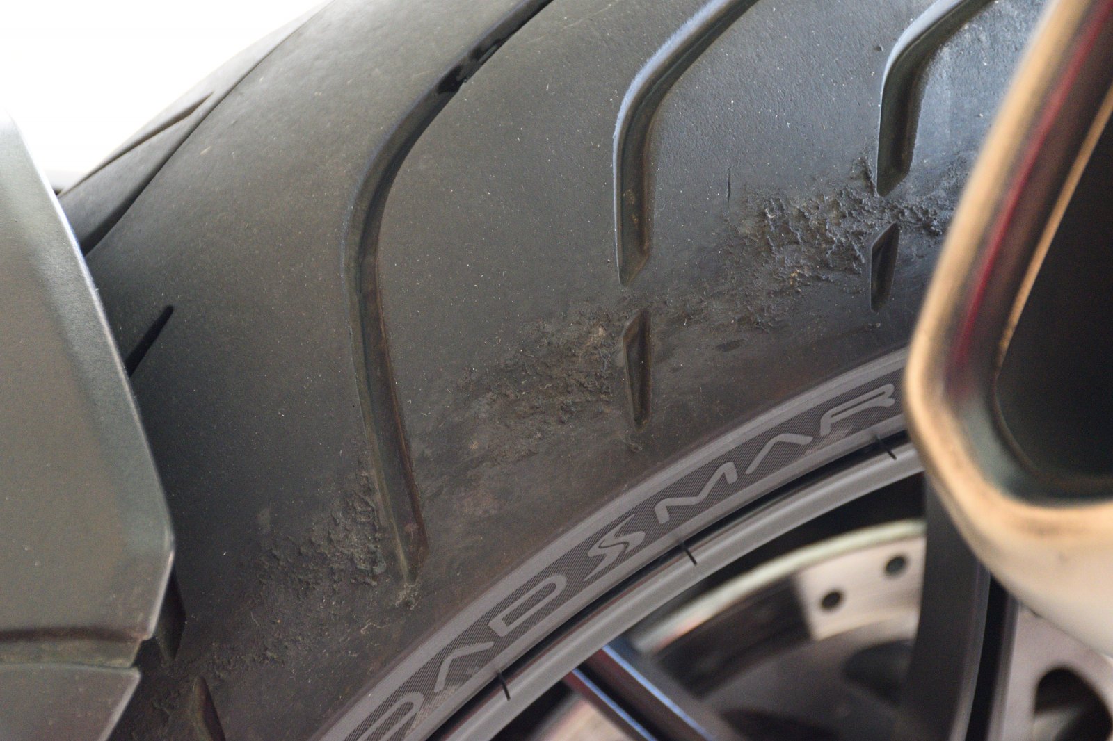

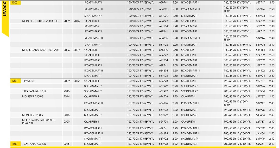

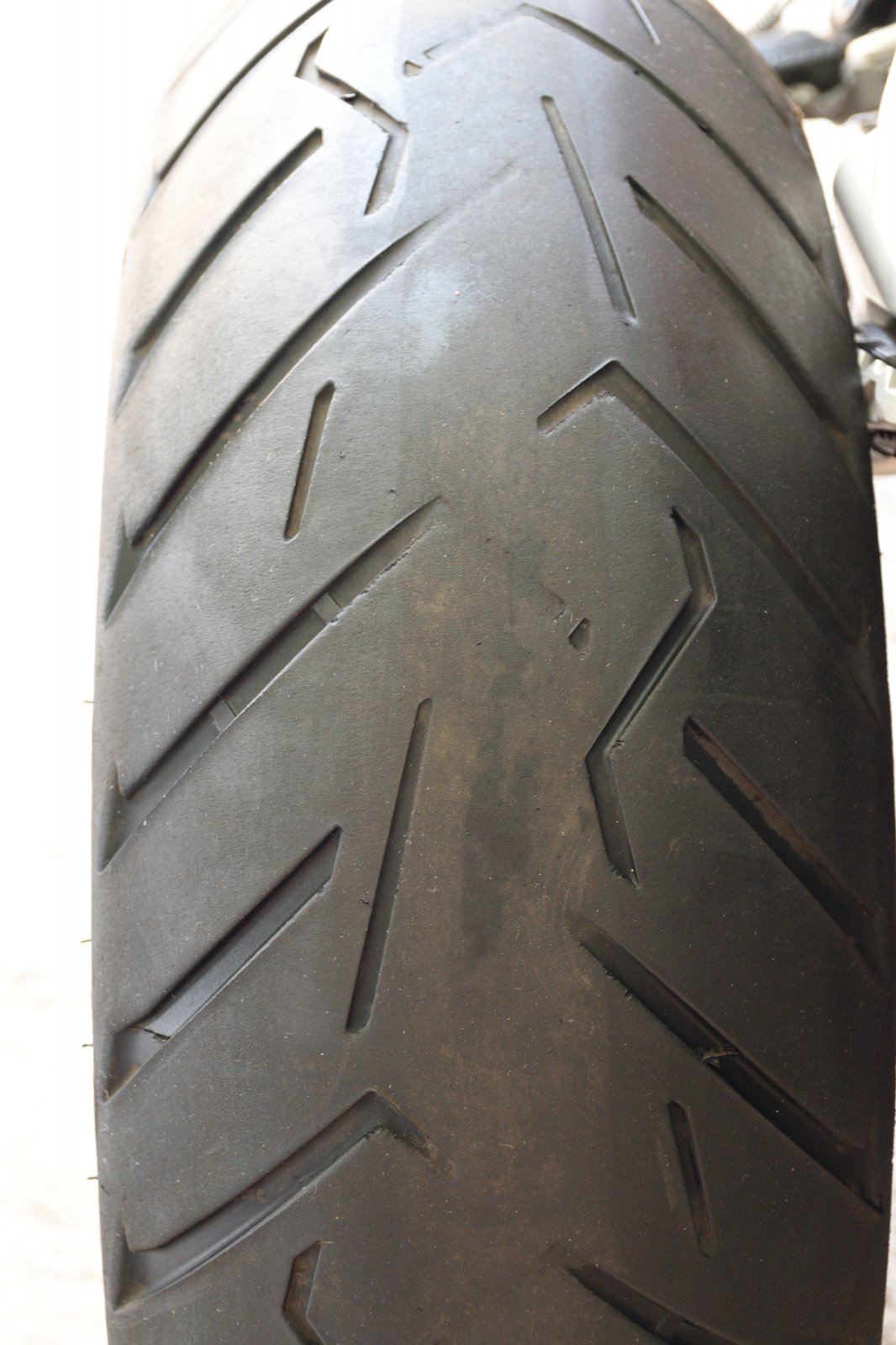

  5. Hello folks,
    Just to add my experience with tires on my Multistrada so far.
    After 11k km the original Pirelli Scorpion Trail II replaced. Even though no tread had been left in the middle, as it is seen at the pictures below, the tires had very good grip in dry and wet, especially when the bike was leaning, as much tread had left at the sides. The Pirelli performed flawlessly till the end.
    I decided to put on the new Dunlop SPORTMAX ROADSMART III. When the tires delivered, I realised that they had very strong carcass. I put them on with the manufacturer recommended pressures, which is 36psi for both, front and rear wheel, and I went for a quick ride at the ring road of my town.
    The feedback of this first ride was as following:
    - Even though the grip was perfect, the feeling was that the tires was made of Teflon, as nothing was absorbed from the road.
    - At approximately 200kph the steering started to wave and
    - When I came back home, I could hardly touch the rear tire because of temperature.
    So I did a search for the pressures and I found out that the Dunlop Fitment Guide recommended pressures are 2.2bar~=32psi for the front and 2.4bar~=35psi for the rear. Finally after some experimentation with pressures I ended to 30psi for the front and 30psi for the rear, for rider only, which I run for the last 5000km.
    I have to say that the tyres warm up very quickly and there are load of grip in the dry (not tested yet in the wet).
    As @Rainman above with T30’s, I managed to ride the Pirelli Scorpion's to the edge of the rear and I had no visible "chicken strips". Even though I ride the Dunlop a lot quicker and leaning harder, the width of the "chicken strips" at the rear is ~25mm. I managed to ride the rear to edge only once, at the Missano track session at WDW2016.
