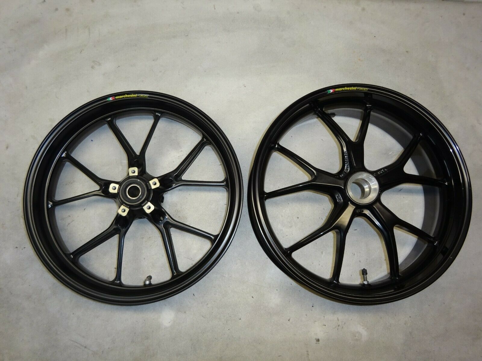

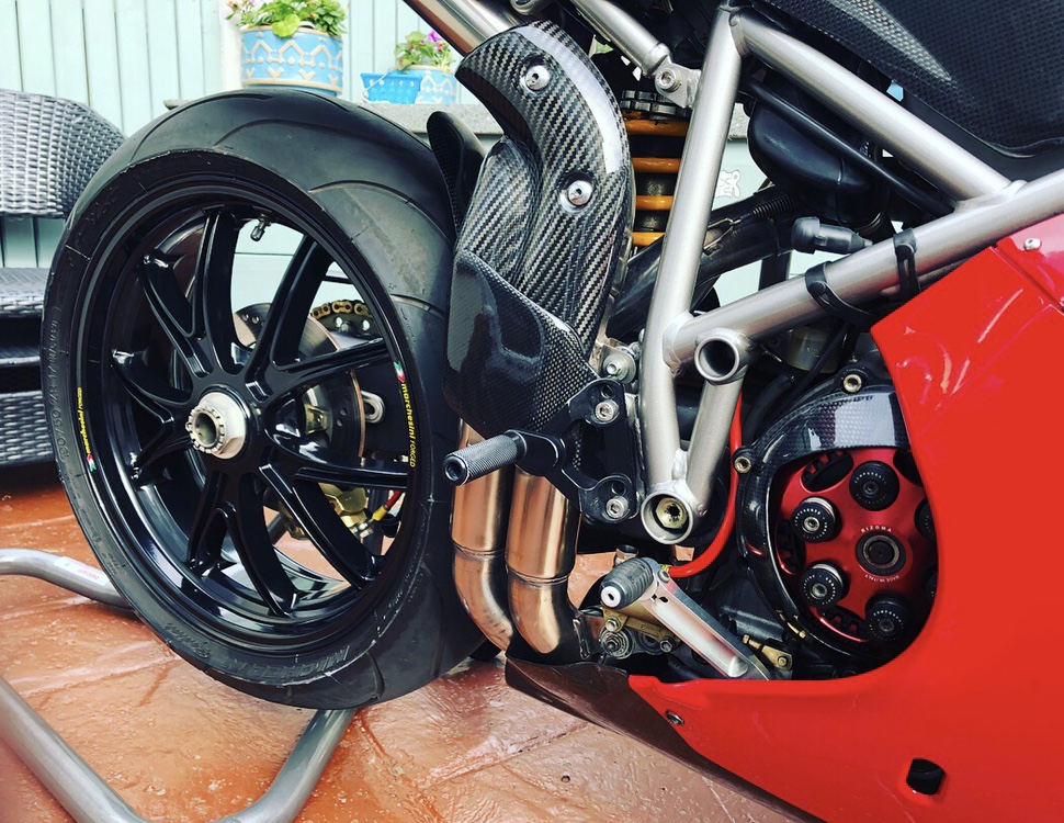

  3. What nelly said. The mechanical speedo drive on the 748 is taken from the front wheel. A nice pair of period Marchesini 5 spoke would look nice. Andy

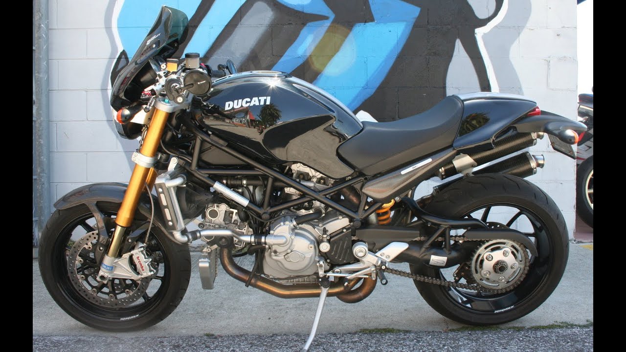

  6. im seriously thinking of going with theses... they are the s4rs ones. anyone tell me if the front is a direct fit? i would have thought so...
  7. no probs with the rear. The front will need the discs and a few other bits to fit. Don’t know where you’d get the pick up for the speedo drive though....
  8. so did the s4rs not have a mechanical speedo dive like the 748 and the hub is wider or something?
  9. Not sure mate. @Zhed46 might be the man for this. I think that’s what he bought the BST wheels for but I can’t remember now if he used a digital dash with a pick up or the mechanical drive.

  11. Yep, the T9 uses a hall sensor on the rear calliper hanger.
  12. if i had the money id just buy a whole s4rs.. i quite like em... still, that wouldn't fix the 748 wheel dilemma!
  13. and they are 5 hole for discs where as your 748 will be 6
  14. if you can get the front wheel with 6 disc hole mounting chances are it will also be the mechanical speedo drive
