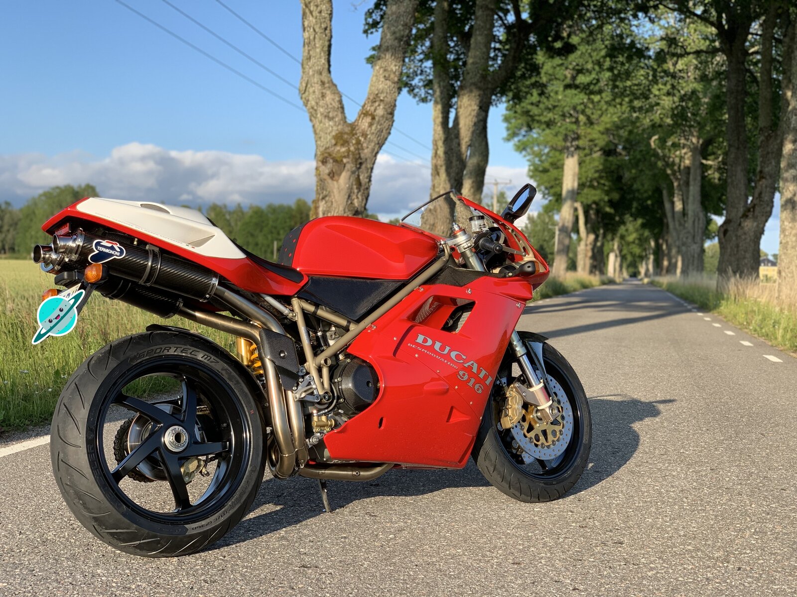

  6. I'm really liking the mag 5 spokes at the mo.
  7. They are classics.
    You never get tired off these.
    I have the alu 5 spokes in my 916 but i painted them gold like the mag marchesini wheels.
    Henk!!!

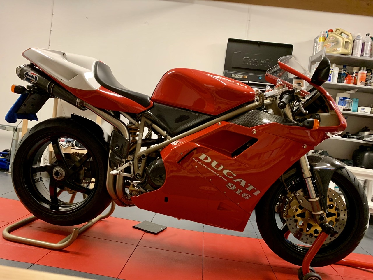

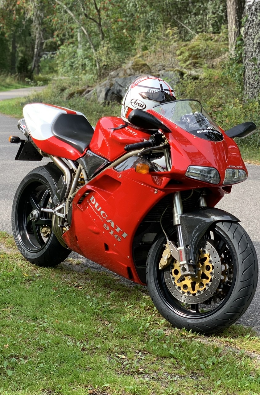

  8. Some more angles for you sir.
