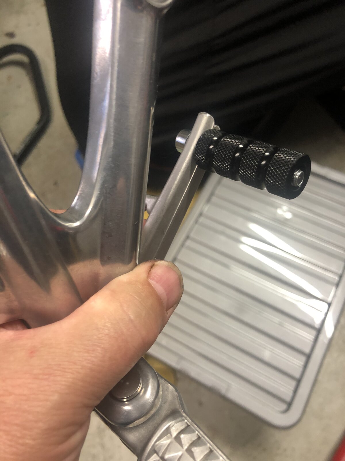

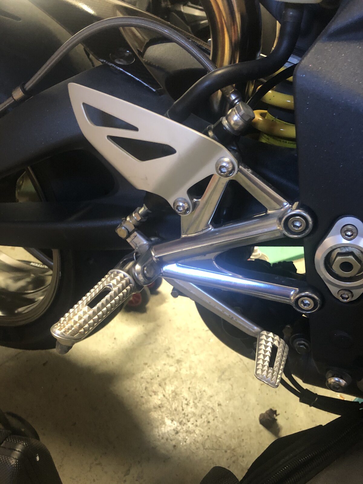

  2. Broken brake pedal sorted with new (s/h) rearsets.
    Manufactured a spare from the broken one with a drill and tap.
    Getting there now.
    84C9AC61-FCB7-4531-A96B-A730F509AAF9.jpeg EFD66657-07E5-48F3-8058-B27CBDEDD61F.jpeg

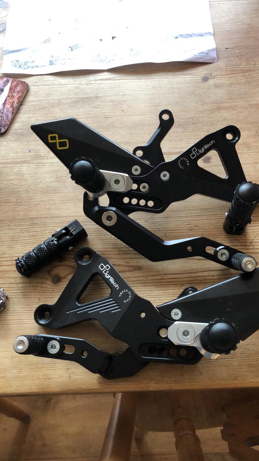

    I made a boo-boo and bought a set of Lightech rear sets i spotted on eBay with road and race shift but have yet to be delivered.

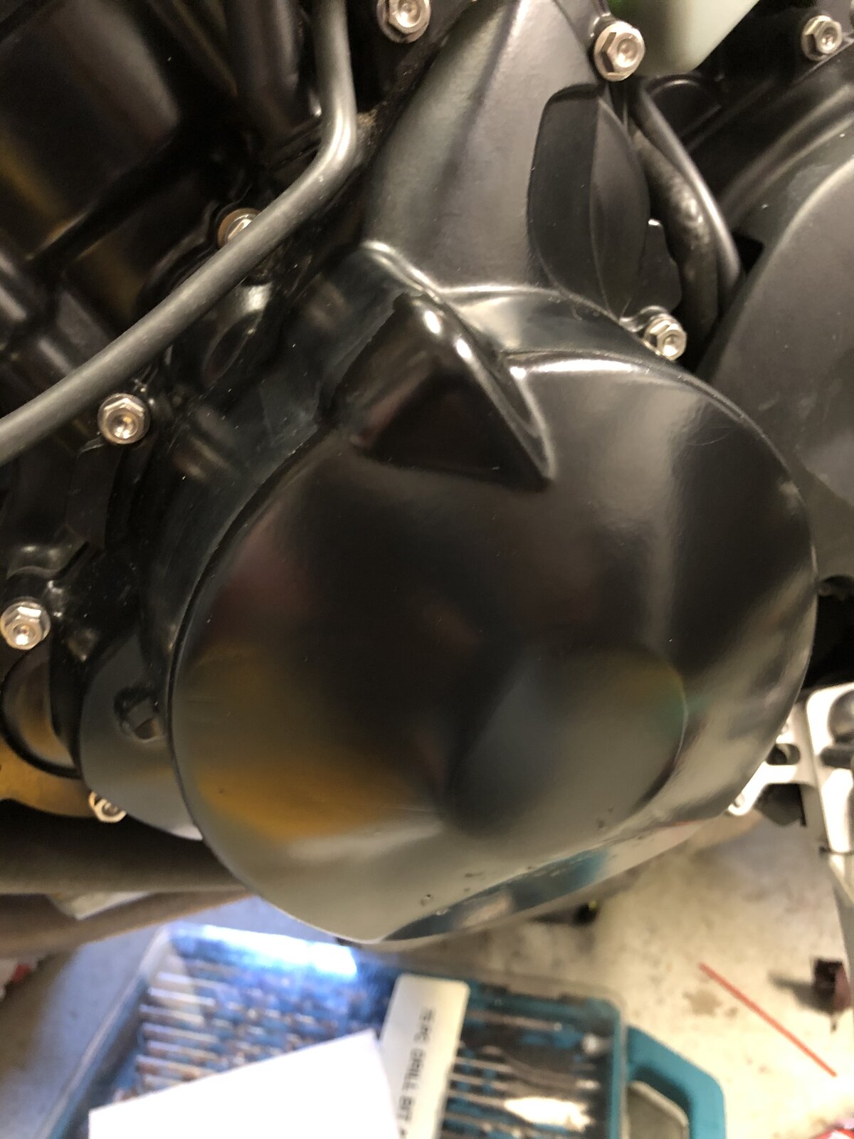

    That's better, cam chain and clutch cover now looking pretty smart again.....

  15. Postie has been. eBay semi bargain. Fixed and folding pegs, race and road shift.
