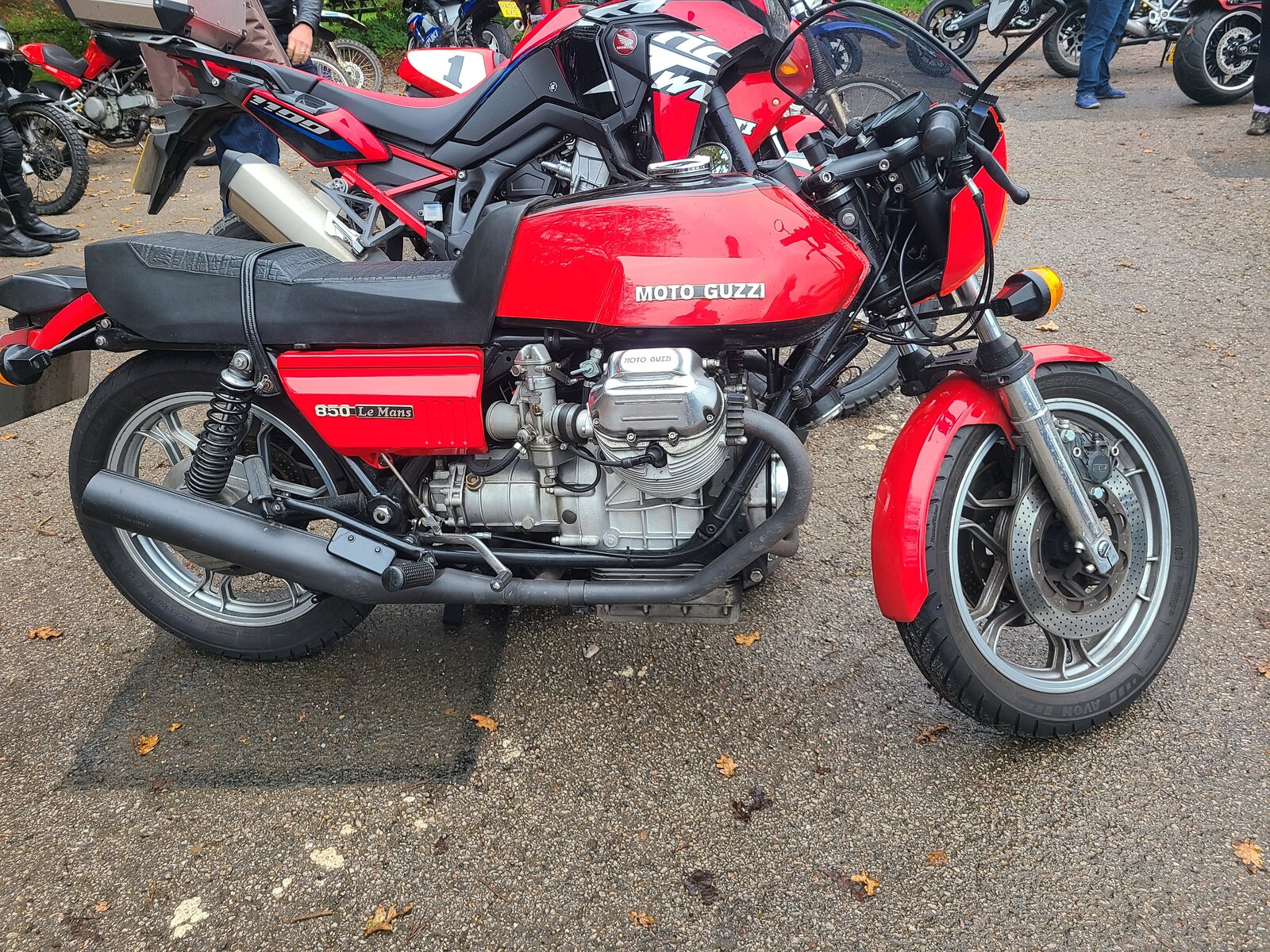

    Here is my LM1.
  10. A mate has just bought an original Black / Gold LM2. Good runner and a great basis for a rolling restoration, lucky git!
  11. Yow, thats a lovely looking bike!

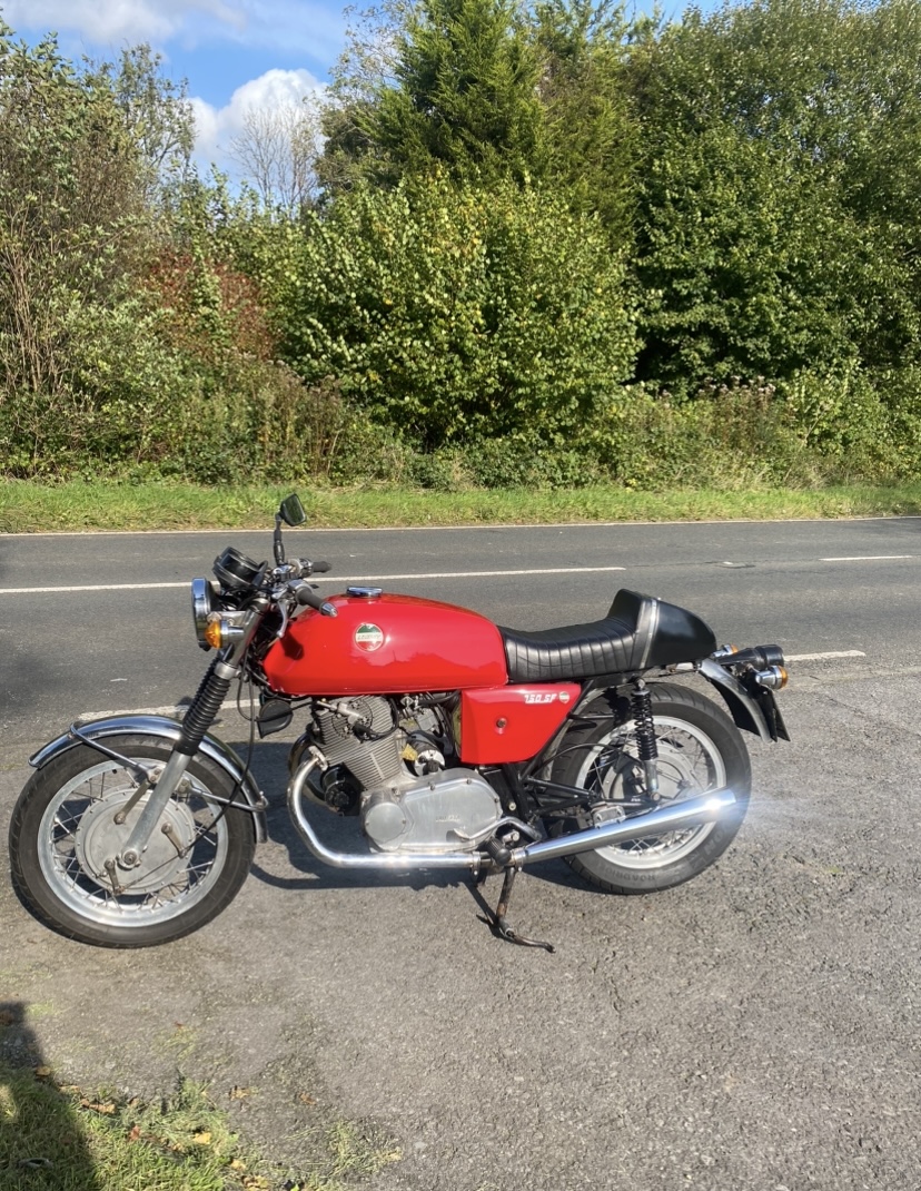

  12. I just came across the thread while looking at comparisons with lemans 1’s. I love mine and it is close on my favourite bike alongside my Laverda SF1. Another bike that will laugh off high (ish) speeds over long distances.
  13. OK but a Laverda 750 is only a parallel twin with no balance shaft. It will never be as smooth or sound as good as a 90 degree V twin.

  15. Tbh being smooth isn’t something that is essential to me where engines are concerned unless it is in a car. I like to be able to ‘feel’ an engine on a motorbike. I wouldn’t say ‘only’ a parallel twin either, it is a great engine. I love the thing.
