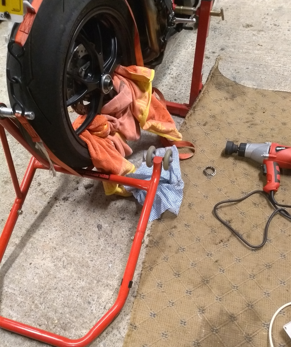

  11. Thanks all, nut finally off, the Clarke is a bit of a beast and took it off in probably 2 seconds, used cloth on nut and covered base of wheel with towel to avoid any falling stuff chipping rim. Also found a use for the funny red tubey thing that came with the bike.
  12. The “funny red tubey thing” is your rear paddock stand :joy: Andy
  13. That a hell of a Heath Robinson contraception to keep that rear wheel locked! Love it :upyeah:
  14. Excellent outcome AJH - we all like a happy ending. :upyeah:
  15. Neat solution:upyeah:and you can just stand on the tubey thing when you torque it up:)
