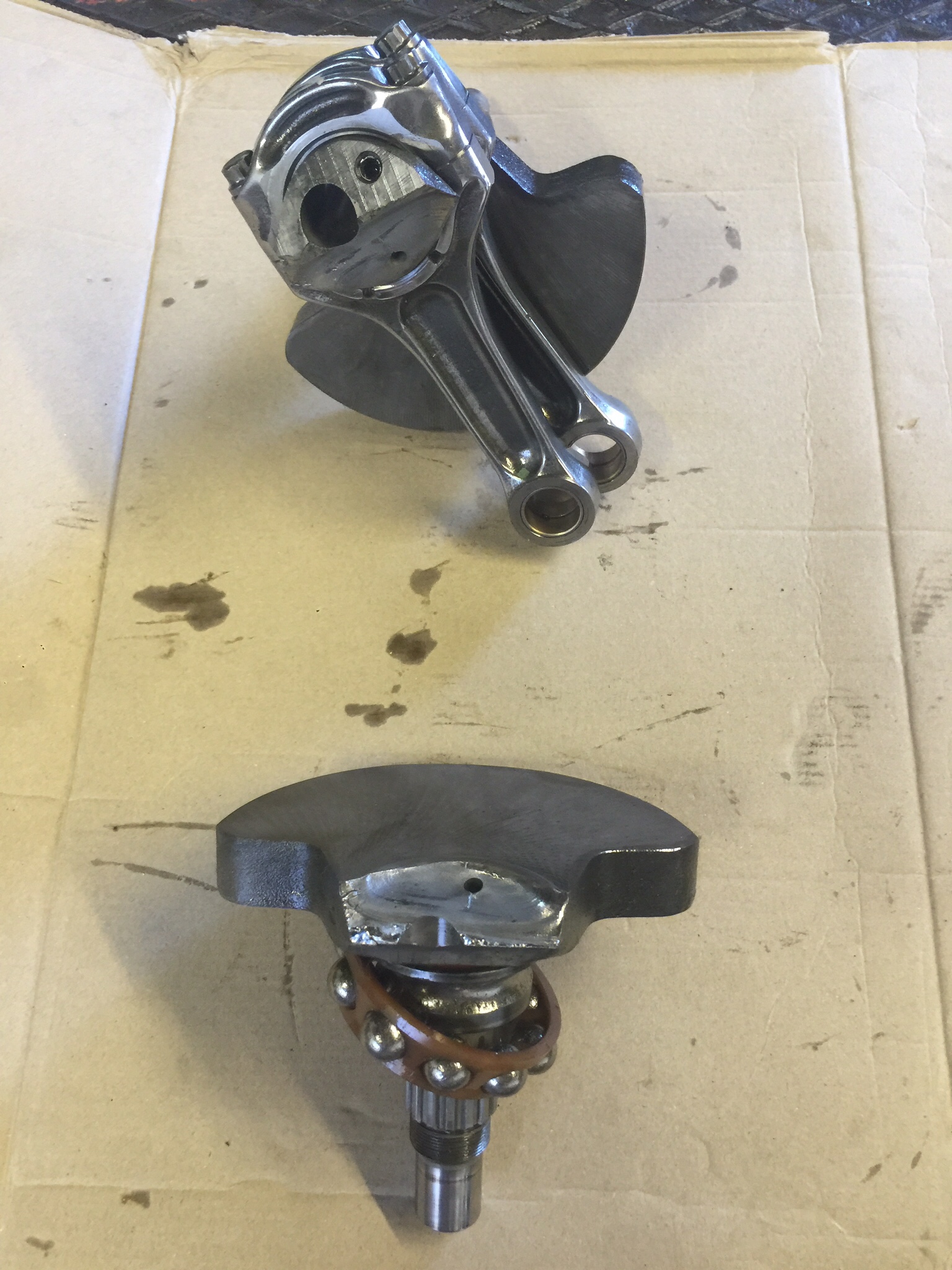

    Sadly, when just out of warranty, I had the engine go in a big way. People talking about main bearing issues on the early models are not talking shite. Had a dealer unofficially tell me they won't take part ex with older multi's. My actual crank snapped in two. Mega damage and I was told by Ducati and dealer to pay myself as they didn't want to know. Upon inspection, main bearings were shot but the inspection couldn't tell if the snapped crank caused the bearings to go or vice versa. Either way, it just shouldn't have happened and it was labelled as poor manufacturing and paid out by finance company.
  4. JEEZ! :eek:
  5. [​IMG]
  6. Bloody fkn hell mate! :eek:
    I bet that felt pretty weird when it let go! Jeez...
