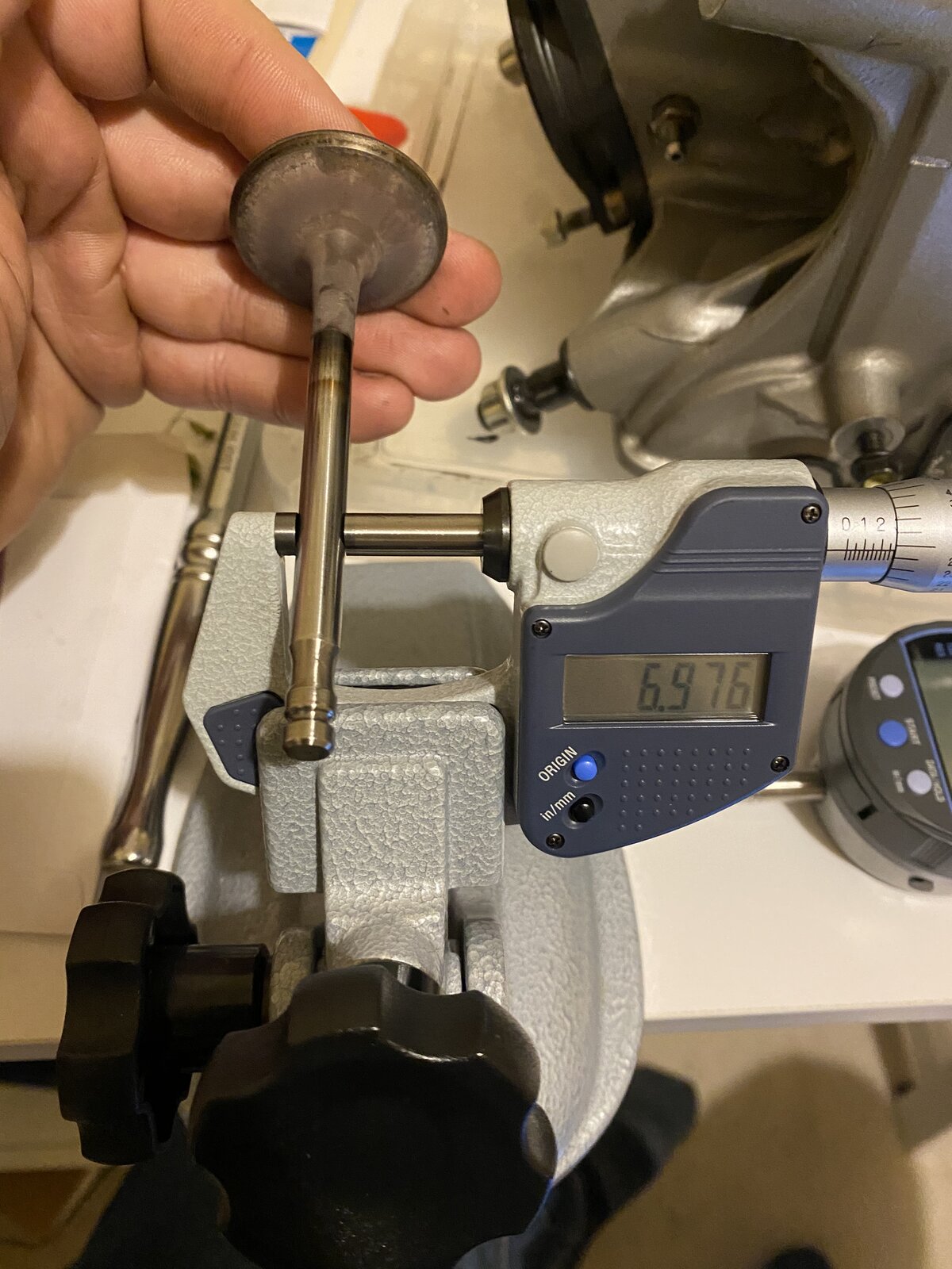

  2. Thanks yeah the bike has worn well over all! I’ve already given it a shakedown at Cadwell park and it ran well! It didn’t help there were 9 red flags that day in just the fast group as the temps were only 5 degrees! The tooling is quite expensive tbh. The superquadro motor seems to require more specialist ducati tools than any other ducati motor I’ve seen. Realistically you’re looking at least a grand in the special tools you need to pull it apart as the way the cases are designed the liners need a special puller tool to be able to split them. I’ve always refreshed my trackbike motors in the past but they were either Japanese or a bmw S1000rr motor. This is the first time I’ve done a ducati one and it’s pretty complex compared to those.

    es exactly its had a hard life up to that point. Everything was in spec except the exhaust valve guides and top con rod shells which were showing signs of a fair bit of wear. But that’s to be expected as you say!

  13. It's a nice micrometer that. Imperial screw barrel with a metric/digital converter. Everything I get my hands on out here has been used a fekin G-clamp.....
