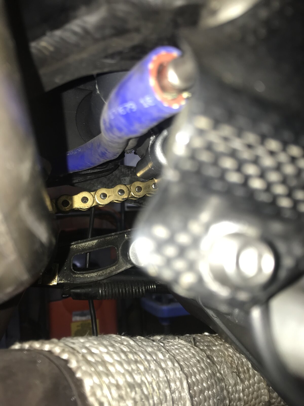

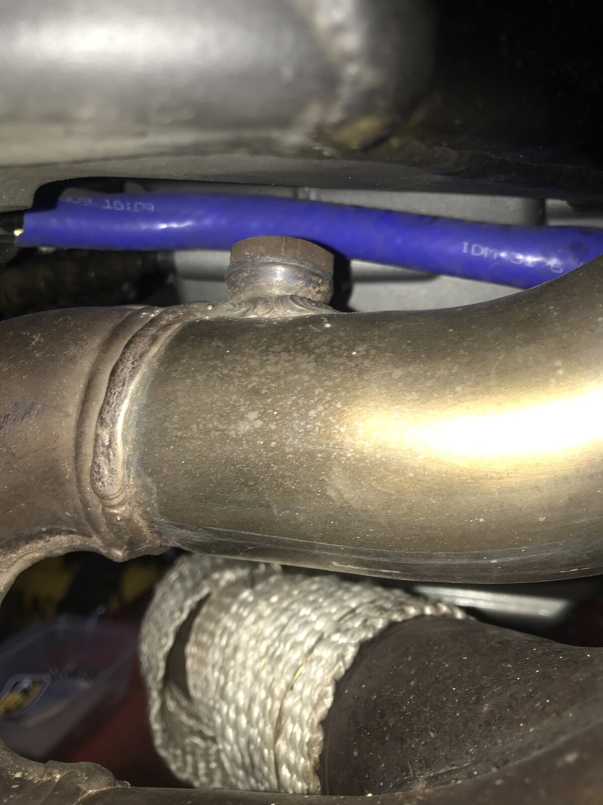

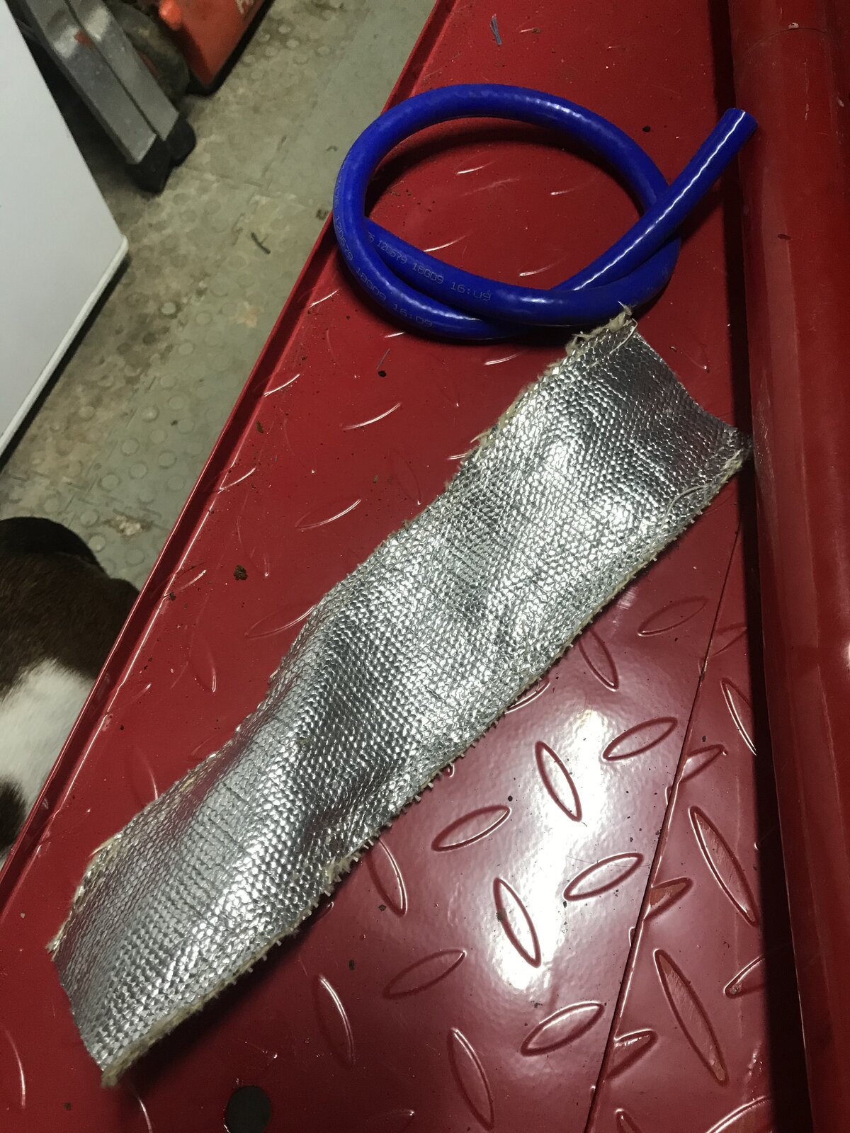

    I always believed the brake faded due to the heat from the exhaust so I used some high temperature silicone boost pipe of a turbo & some heat shield wrap to cover the brake hose where it runs near the exhaust.
    So far so good, the pedal still feels good with no excessive movement.
  3. :astonished: that is close to the exhaust isn't it?
  4. Yup, lagged the exhaust front pipe to protect the carbon lower fairing too as the original started to bubble
