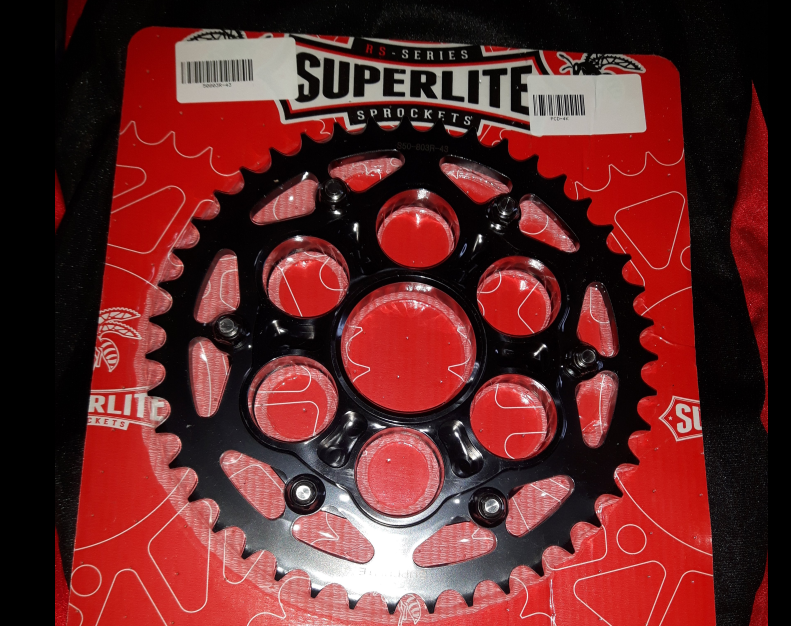

  11. If black is what you're seeking for your MTS 1260, Superlight has you covered. The quick change carrier for the MTS is PCD-3 and available as a set in 40T or 42T configuration. I have a similar set on my Monster as shown below. FYI, the carrier is available in black, silver, red and gold.
    https://www.baysideperformance.ca/1...e-rear-sprocket#/15600-sprocket_size-42_teeth
    You can email the owner of Bayside Performance in Vancouver for options at:
    [email protected]
