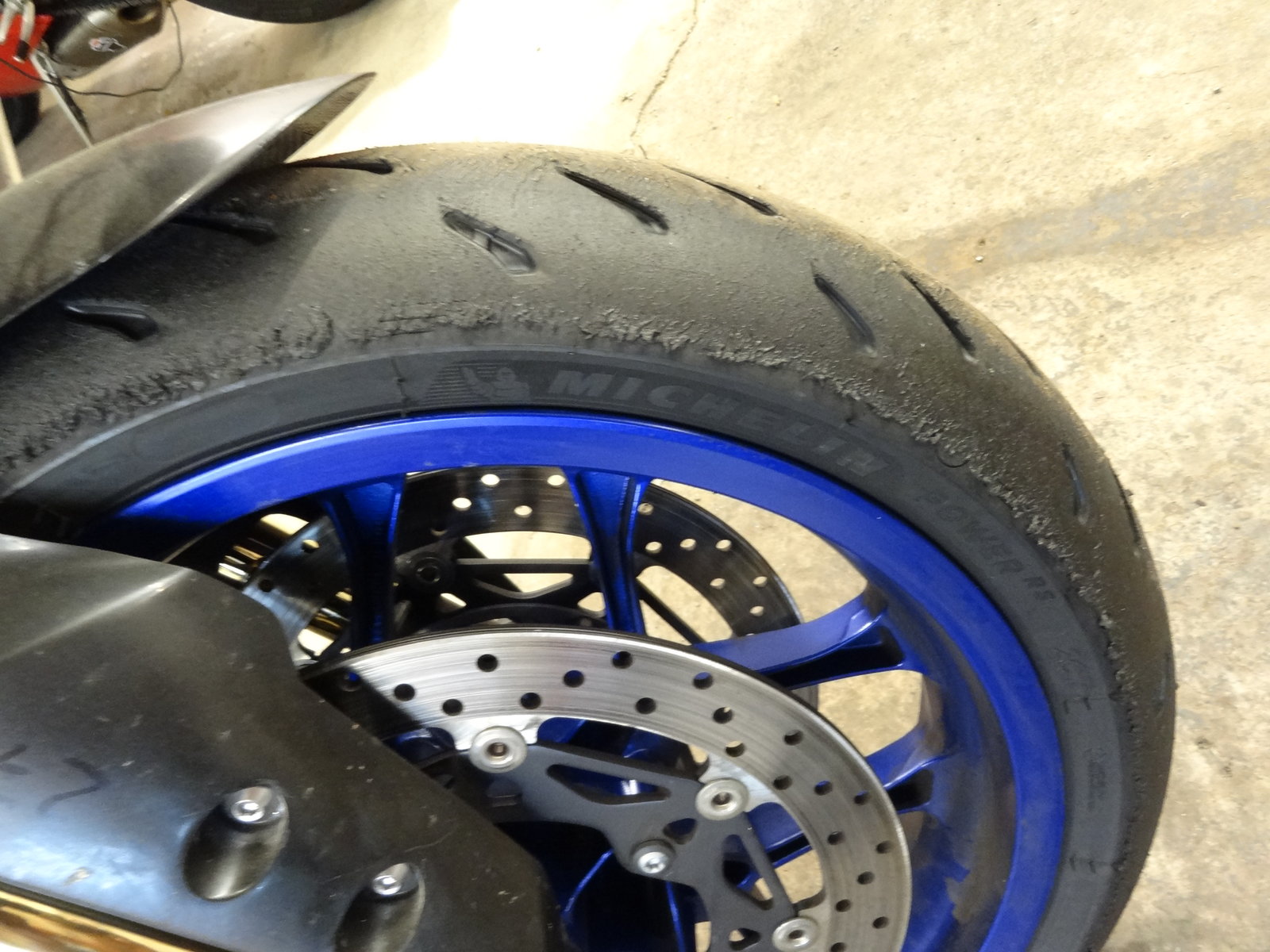

  3. Come on man ffs... Your rear tyre is destroyed because you've set the geometry all over the show, go on show em - at least give em the whole story - that way they may be able to help you
  4. Nope. Was screwed after Silverstone and I hadn't touched it then.
  5. Still because of geometry and tyre pressures alongside riding stye :)

  8. Pirelli Rosso 2, New this spring, 900 mls including a dyno day and 2 TD's, one at Snett and one at Silverstone.
    Then with NO change to bike accept for a new tyre (190 went to 180) and change gearing from +2 rear to -1 front this is 100mls and 1TD at Silverstone. Damage was done before any suspension/geometry change.

  9. Once I have a new tyre, next TD i'll book in with the suspension guy and spend the day getting it right.
  10. Dude, just put it back to standard ride height and go with good pressures. Your issues was caused by poor pressure choice and then the compounded affect of even further from a good pressure. Add into that a shortened gearing, so likely mid corner in a better rev range asking more of the tyre and heating it even more. Plus they are track orientated tyres, nothing like those hard pirellis.
    Stick 27 cold in, if it starts to tear after a session stick 26 in...fast riders using these are 26 off the warmer so more like 24 cold
  11. I like this ride height, it handles SO much better and is generally accepted as the way to go for handling. Damage was done on TD1 before all the changes and I want to get these changes to work. Gearing was already +2 rear and changed that to -1 front and back to standard rear cog so that's like 1/2 tooth difference so I can't believe that's the issue. Tyre guy is saying this should not happen with a few PSI wrong, it's going back to Michelin on Tuesday and will see what they say.......
  12. Yeah the pro I was exchanging messages with said try Michelin...but it is pressure related and no correction action.

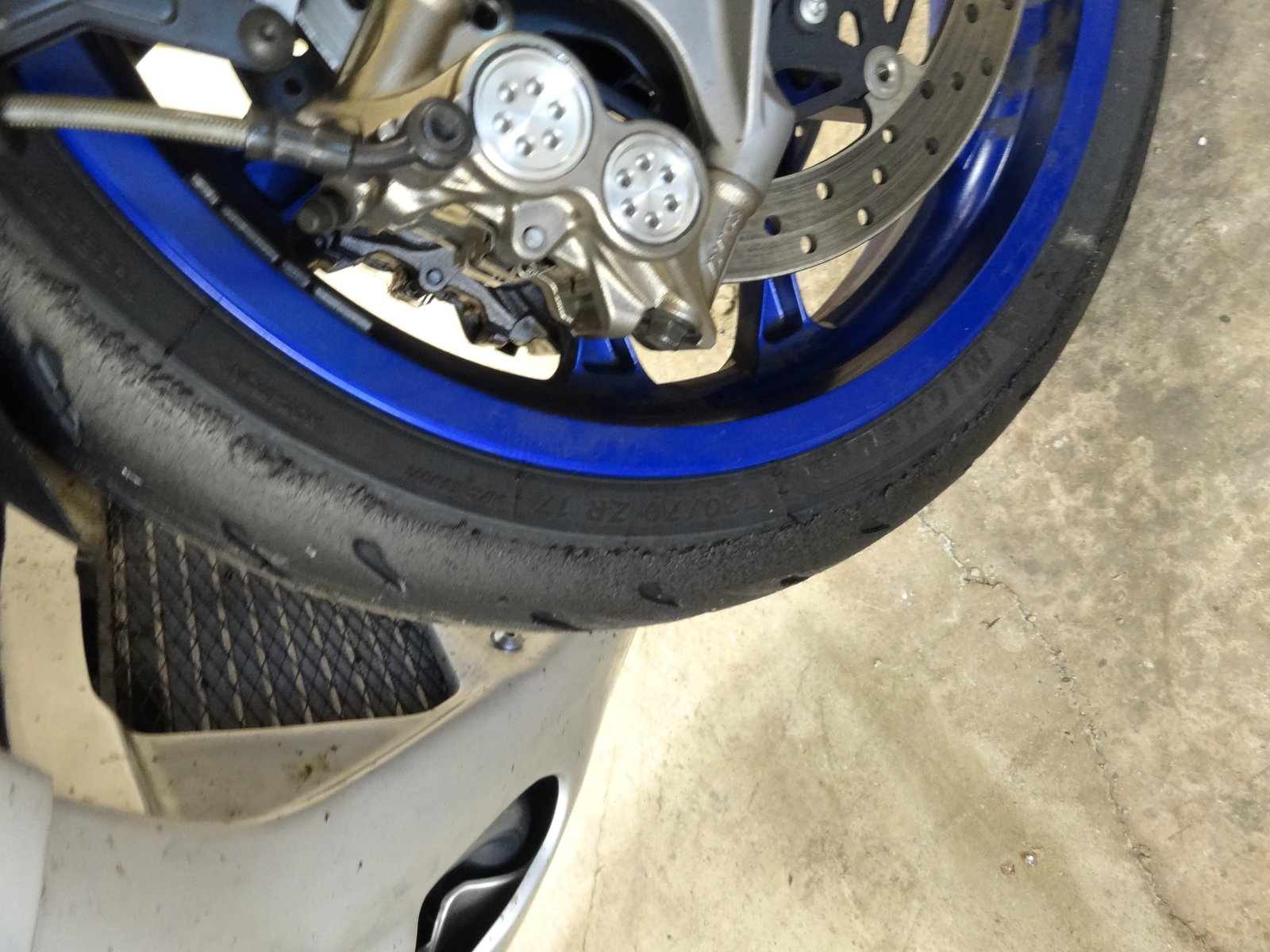

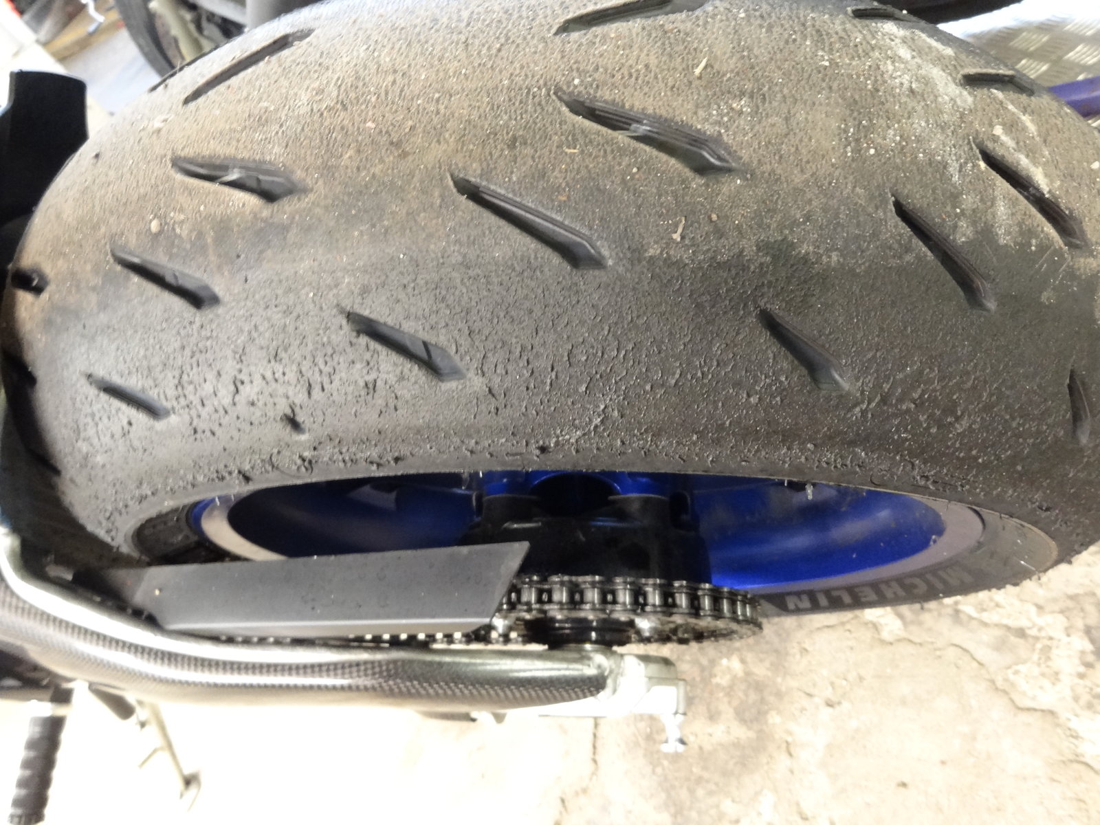

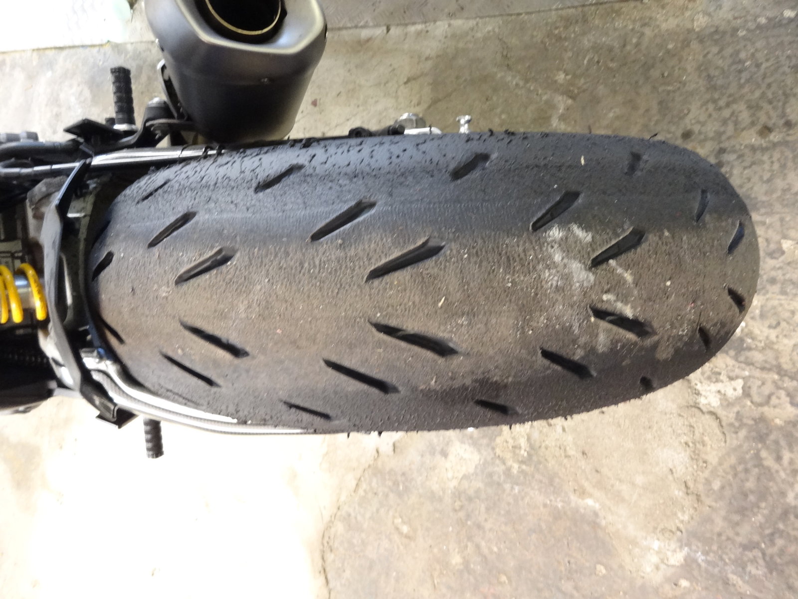

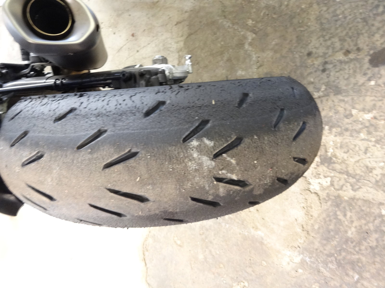

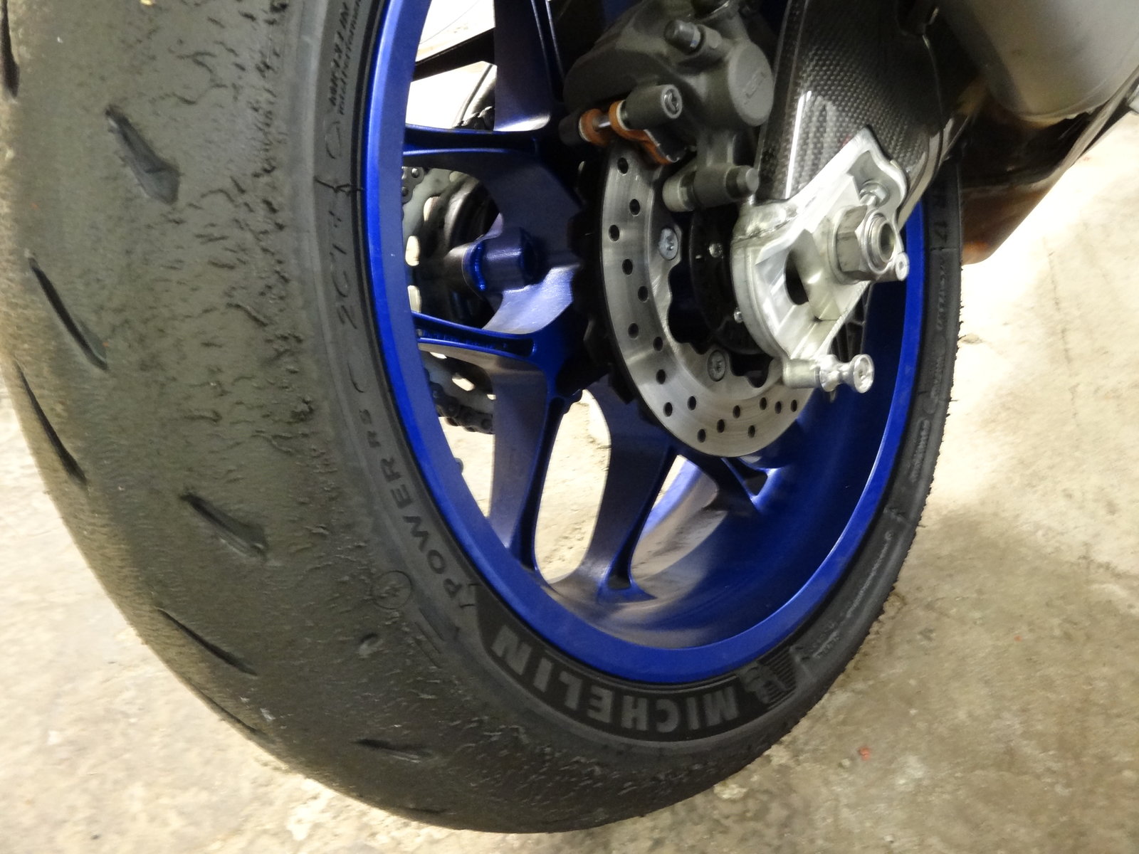

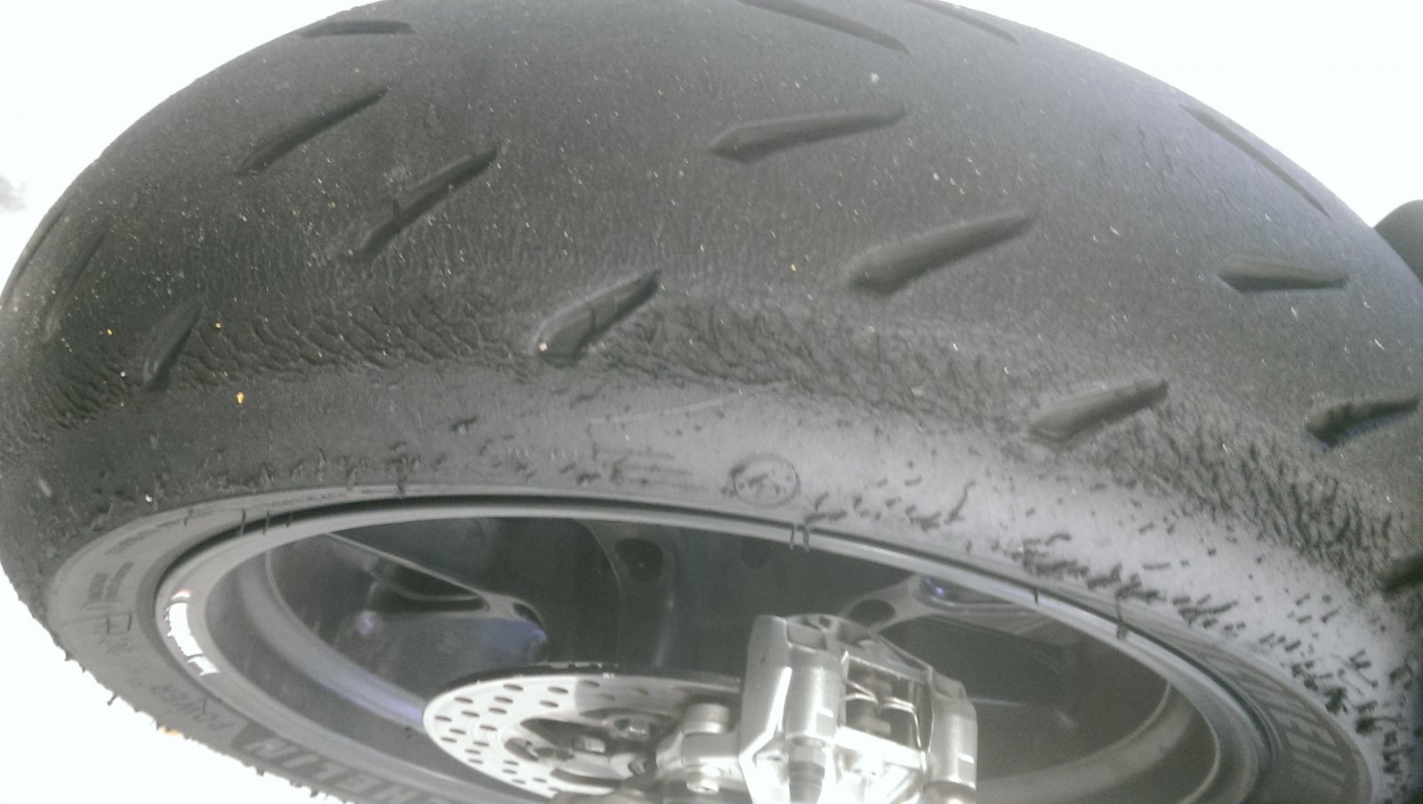

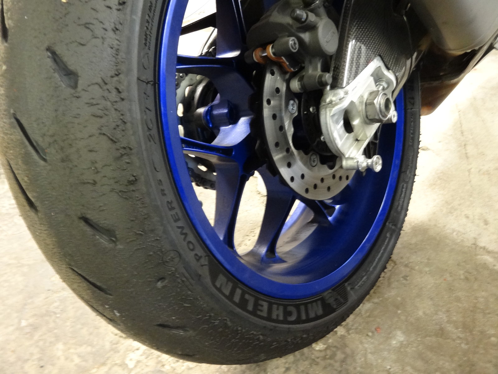

  13. Pics of my tyres done 3 Track Days all at Brands Gp DSC02956.JPG DSC02957.JPG DSC02958.JPG DSC02959.JPG DSC02960.JPG
  14. In fact your rear on the right you can see an inch wide band an inch in.....
  15. Yeah that's where he's applying the power. So he's picking the bike up before accelerating.
    The first pic is soft suspension or wrong pressures and a cold/hot tear. Hard to tell the difference.

    Cold tear probably, just not as bad. What pressures are you running off the warmers Trevor?
  18. Hello Sir
    Hope you are good
    31 Front
    28 Rear
    And i don't use tyre warmers for the last 5years Terry has been telling me to lol.

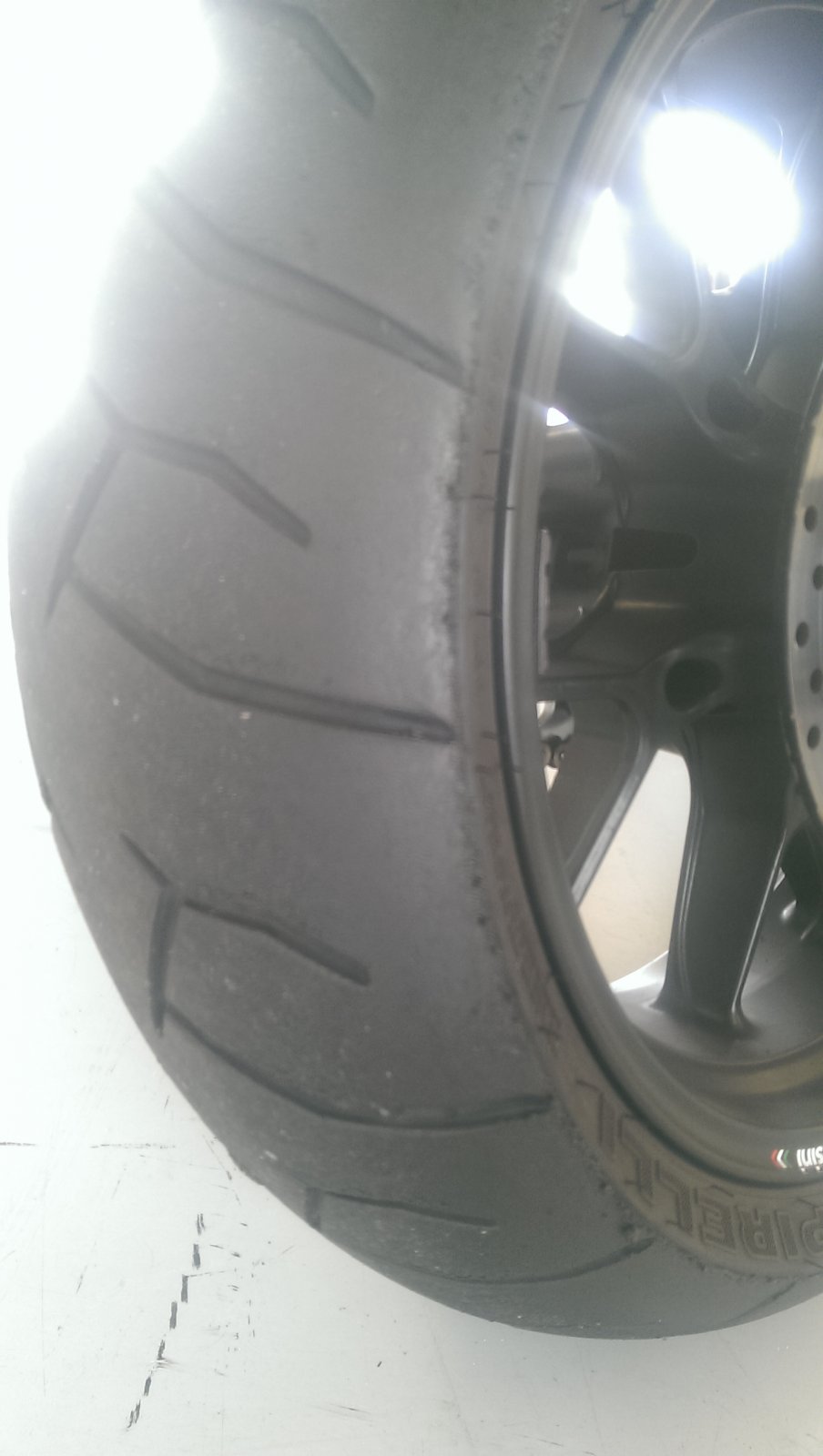

  19. if i show you my Bridgestones you would be horrified lol
    but thats just how they wear apparently GREAT TYRE the ones that come with the R1M
