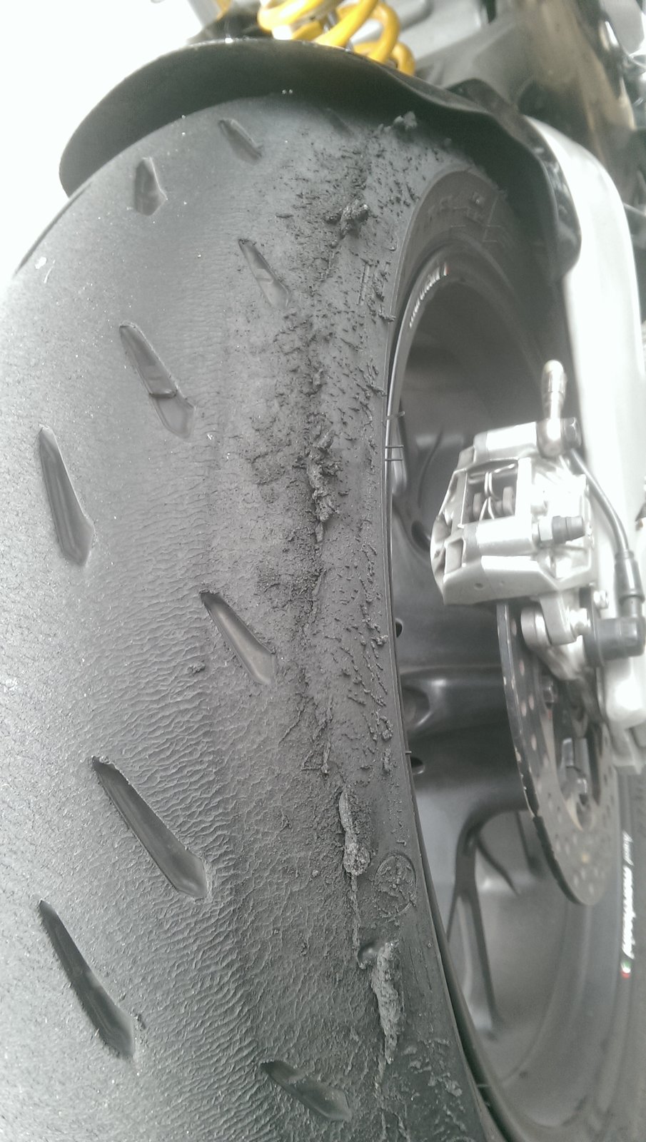

  8. To be honest, if these Powers are supposed to tear up 1" an " in they seem a bit shit to me. You are running Michelin recommendation at 28 cold rear. I will try 26 cold on my next TD.
  9. It's not the tyre. I've done track days for years on all different bikes, tyre sizes, brands from road to slicks. It's suspension or pressures.
    My track bike has standard suspension and tyres wear perfect every track day after perfecting pressures and suspension setup.
    • Nuke Post Nuke Post x 1

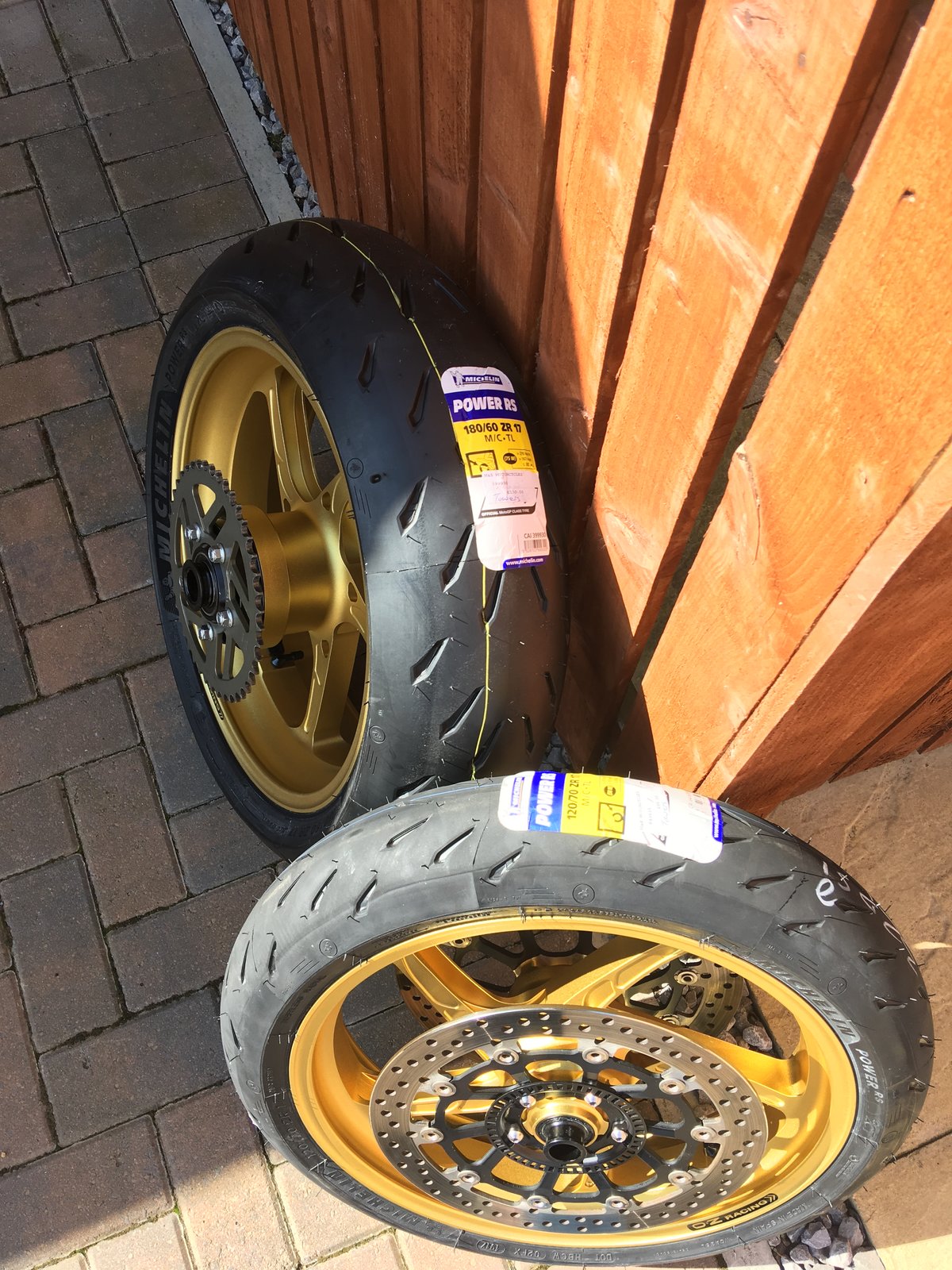

  11. Just stuck a set of these on today. £210 fitted after £30 cash back can't be bad.
    Shame they lost one of my OZ metal dust caps though and I didn't notice the crappy plastic one in its place till I got home!
    Yet to try the bike but I set at the pressures as I used with supercorsa SP from the 1299 manual (33 front 30.5rear)
    Michelin website just says to set as per manufacturer spec...
    What pressures are everyone else running?

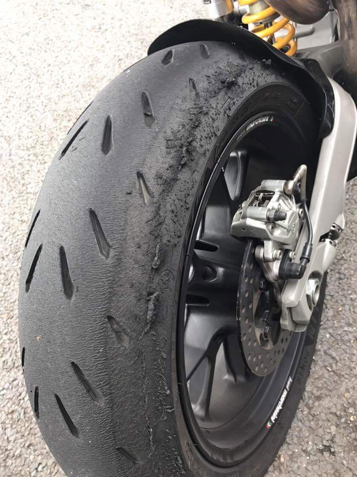

  17. Id say just from picture you're over heating the tyre when powering out of a corner. Too soft suspension.
    Although these arnt track tyres after a lot of trial and error I can get stock suspension on a 600rr to wear tyres perfectly and I'm just entering fast group now on trackdays. When I started out my tyres used to do the same.
  18. It's an expensive learning curve. I think tyre warmers would help too.
  19. Yeah definitely. If only to get more for your money from the trackday. I go fast straight off the bat on warmers.
