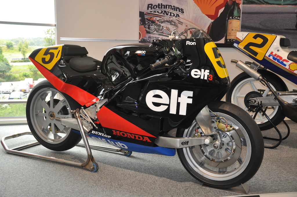

  13. Not quite so extreme as zero gravity seating, but from an engineering perspective, hub centre steering is a theoretically better solution than telescopic forks. Vyrus, Bimota Tesi, and the odd Yamaha I believe made it to production, but never really accepted by the general public as it looked different, took some getting used to, as well as a bit pricey.
    If it is better then perhaps need to proven in racing (win on Sunday, sell on Monday) but would probably need a big team to develop it properly to avoid other weaknesses of the bike resulting in poor results being blamed on the hub centre steering.
    Underdevelopment was possibly what limited the Elf projects success. I just read that when Elf stopped the funding and the project came to an end, Honda bought all the patents and the only one used in production to date is the single sided swinging arm.....
    Then again, if Ducati did it and it worked, you end up with the possibility that six times world champion Jonathon Rae would probably say "it's just not fair....."

  15. Ah, Mr B, I've been waiting for somebody to bring up Hub Centre steering, it's a particular interest of mine but thought I'd let somebody else take the flack:D
    I love it by the way, but it's sure to get some strong reactions either way
  16. Hub Centre steering AFAIK has always struggled because of lack of feel for the front tyre, it's also really had to get the stiffness in them at max lean which means they behave differently at high lean compared to forks, which as I understand it is more of an issue also than a rear single swingarm for example which some flex when driving at lean can be a good thing.
    Also the anti dive properties are disputed, modern chassis dynamics have come to value appropriate levels of dive as it shortens the rake/trail and helps to turn the bike into the corner, which if managed properly gives the bike a shorter wheelbase through the turn until you start accelerating.
    Finally I Think the amount of bushings/fixings and room for movement in worn hubs was the final main issue.

  19. Points taken, particularly the lack of feel which is something that comes up in the Tesi/Vyrus road tests I've read, but testers generally more enthusiastic after a few miles. Another downside is lack limit on steering angle and thus turning circle.
    Also note the point with wear in bearings and bushings compounding things, but would expect with proper development these issues could be addressed and overcome. Wear in bushings and bearings is also a problem with conventional bike suspension, which, in all honest, must be approaching the end of it's development with only really marginal gains going forward.
    I'd love one TBH....
