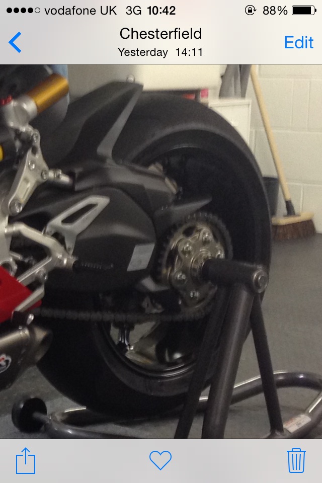

    I think it's over tyred for a 6" rim looking at the info I posted earlier :upyeah:

    They keep going bigger and bigger but there must be a known optimum for road bikes otherwise they would just jump to 250's now. I think it was reached with 180's and 190's. The Bridgestone race tyre web site where I got the fitment info didn't offer a 200 section, could have been an out of date page I guess - not sure if all road derived top class race bikes use 200's.

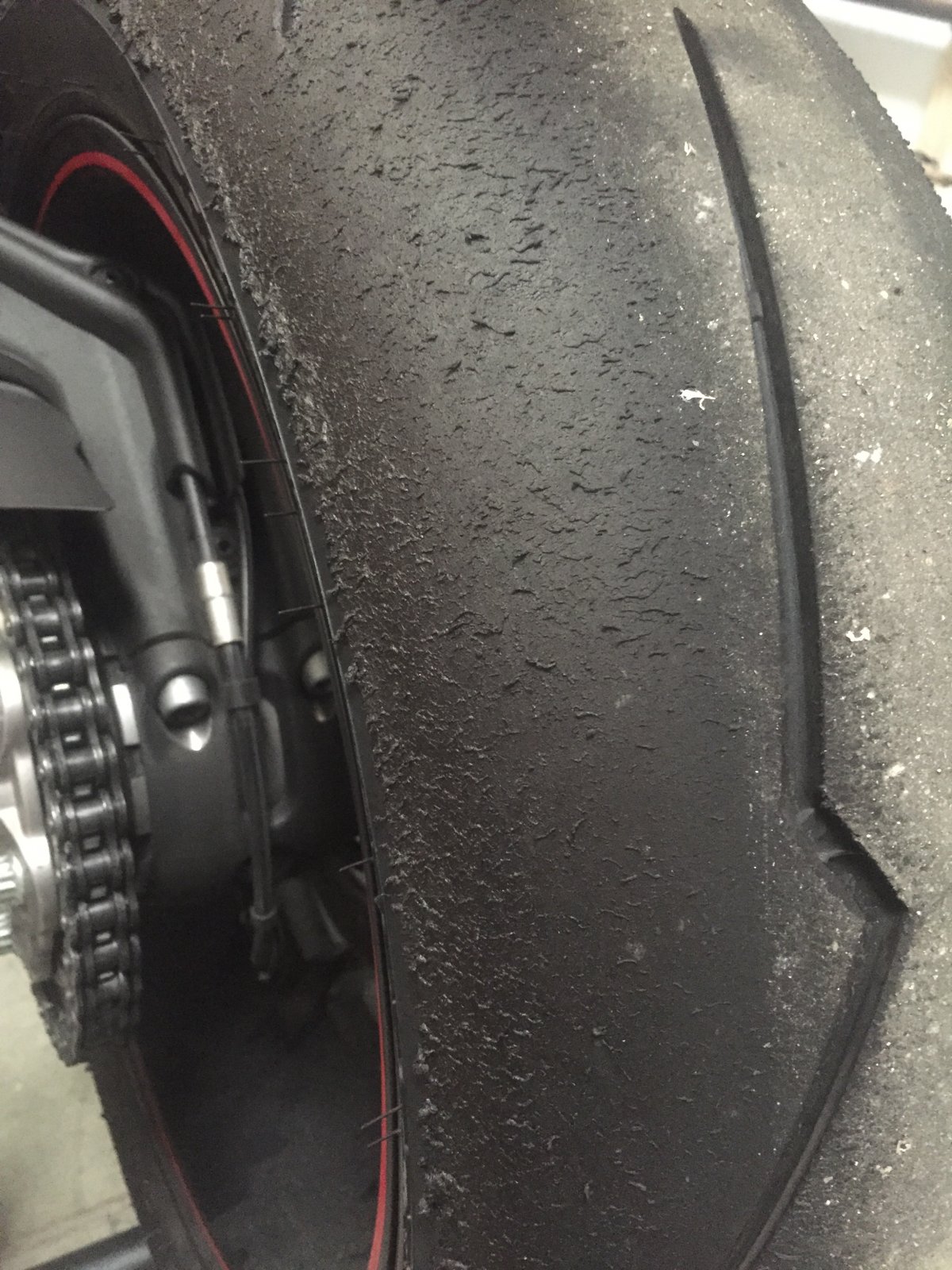

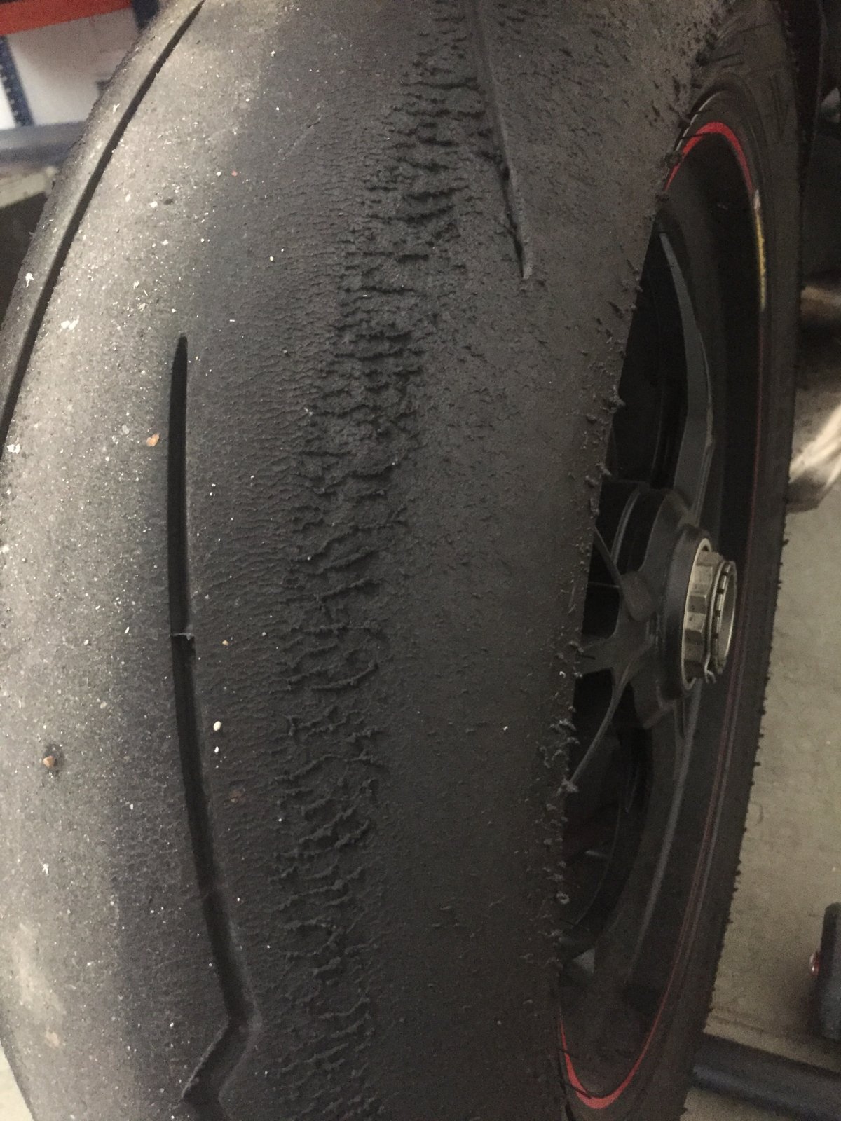

    Matt D tyre wrecker pictures above are cold tear.....the tyre is overheating in a certain contact patch and the rubber boils up and shreds off.........when the tyre cools down the missing rubber that has scrubbed away leaves a crater.....
    as said above suspension settings, tyre pressures setting, lack of tyre warmers...or lack of warming up the tyre mixed with the extra grip of a track tarmac....
  15. Well, I would say profile could be an issue....im not the best rider, far from it, I couldn't interpret what im feeling into and accurate description of what I think should be changed on a bike. Just put new boots on my RSV a month or so back and when I got there (the day before the MotoGP) I was supposed to be having Metzeler M7RR's fitted they were supposed to be fitting 55 profile tyres (as arranged the day before) but only had 50 there on the day so I thought, fuck it ill go with those, better have new tyres for a longish trip rather than the fucked sc's - not a bad move but I find that it doesn't or isn't as willing to go over as the old supercorsa's - so learning from my mistakes - 55 profile next time in whatever I get...
  16. if you are going on a road trip i would stick with the knackered ones as long as they are legal....that cold tear isn't a problem.... you won't be using them to their limit on the road (unless you are a roundabout hero) all you are really going to do is create the centre bit flat and ruin the tyre .....but its ruined already why spoil a new set...subject to the distance you are travelling..;)
    when you next go to a track id get the suspension set to you..(obviously track setting is different to the road where you could stick with the std settings) learn your suspension settings, and concentrate on the tyre pressures too.....if you dont have warmers then leave the bike out in the sun if its warm rather than in a garage.......
