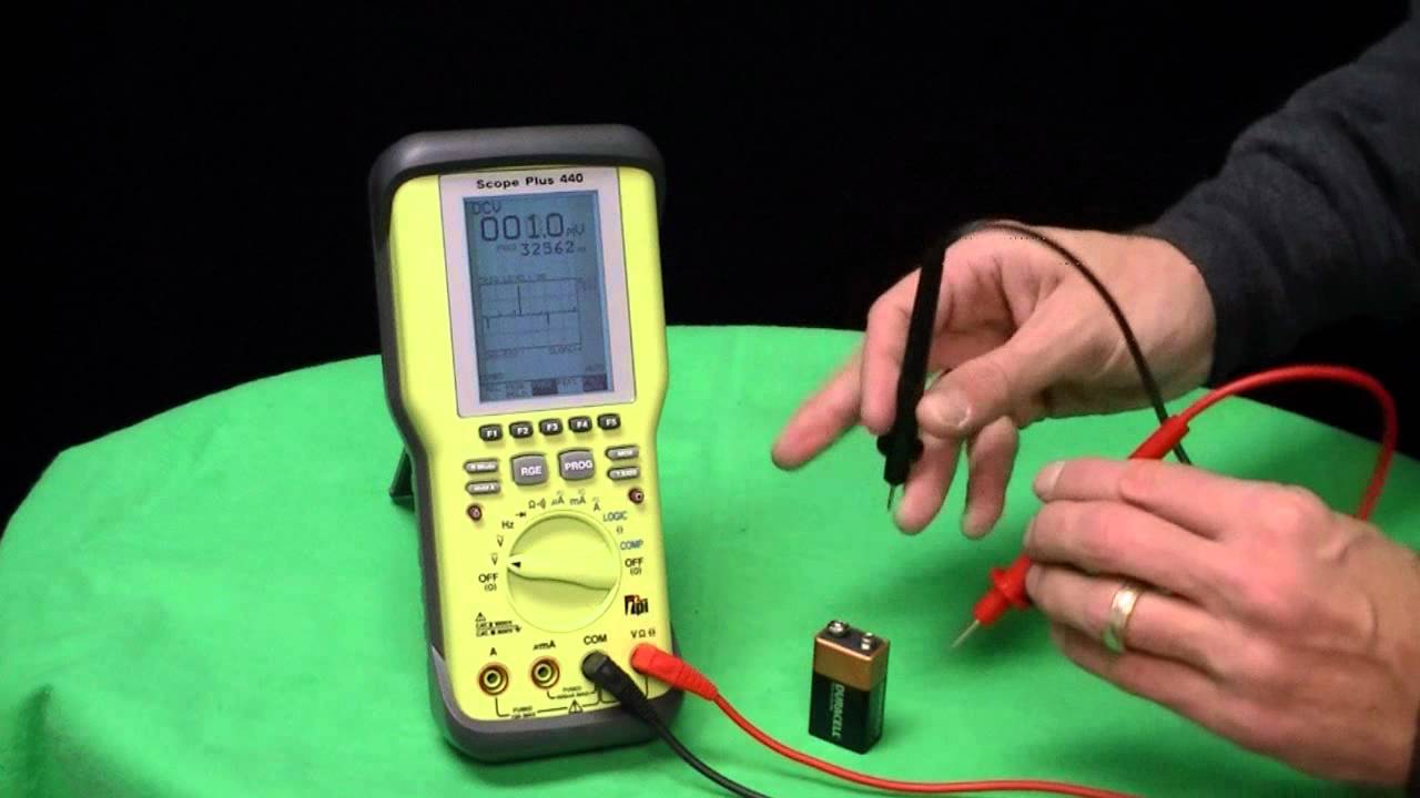

  8. next year everybody should ask for a multi meter for crimbo.
  9. Have one. So next year I, going to ask for someone to show me how to use it :upyeah:
  10. Select Ohms and tell me the resistance across Neutral and Live at your house please.

  11. I was about to say... and how to use one.
    This my latest toy for my work bag....

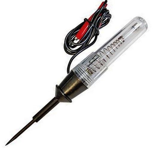

  12. meh, tbh, this is all you need 99% of the time. a test light with voltmeter.

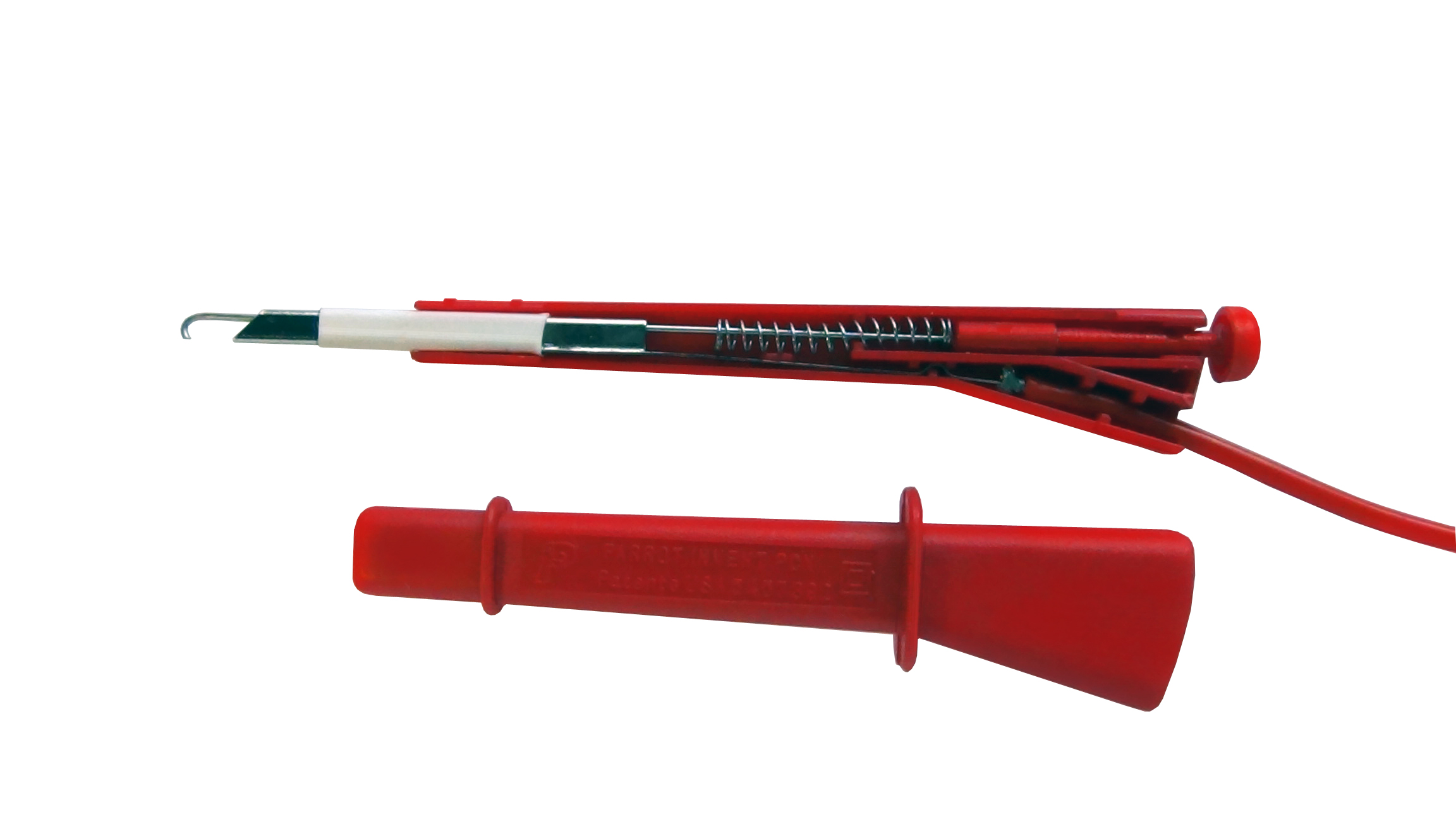

    Buy some needle probes and at least one decent croc clip set.
    Great for pinning into connectors (like Lucas on Ducati).

  15. motor trade yah bozo. 99.% test light in conjunction with a voltmeter 1% ohms meter. cant mind the last time i used an amps clamp.

    Surely all spanners know how to use a 3 channel scope these days?

  19. Yep it was used by spanners back in the days when rainbows were black and white.
    Under £2 on fleabay delivered.
  20. They give false positives and more dangerously false negatives.... be careful.
