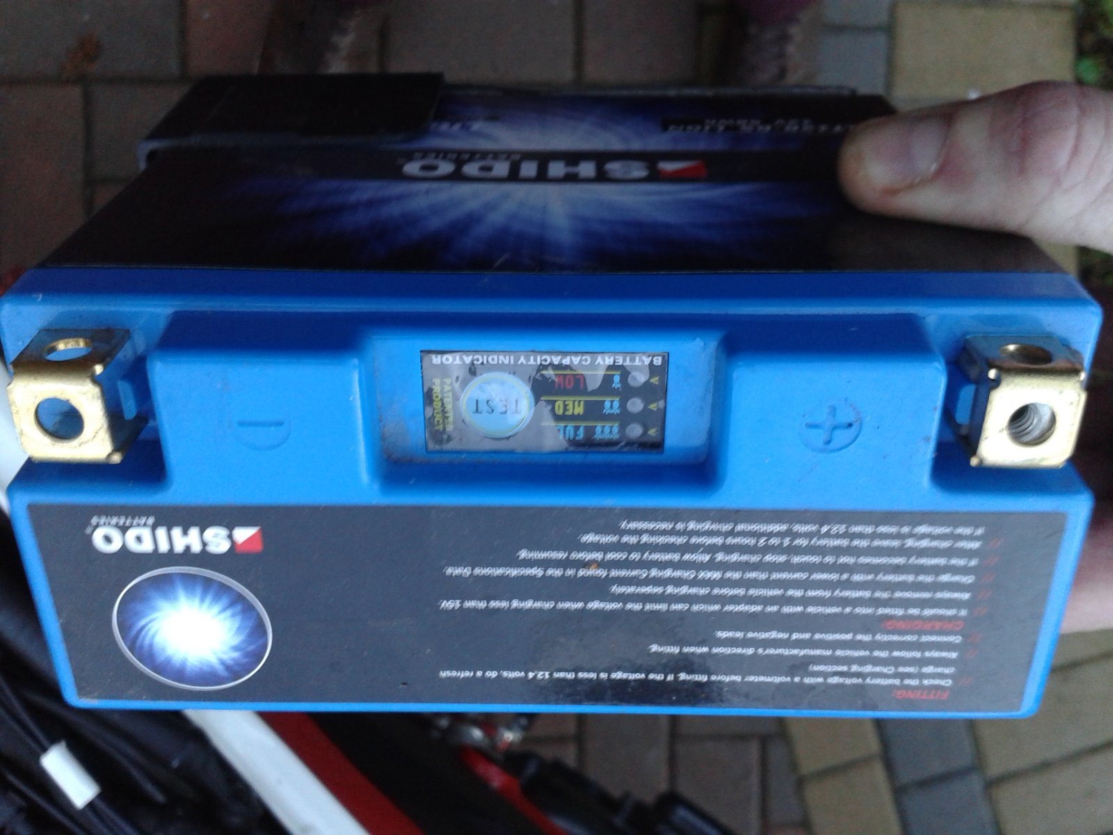

  3. Being a numpty ive being charging the 749 that also has a lithium battery with a non lithium trickle charger for some years (Opitmax IQ https://www.ebay.co.uk/itm/New-Optimax-IQ-Motorbike-Car-12V-Battery-Charger-/350420431601 though it been starting up fine, though reading up its been damaging it overtime i guess... i put it on the lithium battery on multi

  5. First we’ve heard you’re using Lithium. Lithium batteries need to be warmed up with a lighter load prior to starting in cold weather.

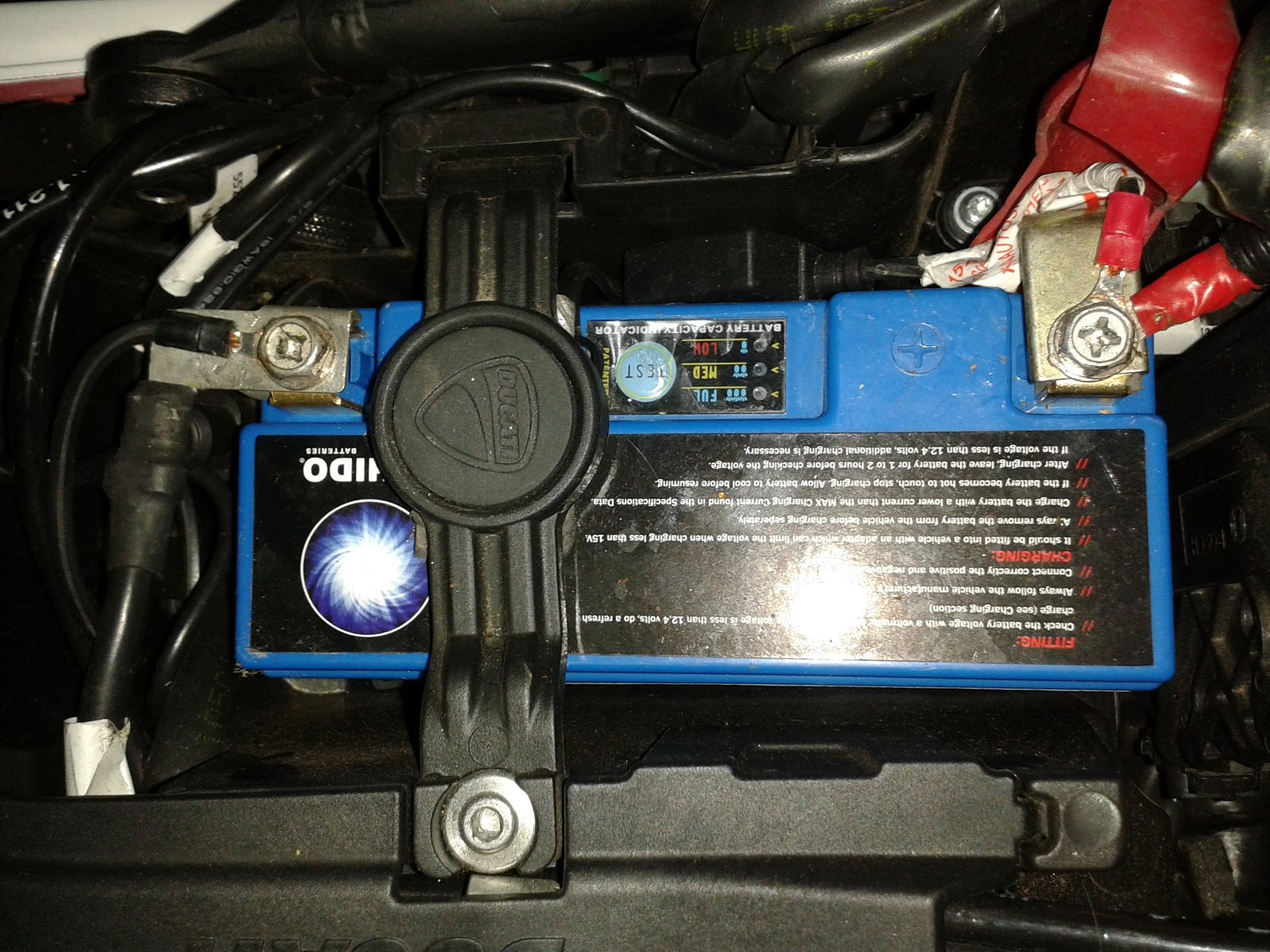

    Cleaned all the terminals, bolts and nuts... Just charging the battery on that charger i mention even its not the correct charger (impatient)

  9. It's not your problem, but it would be worth investing in a set of exact fit starter cables.

  10. You could bring the charged battery in the house to get it nice and warm, then fit and try. Some lithium batteries struggle with the initial starting on Ducati’s ime but once they are warm (normally using a jump starter kit) they are fine for the rest of te day.
