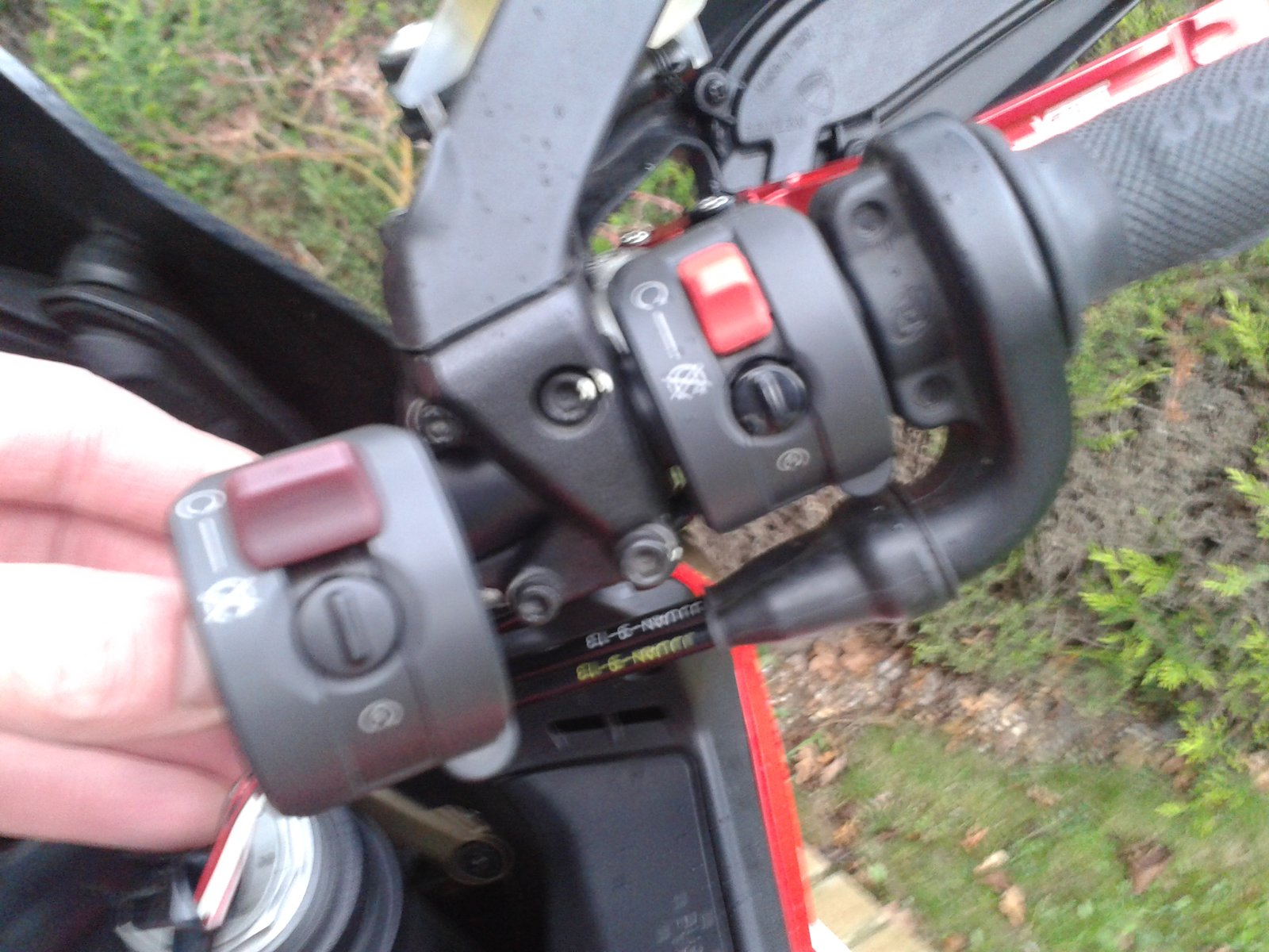

  2. The fault has been found, it was the ignition switch... You could switch on but when the switch was in the upper position it wasn't making contact inside... A new switch is coming from Italy...

  6. Next time have the hair of the dog before taking a picture.... your DT's are really bad today.
  7. Probably cause I have a old phone and am just impatient, no too fussed if its in focus

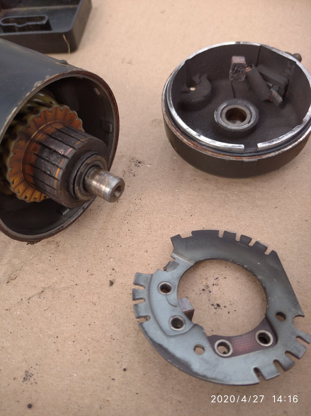

  9. I catch similar problem at my MS1000ds few days ago.

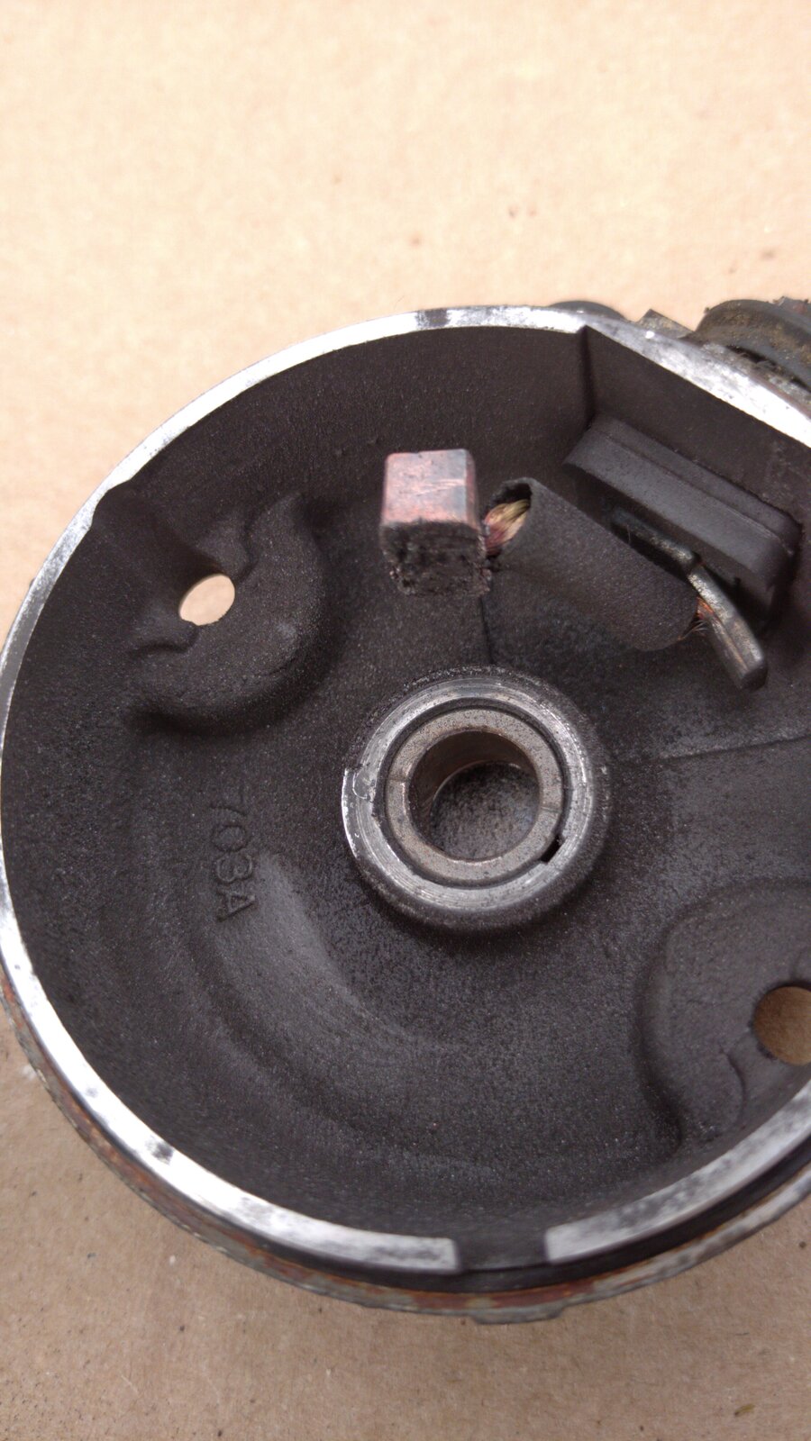

    For first i check battery,after starter. Battery -ok. I checked the starter by directly connecting the positive terminal on the starter and the battery. Starter is dead..

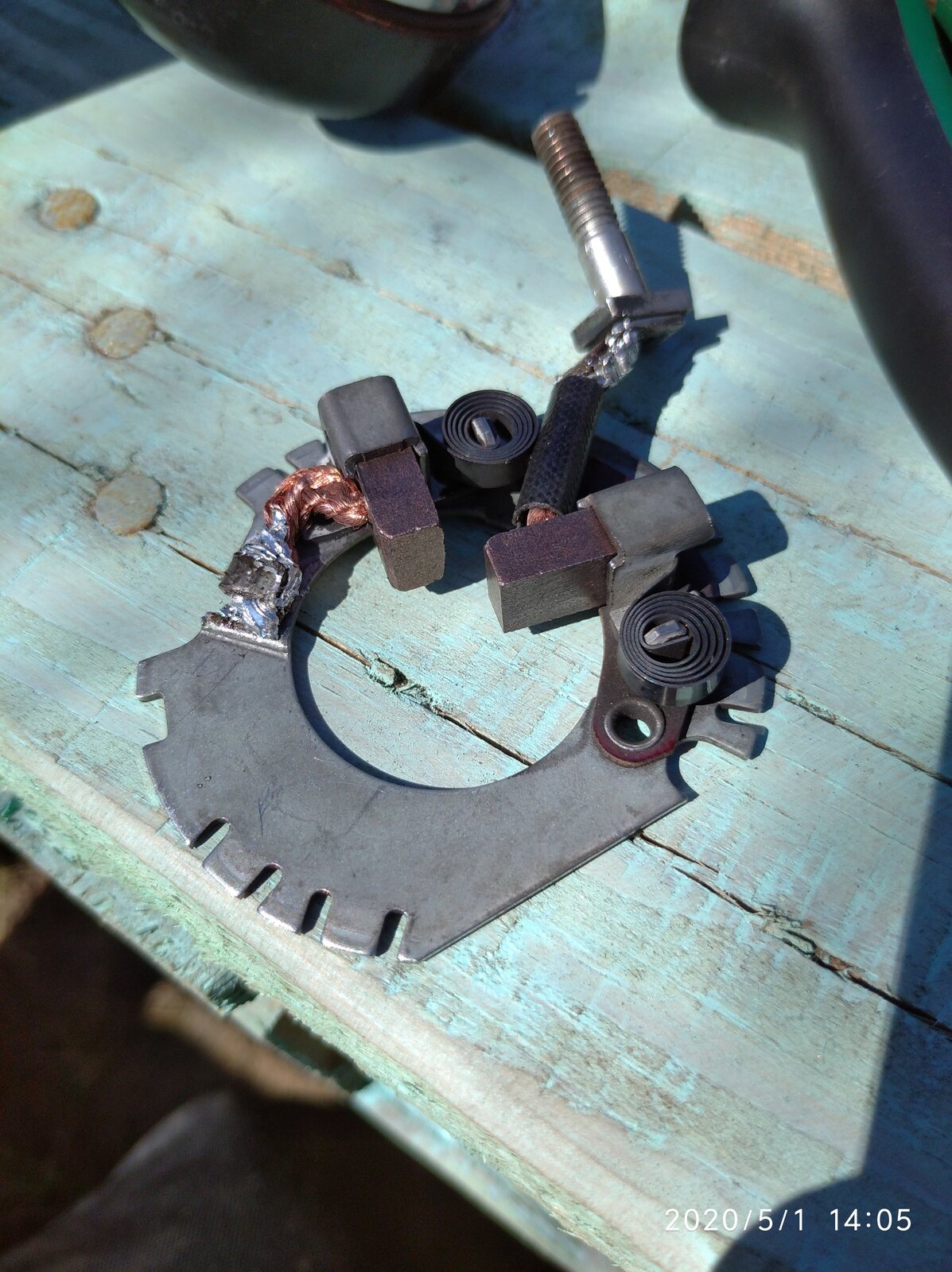

    When I removed and dismantled the starter, I saw that the problem was in the very worn brushes. In addition, they are burnt.
  10. A new starter in Russia costs about 400 EUR. But I found a way out of this situation. In the nearest store, was purchased starter brush kit from Lada 2110. The brushes were a bit larger in size than necessary. I took the file and sharpened the edges a bit. Now I have solved this problem.
