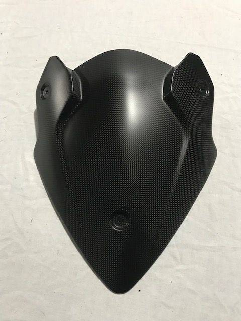

  16. I just did this to my PP with a dremel...removed the top vent portion....it is shorter and I think it looks ok. Have to get some satin clear for the top part that was under the vent where they did not spray it. Cold in the Chicago area now so may be a good summer screen....
