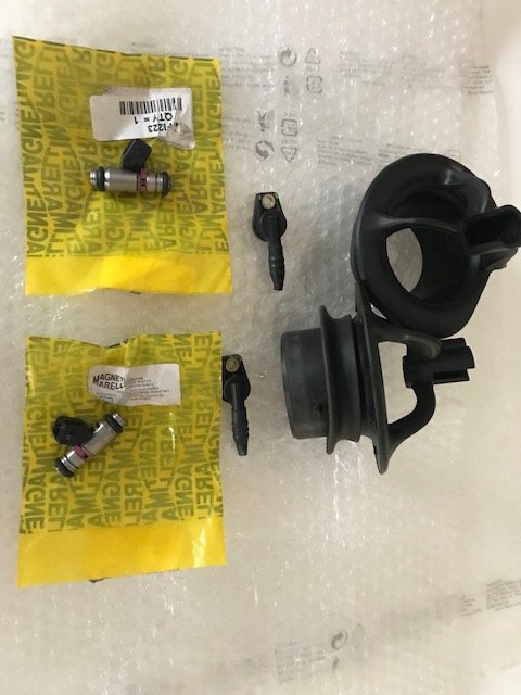

If youre serious about doing it here you go happy christmas 998 injector holders and the all important airbox seals 12 hole pink injectors injector caps pm me an address to send them

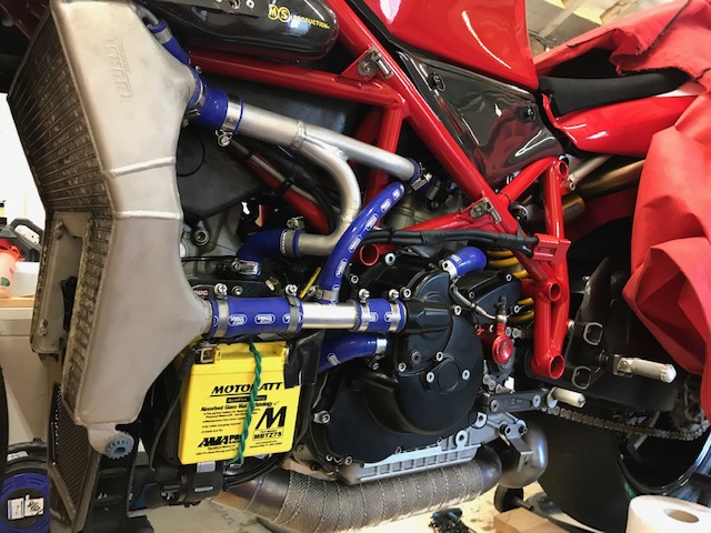

Some more research , might help out other members To use the stock 748 wiring, ECU, and ignition coils. I would get the fueling right with a Power Commander Engine 998 throttle bodies, relocate the ignition coil mounts due to throttle linkage interference notch out the 998 throttle body joining brackets in order to clear the frame cross member (non 748r cross member) OEM 998 headers and with some fiddling will work with 748 exhaust system 998 air box Cooling 999 thermostat housing with the rigid aluminum tubes lower radiator mounting bracket had to be removed because it would not clear the valve cover. low profile 999 fan which mounts using bolts that run through the radiator core rather than the brackets that hang off the back of the radiator. The stock fan hit the bottom front of the 998 air box. Electrics All connectors will fit but -TPS, just resolder with the proper connector, check that you have high resistance with butterflies closed and little resistance at wot, if not swap the cables, its just a simple potentiometer in the end. -Gauge temp sensor (single wire), weld a new bung somewhere in the returning cooling water, important is it needs to be grounded or else it wont work. -Fan switch (Big white), all it does is ground when a certain temp is reached, just mount a manual switch instead.
i normally have the corse wall cover up when i take the fairings off, but for you.. 999RS battery mount and light weight battery 998RS radiator and plumbing 1 of a kind carbon air box mounting 748R frame to 1098R motor with all TB etc enclosed 60mm exhaust dare not even start to tell you about mounting a 10/1198 swing arm
Wow , I bet that makes a nice rumble ; 60mm exhaust lol Stunning! Would live to take it through a tunnel
