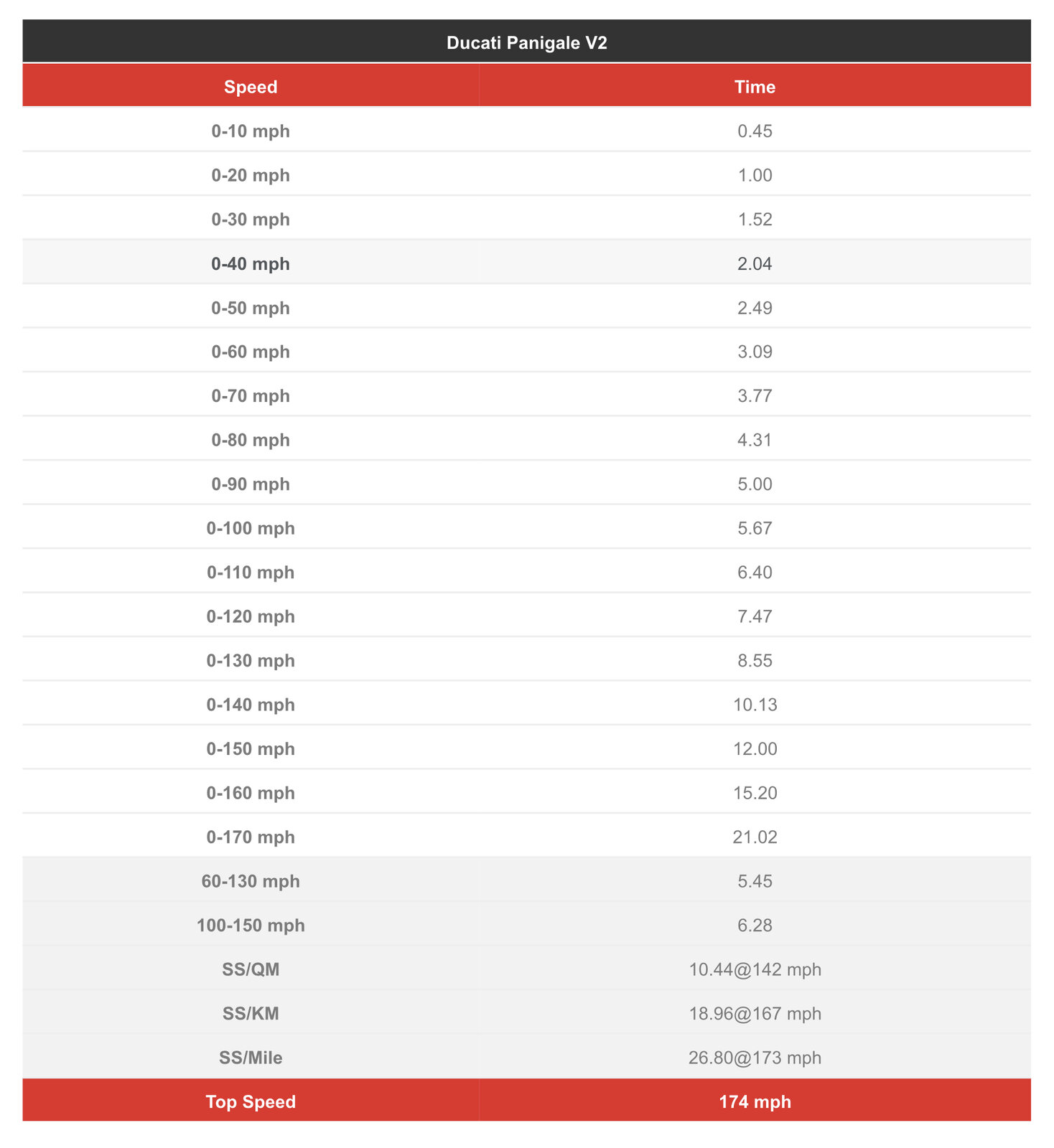

  8. This was the side by side timings for the V4 vs 1299 - nothing in it until right at the very top end.
    It’s not a surprising result as the higher the speed to more horsepower you need to continue to accelerate and overcome the aerodynamic drag. These bikes are obviously geared to accelerate in a very linear fashion up to the point where drag overcomes the horsepower - as the curve only starts to flatten right near maximum speed.
    Figures for V2 are below as well it stays in touch until about 110 and then the gap gets wider. It’s geared slightly lower but even with taller gearing it wouldn’t be able to go much faster as it doesn’t have the hp to overcome the drag.

  20. The larger capacity bikes all have slower claimed 0-60 times than their middleweight counterparts.
    Although in the real world it’s incredibly difficult to reproduce a manufacturers claimed 0-60 time - I’m convinced they have Dani Pedrosa or some other tiny ultra skilled rider perform the test over and over again in different conditions until they get the best time.
    Bikes like the Diavel are quicker to 60 than any sportsbike - it’s kind of an irrelevant figure as a measurement of sportsbike performance - even a V4R is going to be beaten by a Diavel in a 0-60 drag.
    The 899 has a quicker claimed 0-60 than any of the Panigales and it’s fairly easy to see why.
    The single greatest difference is the final drive ratio - horsepower and small weight differences mean very little when the power output of all of these bikes is easily enough to drive 1st gear to 60mph as fast as the ratio allows.
    Gearbox is same for all of the V-Twin Panigales 1st 37/15 / 2nd 30/16 / 3rd 27/18 / 4th 25/20 / 5th 24/22 / 6th 23/24
    Final Drive
    899 15/44
    959/V2 15/43
    1199/1299 15/39
    Tiny difference in tyre circumference.
    200/55-17 180/60-17 Difference
    Circum. inches (mm)
    80.62 (2047.69) 80.12 (2035.12) -0.49 (-12.57) -0.6%
