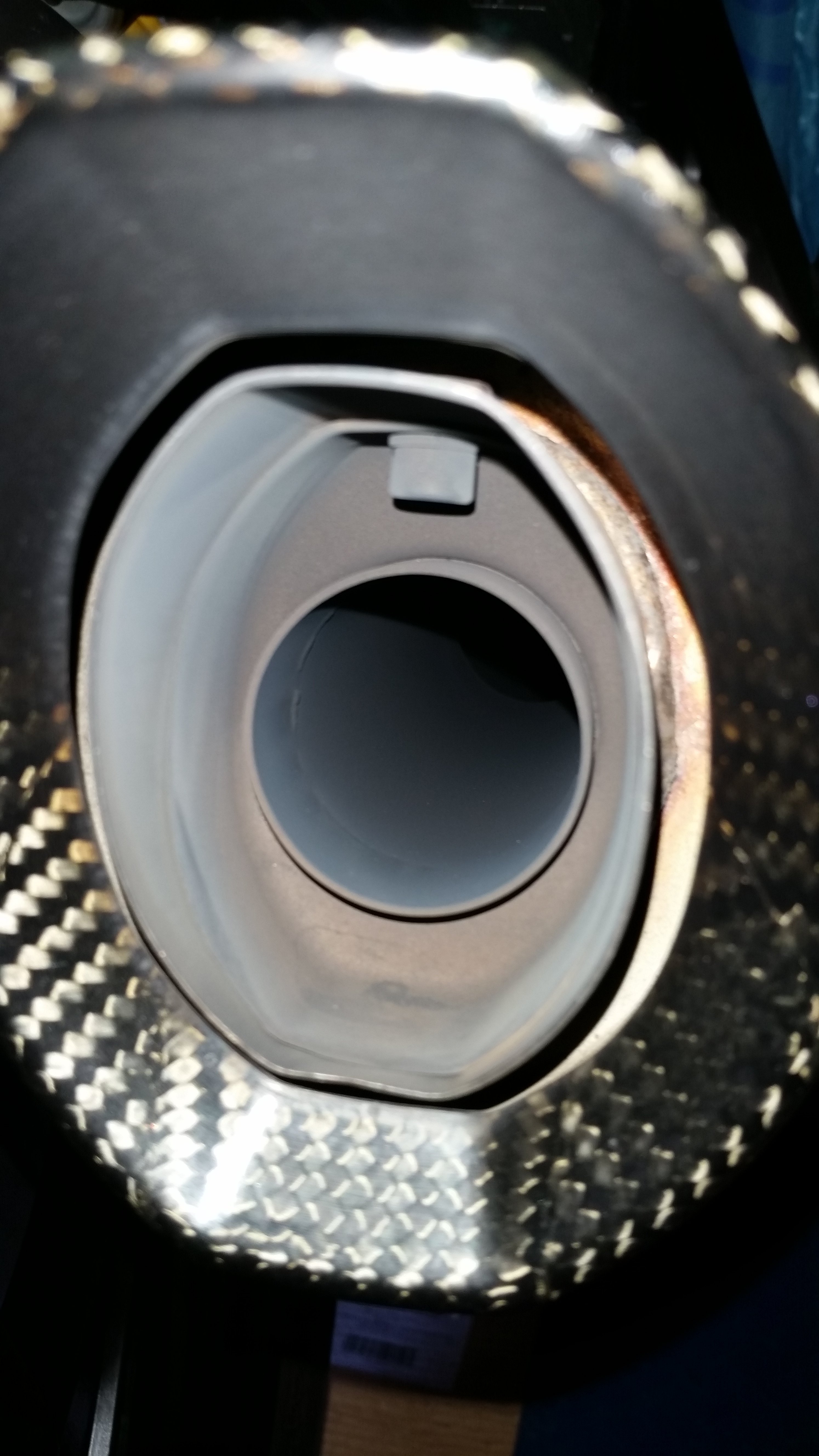

  1. Here's mine installed.
  2. I'm I the only one finding this image erotic?
  3. Defo not got a baffle in then. Will need to check the LV box in the loft when I get back.

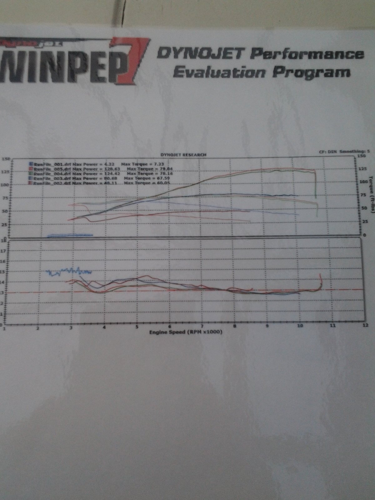

  11. Hi guys feeling abit deflated after seeing your dyno figures, had my 13 gt on the dyno last week only showing 128 bhp and 79.84 torque at back wheel. Decat, mivv ghibli and k n filter. Needs imprving I think.

  13. That's about what most come in at standard, but you need a custom remap with that lot.
  14. That AF is all over the place low down
  15. Probably dangerously (for the engine) lean.
  16. Dyno's are there to get the fuelling right and set up the best curves, woudlnt worry about power
  17. Yeah...get them lines as curvy as you can.
    You don't want them straight, pointing upwards and ending in a high number.

  19. Flatter the better...make 90% at 5k and hold it right across is better than 50% at 5k and a himalayan climb ;)
