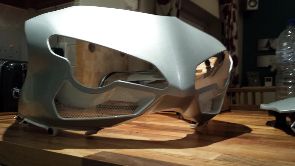

  6. Cheers Anth. Any advice for the air vents on the panels? Im a bit disappointed that the finish isnt better in the bottom corners. I'm thinking I might have to add a section to cover the inner section and up the sides of the sculpting...any better ideas?

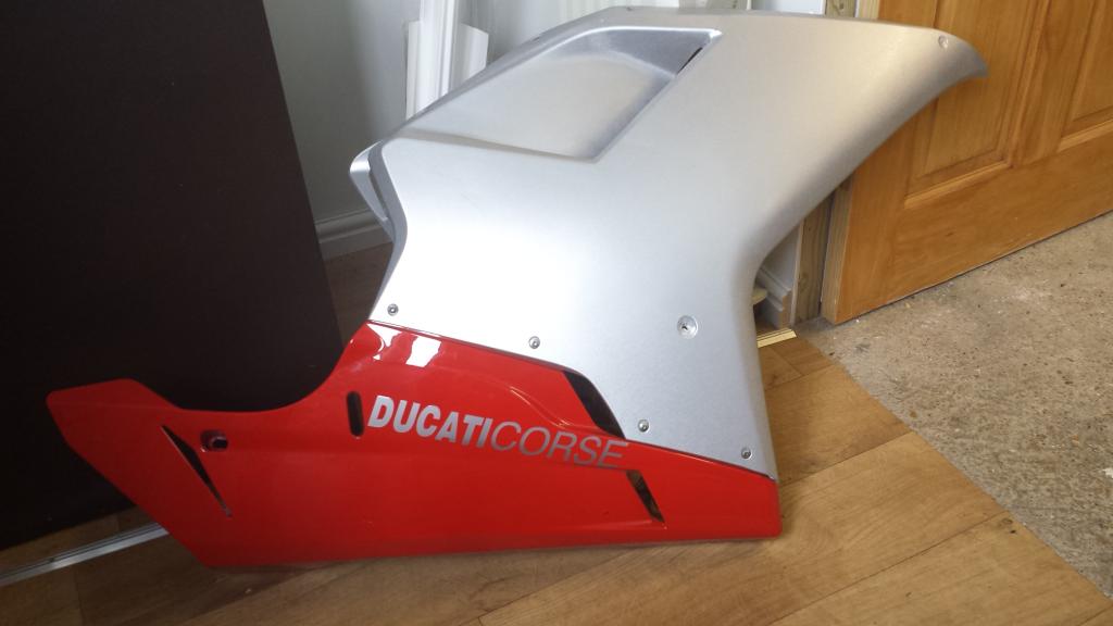

  8. The lower fairings from the replica fairings are red. I was thinking I was going to wrap them in black like the Pani lowers but thoughts I'd try them with the red and see what they looked like. Quite nice but it might get confused with one of those Wilson Craig Hondas!

    Im having a go at the nose fairing tonight with is going to be done in several parts.

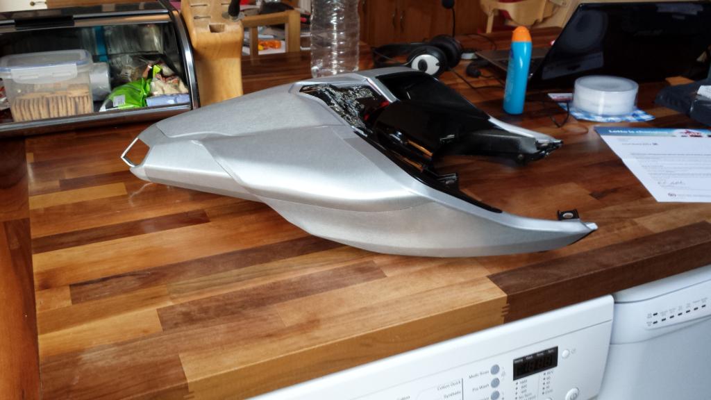

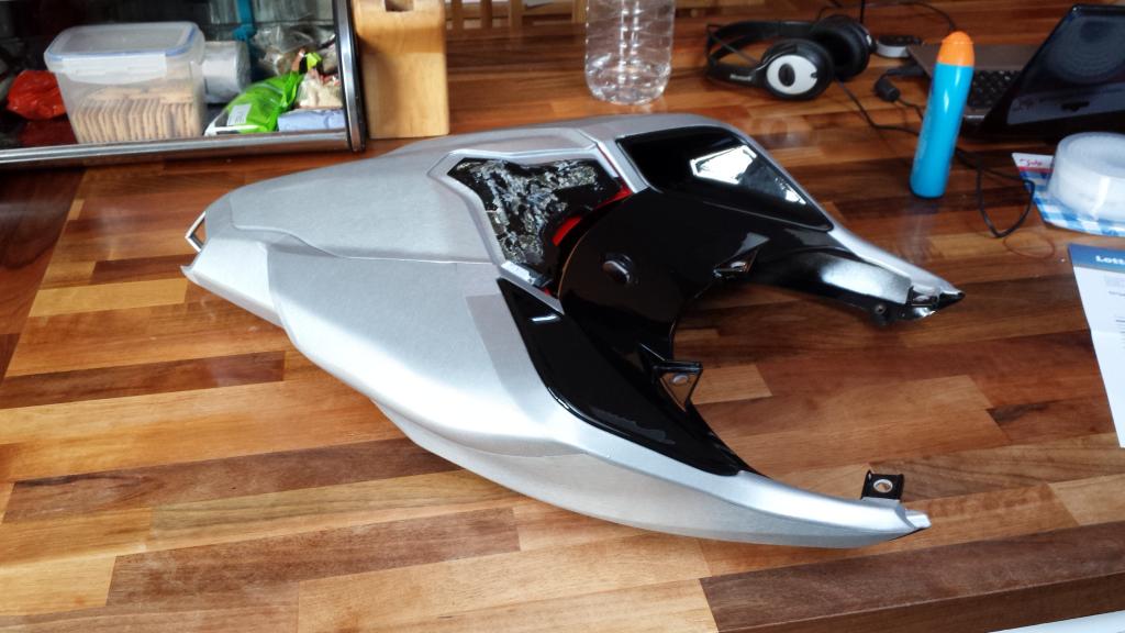

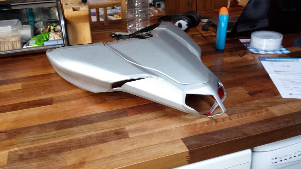

  13. Right.......I did the tail section...and what a swine that was. Its not possible to do it in 1 big sheet (I don't think) so its made up of panels covered then cut to join. I'm happy with the result and like the way that the panels have a different direction 'grain' on them. It looks like they have been brush separately then assembled...probably hard to tell from the pics.
    What do you think?

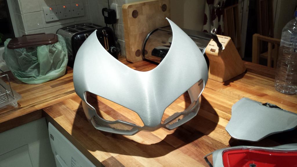

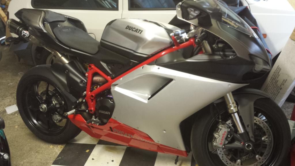

  16. Well the nose turned out to be about the easiest part so far! I'm not sure if it was easier or if I'm just getting better but it's turned out really well. At the moment its acres of silver but it'll tone it down a bit when I get the number boards on the nose and rear. Check out the composting bin in the first pic....just for you Char! :upyeah:

  17. Looking great! You out at weekend?
  18. Looks great! Was the wrap expensive?
  19. This is looking great! Very impressed. Really like the red lowers with the Ducati logo, it looks very... eh... natural(?) Anyway, it looks like it works well and suits the shape of the bike. You're right too - some number boards and maybe a couple of tasteful decals will break up the silver a bit, while leaving the brushed aluminium effect as the base.
    I would love to do something like this with some spare fairings... maybe some time in the future when money settles down a bit.

  20. Cheers chaps. In terms of cost, the wrap I got is good quality stuff and is a bit more expensive as it's a metallic finish and a little textured. It's £42 + Vat a meter and I got 2 meters which is enough as long as you don't make any massive mistakes! On top of that you'll need some cleaning fluid (basically a degreaser) and a few tools like Scalpel, squeegee and hot air paint stripper. I reckon this has cost about £150 in materials.
    Time is a big investment though...... Luckily there's sod all on tele :upyeah:
