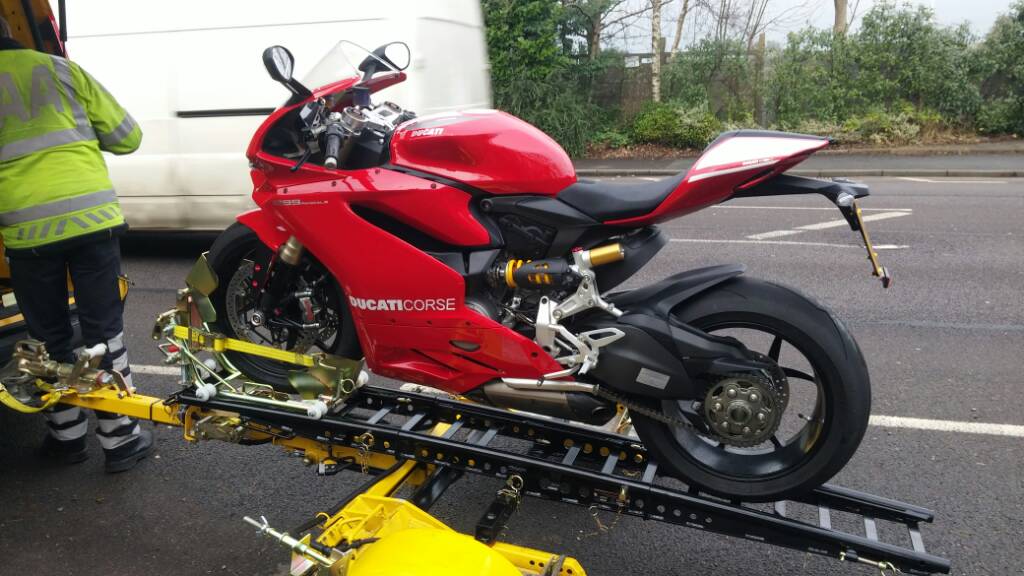

  3. Feel for you mate, you wait for an age for them to turn up only to wait another hour while they build that contraption on the back of their tranny van.
  4. Any news on the stricken 1299 mate ?, not good after only a handful of rides and a couple of downpours :(
  5. The Multi's went through bouts of this too. Can-Line errors can be anything from failed ECU's, Suspension units, Wiring looms or just a bad connector somewhere. Took two dealer visits and slew of new ECU's and a rear shock to sort mine out. Hope yours is something small!
  6. No news yet. Last I heard it wasnt communicating with diagnostic tool. Didn't have time to ring today and I'm away until Friday now. Hopefully hear something by then.
