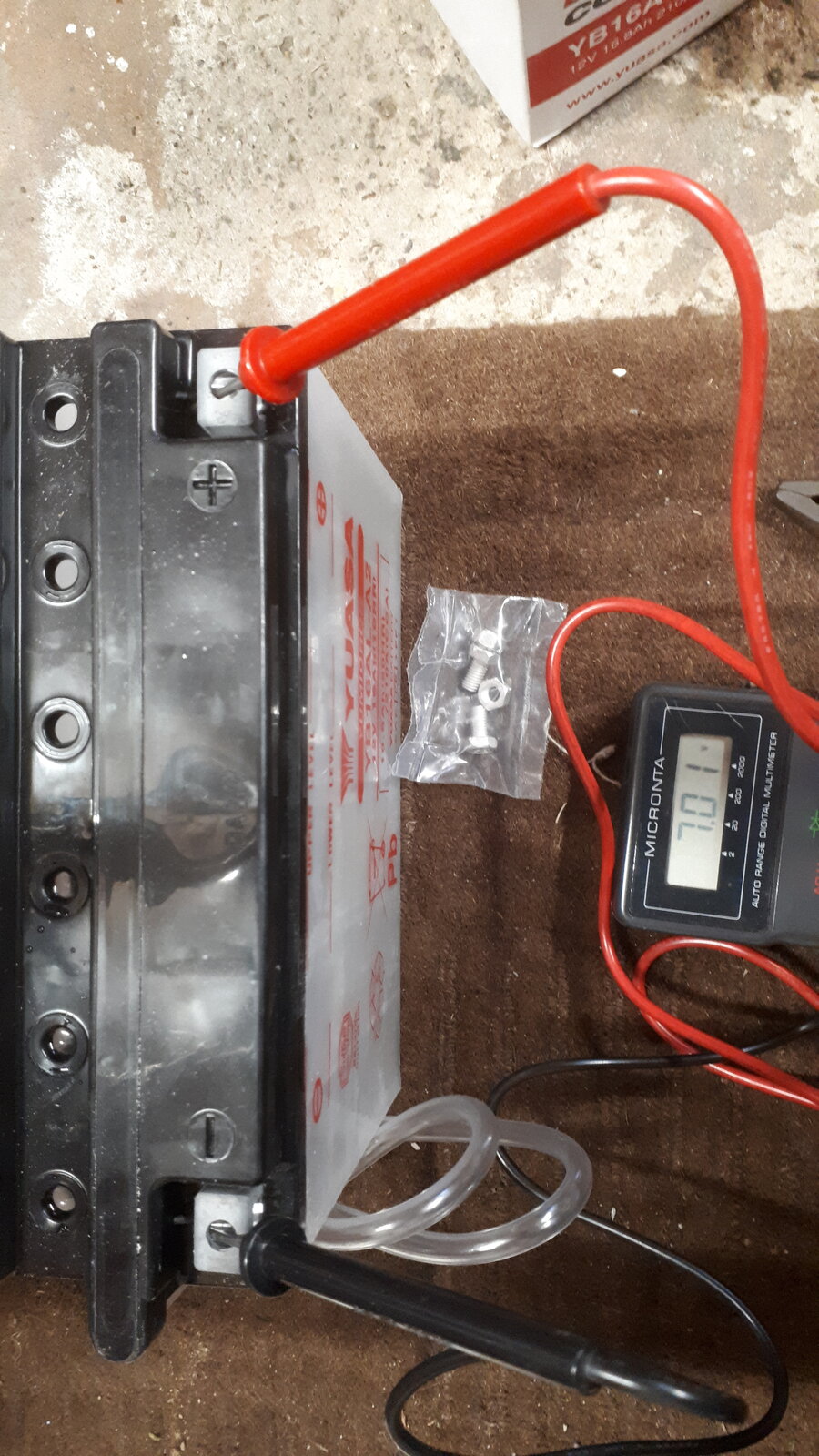

  1. Got a couple of car chargers, will they be too much for it? One is rated 4ah.
  2. Mines a Halfords 6amp and the two batteries have not exploded yet.

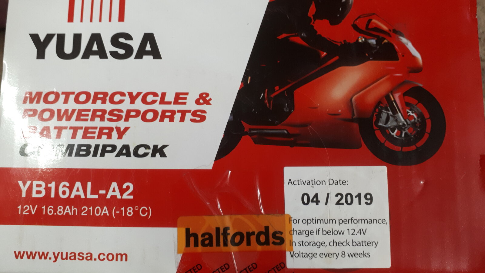

  3. Yuasa website lists a charging current of 1.6A for the YB16AL-A2, and also provides some useful information regarding the 'do's and dont's' for recovering discharged batteries.
    The following is not recommended......
  4. Too late now and where do you buy such a low amperage charger that do the task.
  5. 12.75 this morning. :upyeah:
  6. 12.8 and 12.82 this morning, over 30 hours since last charge.
  7. I bought a CTEK MXS 5.0 some years ago, fully automatic with several options including a small battery setting (with motorcycle icon). Eight charging stages, desulphidation, soft start (0.8A until 12.6V), bulk charge (increasing voltage to 14.4V, 0.8A), absorption (14.4V, declining current), analyse (checks if voltage drops to 12V), float (13.6V, 0.8A), pulse (12.7V-14.4V, 0.8-0.4A). Also a recondition mode (max 15.8V, 1.5A). Also able to charge car batteries at up to 5A, and the one I have works on 12v lead acid batteries (wet, MF, Ca/Ca, AGM and GEL). Just connect to the battery and let it do it’s magic.
    With the connectors supplied, easy to put the bike on charge every couple of weeks over winter to keep the battery in tip top condition.
    Brilliant bit of kit, perhaps you can find one on eBay!
  8. 12.6 this morning after an overnight charge on the low setting of the 4ah car charger.
    Left it off charge until I get home from work and will check it again.
  9. I've eight or nine Optimates aren't they the same thing.:thinkingface:
  10. Quite possibly, but if all else fails RTFM!
  11. Still steady at 12.6v
