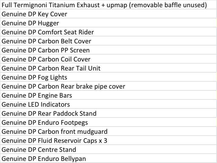

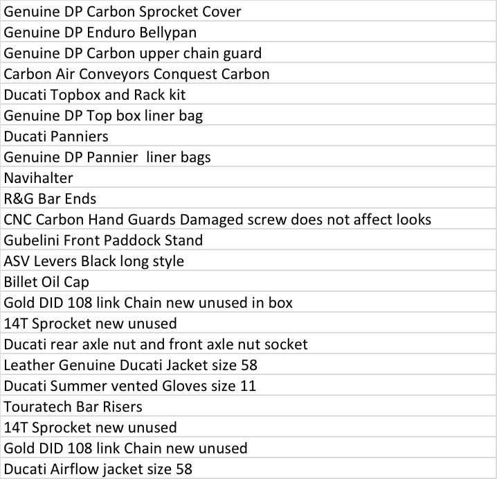

  20. Got the bike back yesterday, didn’t ask what they did as already made my mind up to get rid. Complained to Ducati and had a nice call from a lady in Italy apologising then an email from Ducati UK apologising and offering a free service so used that to offset the one being done this week.
    Stripped everything off it today and just got to clean the bits up before posting. This is the list of goodies, yet to decide on prices.
