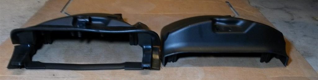

  9. I really like the look of the opening on the 2017 airbox lid. 1486842865797815872317.jpg

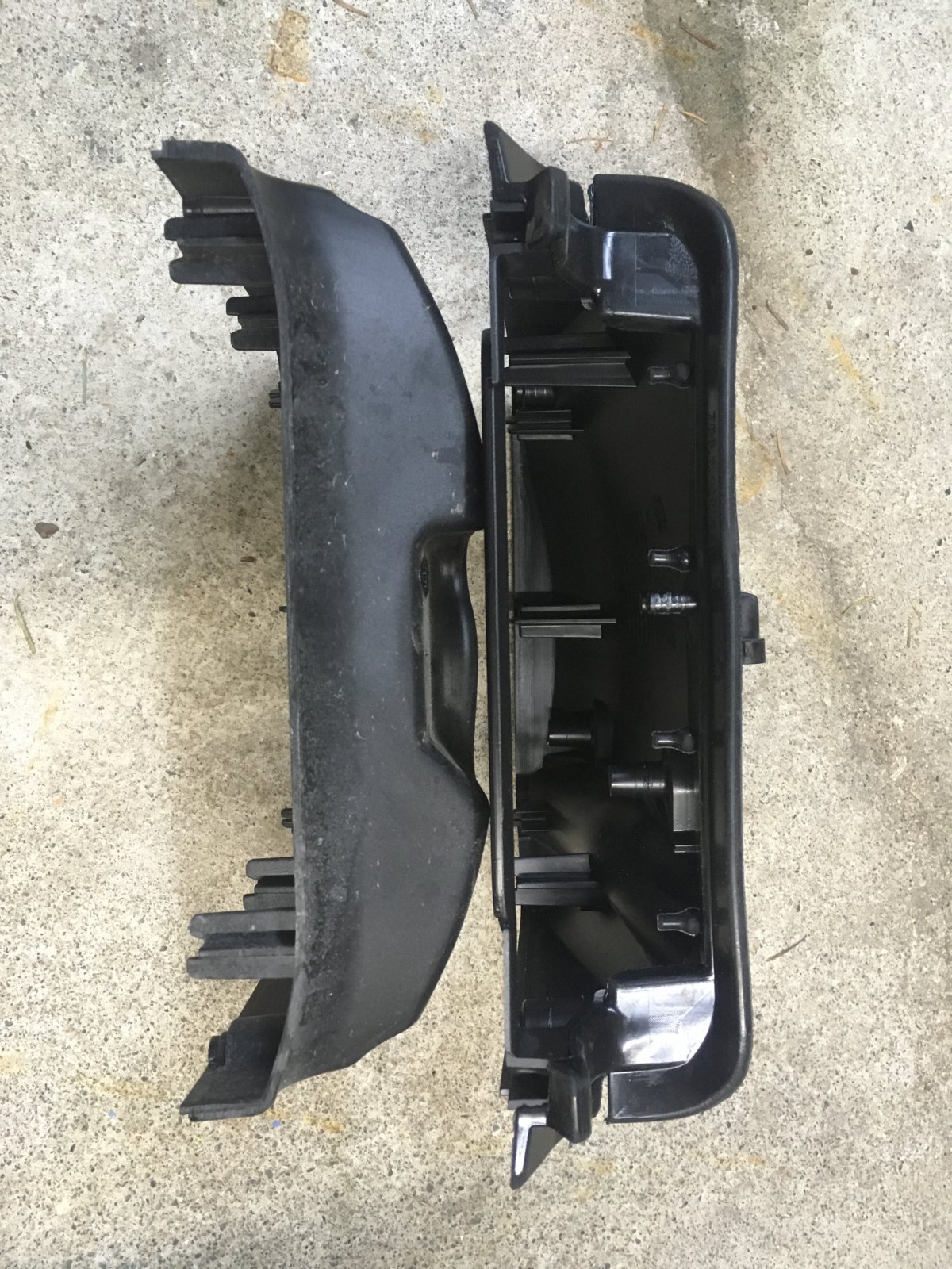

  10. Just got me parts. FYI the lid on the left is the new one. I'll let everyone know how it goes with regards to install.

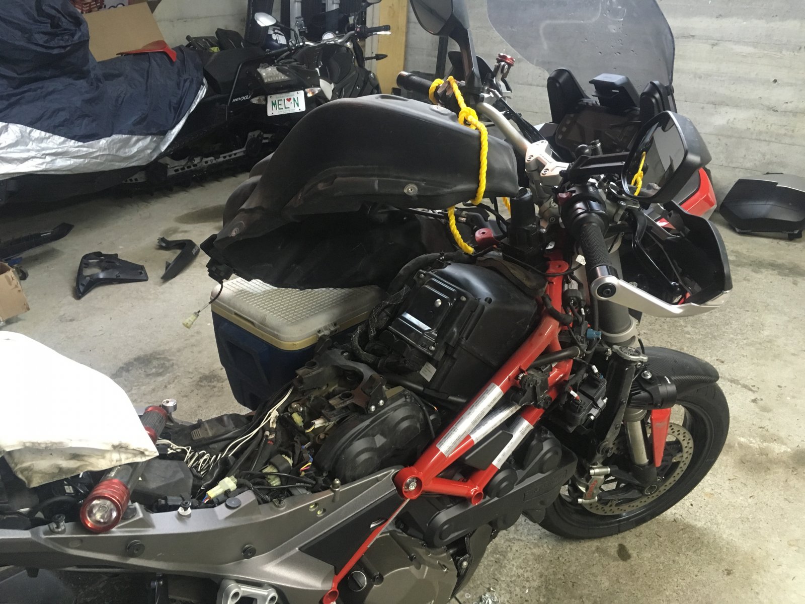

  11. Got the parts fitted last night. Took the bike out for a ride today. The flat spot is gone! Throttle response is a lot more smooth. In 4th gear around 80-90 km/hr (maybe 3000rpm) if you crack it open it accelerates smooth all the way to the powerband.
  12. Be useful to have a step by step guide to deinstall/reinstall :upyeah:

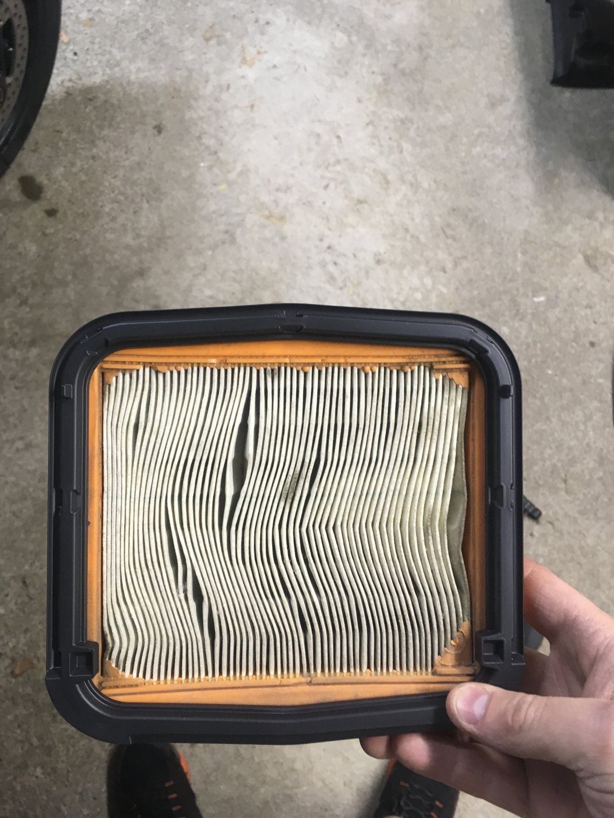

  13. I thought about that... if you can change the air filter you can change the lid haha! Here's a quick and dirty. Remove seat, remove rear side panels, remove front side panels, remove front black side panel bracket things, remove panels with DUCATI lettering on them, remove panel around the "key", remove gas cap, remove gas tank cover, remove gas tank (I undid the wire at the bottom and just moved it over to the side so I didn't have to split the fuel line), remove fabric toque thing, remove airbox lid, move mass airflow sensor(I think that's what it is) from old lid to new one, install rubber onto new lid, install other rubber into hole in front of air box carefully fitting for a tight seal against everything, install spacer onto air filter, install new lid, install everything else in reverse and voila you're done! It seemed overwhelming but in the end it only took 2.5 hours.

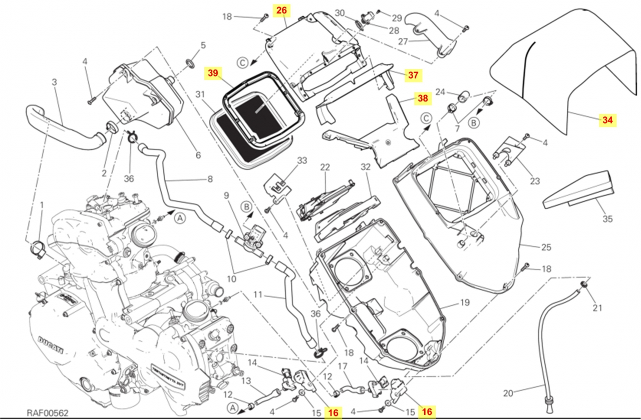

  14. Ducati have just made the Multistrada 1200 2017 parts colleague available on the Maintenance web page. So we are now able to directly compare the air box parts for the 2015, 2016 and 2017 versions. According the parts catalogue there is no difference between the 2015 and 2016 air box parts. There three changes to parts and three new parts for the 2017 air box, highlighted in the diagram below:
    • 16 - are changed rubber mounts for the two MAP sensors [now 8291D521B, was 8291D521A]. ~ £3 each.
    • 34 - a redesign of the airbox sound absorbing cover [now 48610992A, was 48610991A]. ~ £35.
    • 26 - the new upper cover of the air box, with the much larger opening [now 24715541A, was 48610991A]. See the photos of both parts side by side, as posted by @neulee. ~ £33
    • 37 - new part, called at Gasket [78811581A]. ~ £11
    • 38 - new part, called Seal Airbox - Tank [78811592A]. ~ £18
    • 39 - new part, called Spacer [7131B841A]. ~£4
    NB. estimated prices based various European suppliers (no one had all the parts listed) and an GBR/Euro exchange rate of 1.18, with no allowance for P&P.
    The last 4 parts (26, 37, 28 & 39) are those that @Matt23 identified as being required in the first post of the thread. This looks right assuming that the new airbox sound absorbing cover (34) is not too different, especially as it the most expensive part. The 4 parts should cost under £75, so it will be interesting to hear what improvement they make. The change would probably be worth doing at the same time as an air filter clean (every 9,000 miles) or change (every 18,000 miles) as the hardest part will be removing the side fairings and tank. See Workshop manual for more details.
    Out of interest I looked at the parts list for the new Multistrada 950 and it uses the same upper cover of the air box (26), airbox sound absorbing cover (34), gasket (37) & spacer (39). The Seal Airbox - Tank part is a slightly different part number (1200: 78811592A, 950: 78811591B). There are a few other differences to the pipework and more interestingly the air filter has a different part number [1200: 42610491A, 950: 42610341B].
