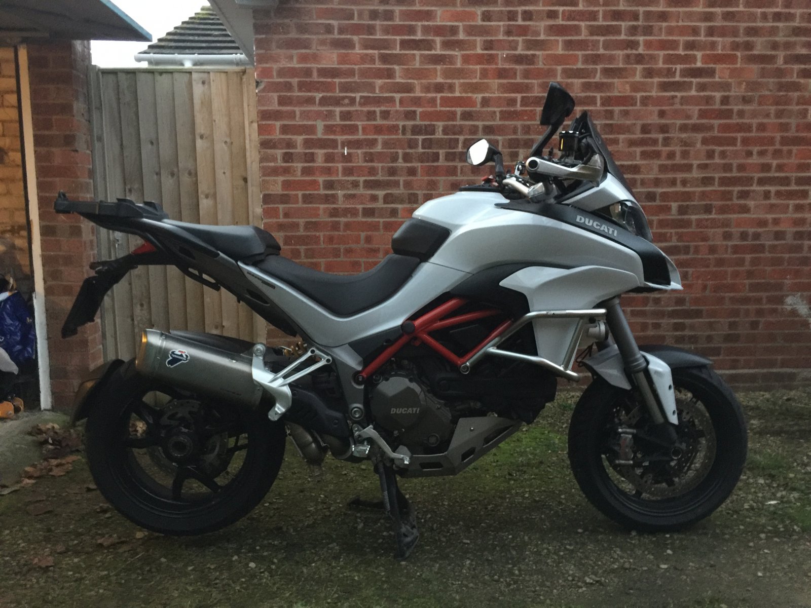

  8. Cheers Tobers but just fitted the Termi, now need to get the dealer to do the magic bit with the UpMap.
  9. You won't be disappointed.

  19. Upmap done n very happy. Bike is minging but the pops n bangs make it worthwhile. +1 for the full Termi :grinning:
