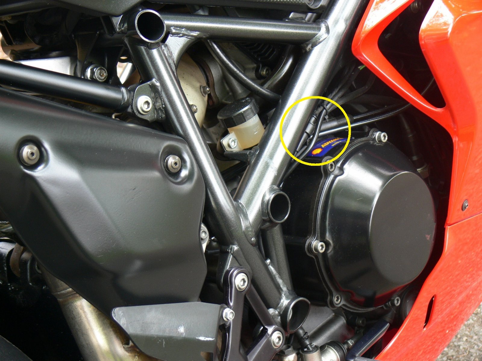

  10. is this (circled) the connection that the speed sensor goes to?
  11. I'm new to ducati but follow the cable and it should go to the speed sensor
